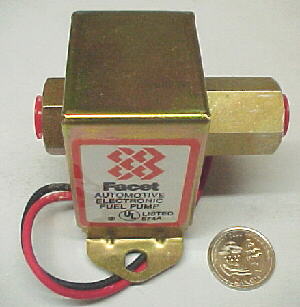

Maybe they never put a fuel pump on your machine. I had that happen with my 1st TM..
The pump will be about the 1.5"x3 inches. hose going in, hose coming out. 2 wires.
It will be on the outside of the tank.

This is what you are looking for.

Get a pump Like I showed you in the pic..
As I recall if the van is fuel injected you need an electric fuel pump.
I had a Kohler 25hp.. The goofy guys installed it without a fuel pump. That lasted about a week.

We bought two for the EZ's almost six years ago at AutoZone, and one for a spare.
One went bad after 3 years, and the other two are still working on the 405's.
AZ may have "chinafied" their lineup since then??
