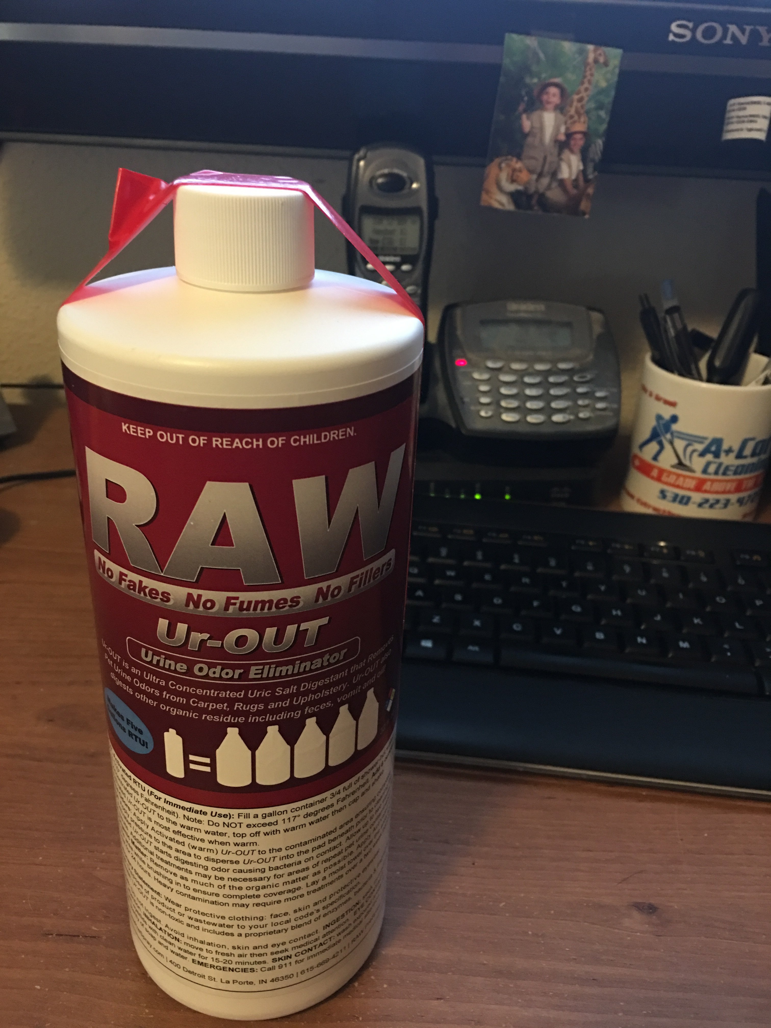

So I’m at this place cleaning now. They called me because the place had already been cleaned twice by another cleaner and the urine odor is still strong. So they called me, the Urine-Ator.
Clicked on the UV light and the place lit up. Today I’m only aremed with my PLyme and one 32oz bottle of RAW. Reading the instructions on the RAW and seeing a bunch of banter about may take up to a week, and second visit may be necessary, I was quickly turned off. So I went for my trusty PLyme. Then it happened.... I ran out!
Not having any other options I grabbed my little bottle of RAW. Holy crap! 6.4 oz per gallon. Incredible. No Way is this going to work!
Sprayed the place down and treated the individual heavy spots then waterclawed. At 6.5oz per gallon the deodorizing was strong. The place smells awesome. So far I’m blown away. I put my face down to the carpet it is smells like a summers eve. Honestly, this stuff is strong. I’ll follow up on a few days and make sure it worked. But so far I’m really surprised. I also like the 20:1 ratio.
Not having any other options I grabbed my little bottle of RAW. Holy crap! .05 oz per gallon. Incredible. No Way is this going to work!
Sprayed the place down and treated the individual heavy spots then waterclawed. At .05oz per gallon the deodorizing was strong. The place smells awesome. So far I’m blown away. I put my face down to the carpet it is smells like a summers eve. Honestly, this stuff is strong. I’ll follow up on a few days and make sure it worked. But so far I’m really surprised.

did it seem like old contamination, or fairly new?
was there strong staining along with the odor?
is this product mainly for the odor or does it claim to get rid of tell tale yeloow as well?
I don’t think it does much for yellowing. But this is dark brown carpet I’m working on. As for the age of the urine. I don’t know. It’s from the last tenant and I have about 80% coverage. So your guess is as good as mine.

Hopefully the product is getting rid of the urine and not just covering with a different stronger odor. I have had from customers who wanted to get rid of the odor of a urine control product that seemed to linger for weeks.
