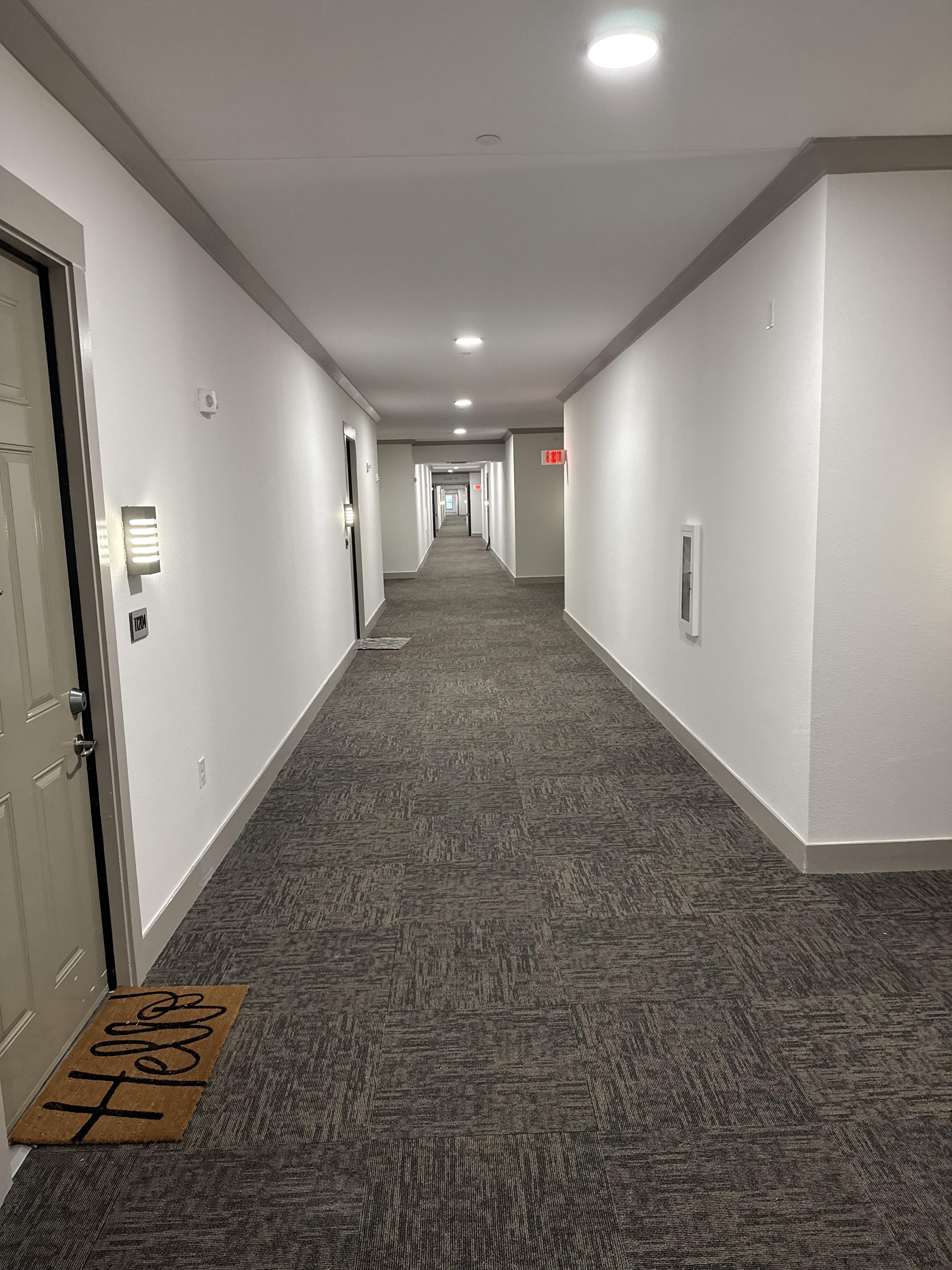

I have a chance to get a few large VLM jobs. Having done HWE on medium sized commercial jobs has worked so far but will not work for this property. Walked one of them today and its not possible to use my truck mount. Ive read pretty good reviews here about the Orbot Vibe and I may be able to pick up a used one locally for decent price. A few questions. Still a good enough machine? How many sq ft per hour should I expect to be able to clean? No offices or stuff to move. Mainly hallways and open rooms. Light to medium soil level. How many pads should I expect to use per 8 hr day? What pad should I be looking at getting? I never expected to go to the dark side, yet here I am. The money would be very hard to pass up on this.

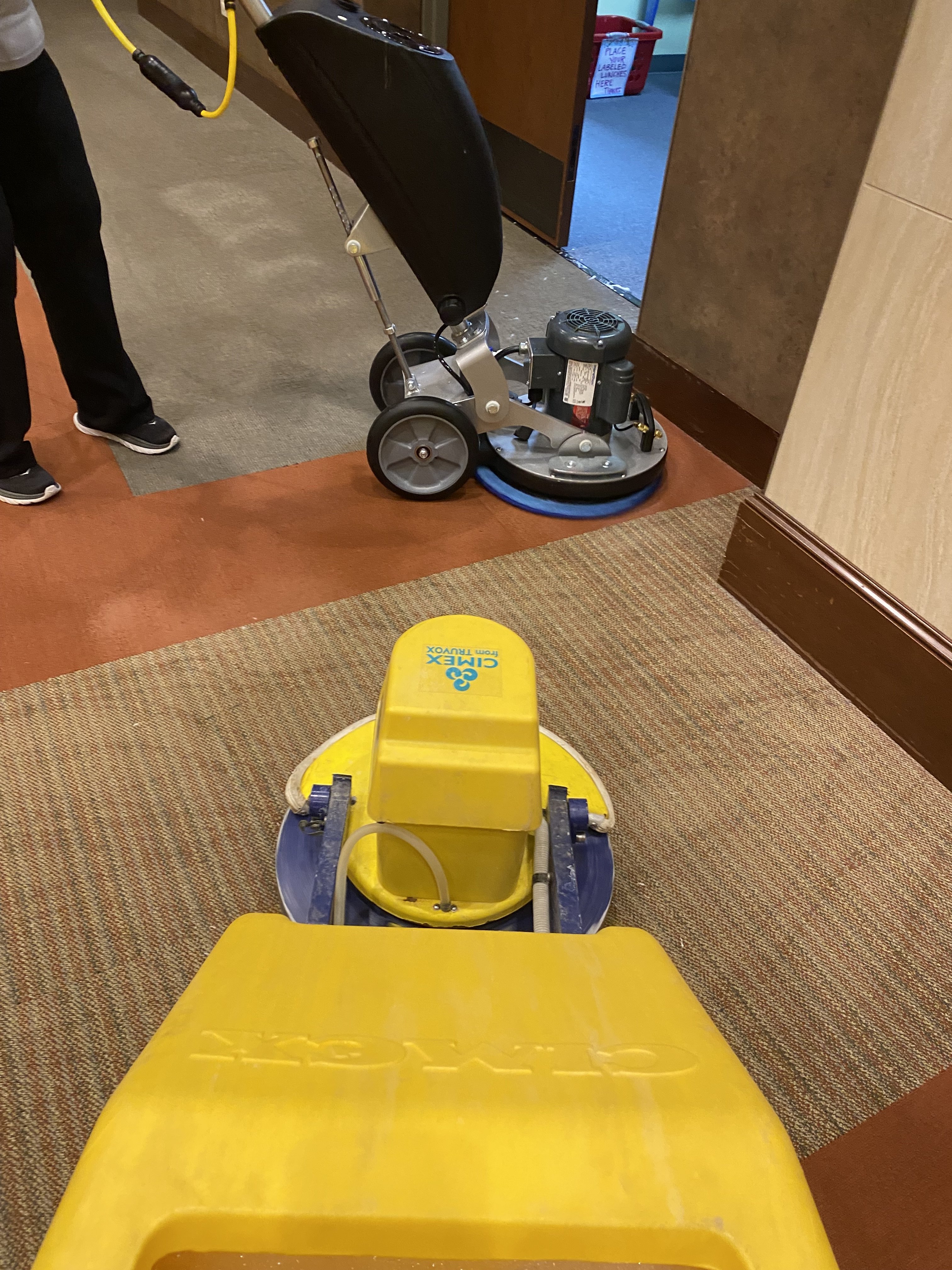

I didn't know you followed Cimex with a Vibe and bonnets
Instead of a Cimex I now have a 20'' Whittaker Trio that I use to scrub first and follow with Phoenix and bonnet. I don't do it that way on every job. Sometimes I will use a fiber pad on Phoenix instead of Trio.
Trio is definitely VERY LOW MOISTURE cleaning. It puts down a fine mist in front of 3 brushes with 75 pounds sitting on top of the 3 brushes. 15-30 minute dry times. It's a excellent scrubber

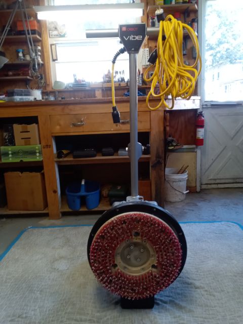

My first OP was a SprayBorg. I bought it when I first started experimenting with VLM 15 years ago and still have it
And I have a Tankless Vibe that I use on big residential so I know Orbot makes a nice OP
I bought that malish driver in 2015 for the SparyBorg. It makes SprayBorg/Vibe much more aggressive and digs deeper on residential carpet. Hated the velcro driver

If it's all in that condition...
You can buy these from me or Rick but Direct Mop Sales is the imposter..
500 sf per side on that floor.
19"

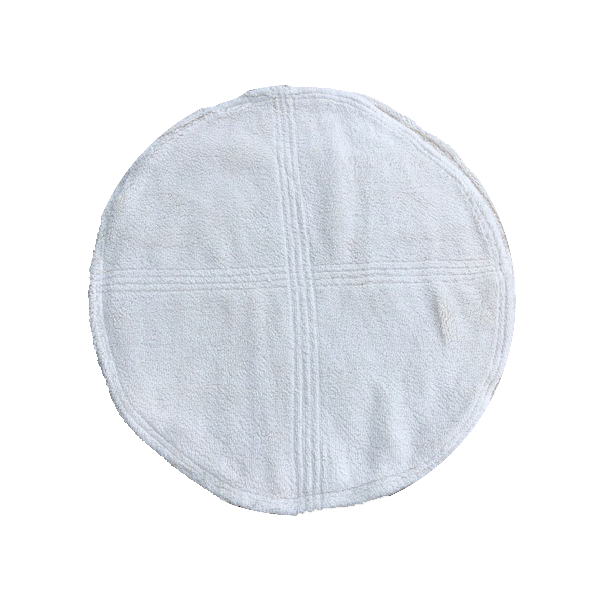

If there are worse areas you'll want to pre scrub it when a brown 3M Fiber Pad, use the microfiber than follow up with a Glad Pad, which is a cotton blend that absorbs that gunk that the MF won't...
Both are here in 21"

I would start with the 19 inch microfiber pads. On light to medium soil, you can get 400-700 sqft. You can use both sides of the pads when new or newish. Once they get too floppy from repeated use and washing, I usually only use 1 side.
