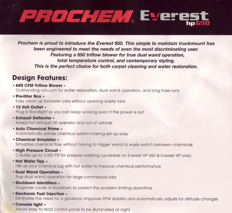

I"ll try and scan them 2moro morning.
It looks alot like the current Everest.
Same footprint size.
68hp, 650 cfm and 1200 psi
Regards Wayne

For a bigger view:
http://i38.photobucket.com/albums/e115/ ... t650-1.jpg

Just one more example of the coming trend.
Bigger.
I'm gonna take a guess, that it's a 5M blower, cause if it's a 5L the marketing dept would have called it the Everest 805.
You gotta love people who won't actually put a cfm gage on a unit before making claims.
Am I seeing that tiny filter box correctly, is that all there is, 2 lil' 2" ports?
Already behind the curve, at least two other Mfgs. are coming out with 2.5" right off the machine.
I'm glad Vince is a guinea pig, so I can ask him 20 questions.

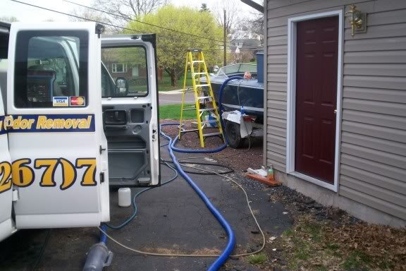

I grew up with the old 800As. We put near 10,000 hrs on them. The engines were still fine. I have 4500 on my 405, and have only had to replace the ignition switch, bypass valve and float valve bullets. Yeah I would prefer an American engine, but the Nissans really hold up. I will be buying this new machine, as I dual wand (dual RX20) alot. I wish the filter box where bigger too. I have access to an old WM pro 2000 box, maybe switch em out! Thanks for posting the pics.
BTW, these things are great for cleaning out old boats!

Ya know if that machine is going to be made in both blower options, but all else is the same, kinda makes you wonder, who would opt for a blower downgrade?
Here is another post i made on this subject:
"I thought that new Prochem 650 had a #5 blower, but didn't look like a #5 to me, so what gives?
And where do they get 650 from, surely not CFM?
If you are gonna run with the Big Dogs, you had better belly up to the bar.
Any Prochem gawds care to enlighten us?"
I am understanding that this new TL650 blower is a #5 class blower, with a 5" gear set, (might as well be, that is a big motor) but I could have sworn that machine had a 3" port on it, making it a #4 class.
So what gives, anyone have any specs on it?
And assuming it is capable of 650 cfm, what speed is Prochem running it at, ie 80% (520 cfm)?
And what lift is it rated at?
