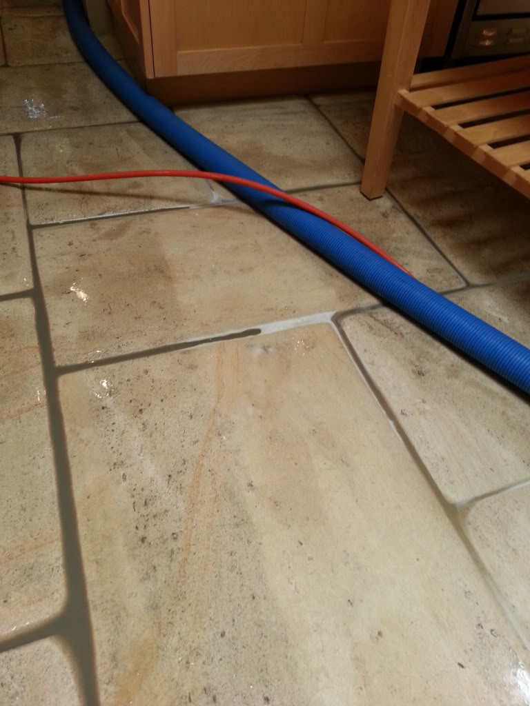

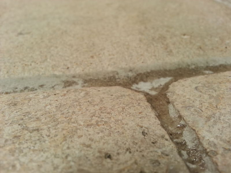

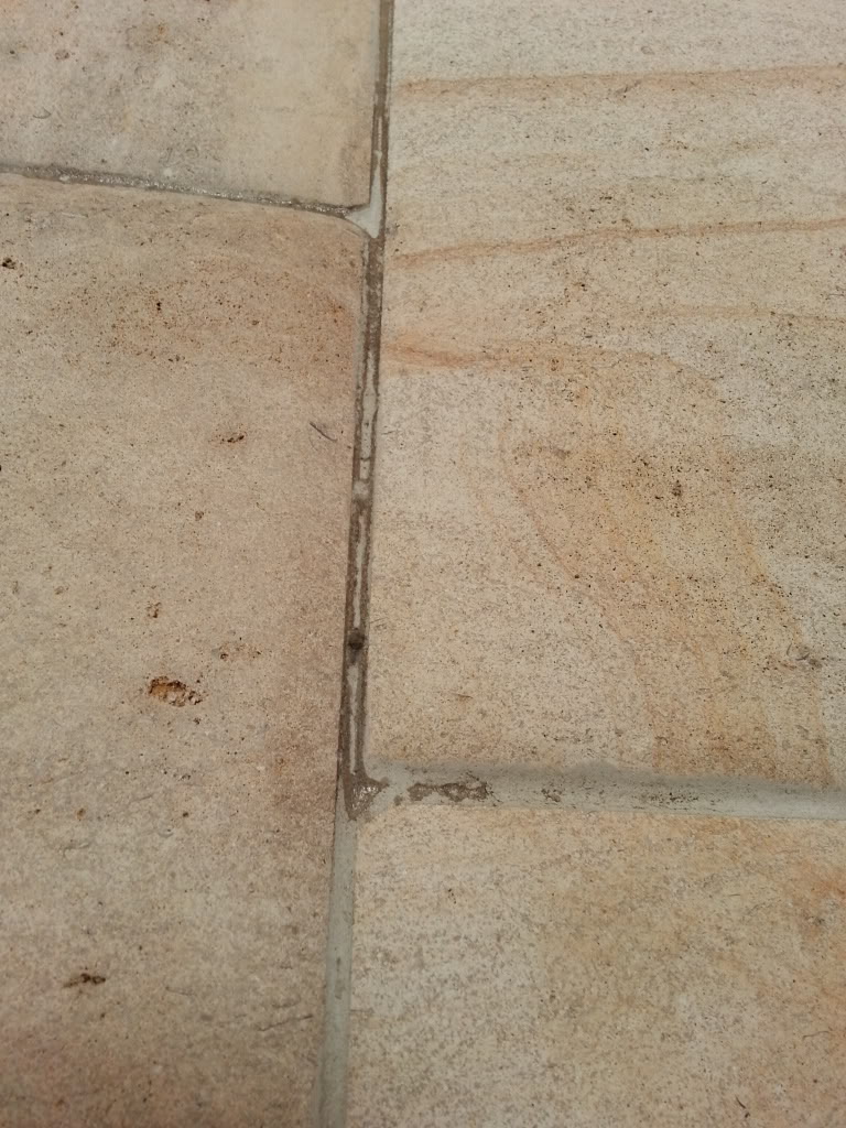

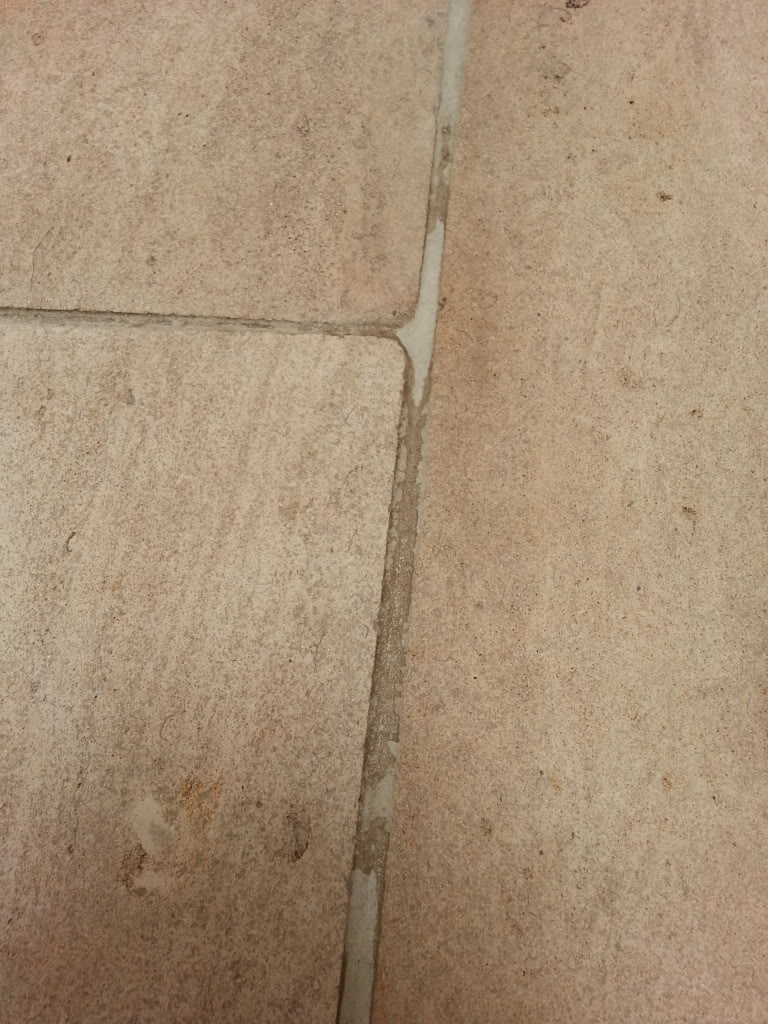

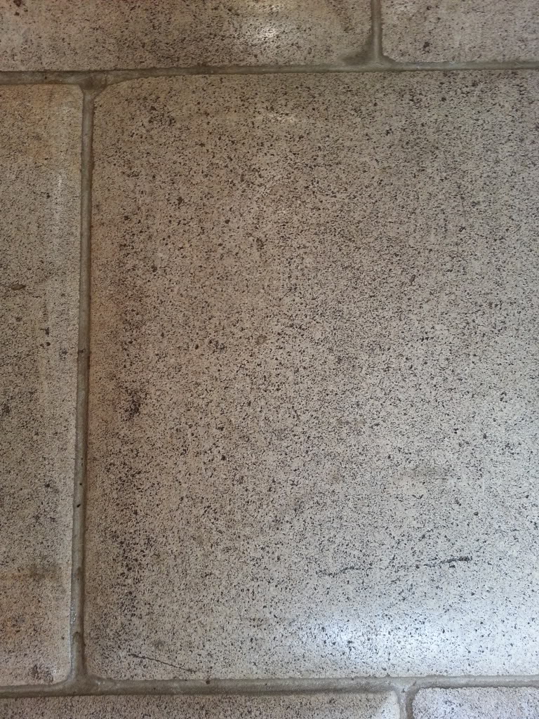

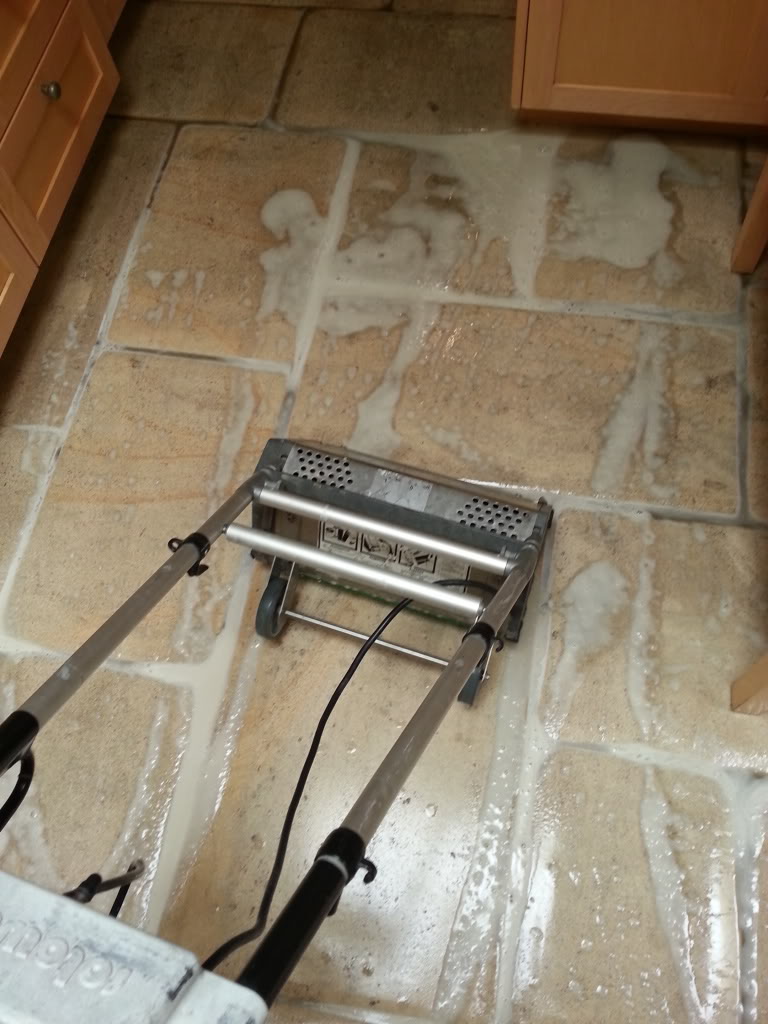

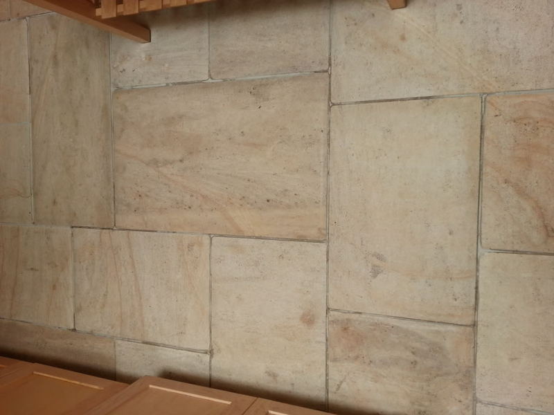

porous/pitted Limestone...
Like living on stale wonder bread.
half cleaned..
Homeowner has done everything wrong with the floor.
-Uses a Shark Steamer
-String mops
-Applied a topical coating three times over 9 years without proper cleaning.
and never mopped up the excess topical in the grout line after they made mud with it...
http://youtu.be/noBN531F7Q0
Only scraping/grinding or a gel based coating stripper is going to get it off..
