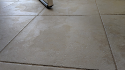

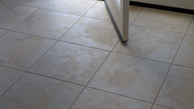

My fellow hard surface gurus and I are getting more and more calls from cleaners who are experiencing all sorts of strange issues while cleaning modern porcelain tile.
Odd streaks or splotchieness or water marking showing up when dried
Etching from acids
SCRATCHING...

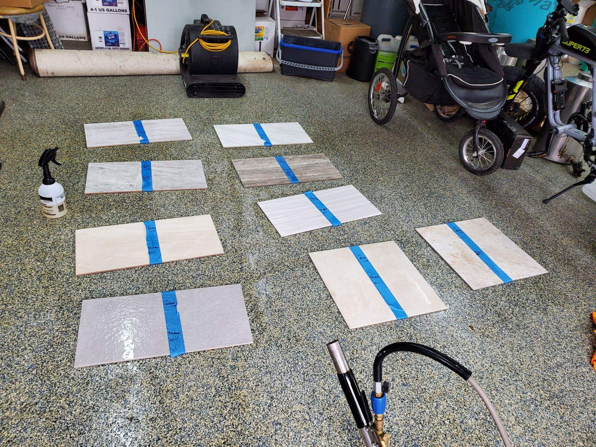

Mark Saiger did some recent testing on a selection of tiles from Home Depot and came up with some great observations:
DONT LET YOUR HIGH PH CLEANER DRY ON THE TILE BEFORE YOU RINSE IT
Test your acids, if you have to use them on the grout.
Run an acid rinse (pH 4-4.5) at all times
Some tiles appear to have coatings on them that are not mush more than a layer of VCT wax.
Factory applied slip resistant coatings/treatments are the culprit.
Teflon wand Glides can indeed scratch Porcelain.
Stay under 10pH if possible.
Hers is what a dried high pH pre-spray can cause, which buffing with an acid cleaner fixed. (recleaning would not...)

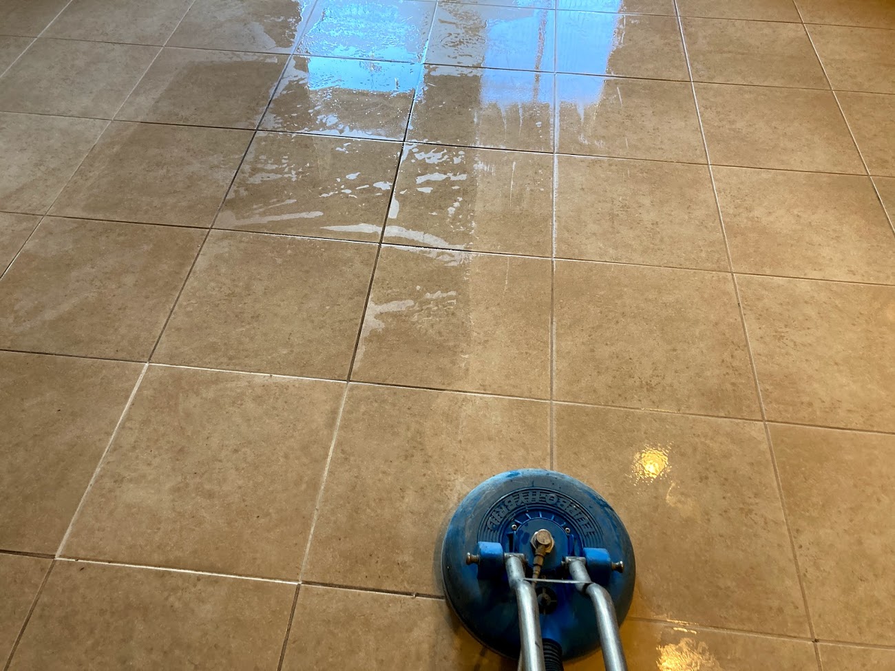

All man-made tiles are not the same. Some tiles have different coatings and sheens. Other man-made tiles have naturally raised and lower impressions that grab grease and grime. I find your chemical is important and possibly could be a problem with some materials. The proper inspection helps prior to beginning your job! Starting with alkaline should be the norm. The other equation I run into most is what pre-existing chemicals are used? Fact-finding may help you discover alkaline chemicals ain't gonna do crap on people who use daily filming and coating products like "Swiffer"... I also think that I see a lot of folks "misting chemicals" versus "spraying chemicals" I recommend a damper floor to prevent drying...I can cover approx. 1000 SF at a time...The dwell time of the chemical raises your dirt and grime to the top...I use a "Teflon ring" under my turbo for the last 20 years...I can't remember the last time I scratched porcelain tile. I also would say not all tile and grout cleaning jobs need anywhere the required solution as labeled on products! More than 50% of my jobs could be "hot steamed" cleaned with a very little chemical added to your pre-spray...Especially if you're a turbo hybrid user...Watch your overall amount of chemicals you add as hazing or residue buildup could occur.
116,393
Agreed, especially common on your repeat "maintenance" clients... AND the same goes with the amount of PSI pressure needed to cleaned maintained floors.
Too any Hard Surface Professionals rely on insanely high pressure to get grout cleaned rather then letting dwell time and some manual or mechanical agitation to get the job done.
That's where the GreenBrushGlide comes in, which is designed to (quickly) work at a nice safe 400psi on just about any hard floor.
