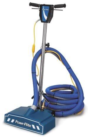

The problem with your suggestion is the design...It has a "sand trap"..that leaks air..
I guess you could "disable" the Vac. motor ...BUT WHY....?
If that is what you want ...Just get one of these.. :!:

Do you want to know the real reason? Ok here goes which is long by the way, but first a story about the brush head.
Before I knew the first thing about cleaning carpet I dropped 3 grand which was every dollar I had at the time on the largest power flite portable and that brush attachment. I was told by my mentor that it was too heavy and to just get a 175 and be done with it. When I got the machine I knew right away I could never work with a 170 pound machine. I took it back minus a 250 restocking fee.
This is a true story. I had no equipment and was hooked on the casinos playing black jack. I guess at the time I had around 1500k from selling a fishing boat. I got up 400 using a double down method which is crap. If I bet 5 and lost I would bet 5 again, then 10, then 20, then 40, then 80, then 160, and then I would quit if I lost 320. This worked for a while, but I abandoned the strategy after I played for like two hours and was only up like 40 dollars. I just started betting and got up 400 and before I knew it I lost all that plus about 400. The next day I went to my bank and took out all of my funds drove to the casino and placed 1200 on the table. I got 12 black chips. I tried getting my bet in but couldn’t. Finally I got in and put 600 on one shoe and 600 on another. The cards came and gave me a 14 and 18. I should have hit the 14 but I stayed on both hands and the dealer busted. The managers started freaking out about me counting cards as college kids around this time were hitting them pretty hard. My heart was POUNDING. I was sweating bullets. Anyways the next day I bought a 175 and have never looked back. I can honestly say if I lost that hand I would have never started cleaning carpet and would have likely stayed in school and finished my engineering degree. Who knows how that would have turned out? I guess everything works out for a reason. By the way I haven’t been in a casino in three years. I learned my lesson the hard way.
I wanted to use the pile lifter because I thought it was a more aggressive vacuum to remove more dry soil for on location rug cleaning. I would sell the service as pile lifting for thorough dry soil removal, pre condition, agitate with the pile lifter with vacuum disconnected, extract, and groom. This would be done on location for about what I get now which is 2 dollars a foot and 3 for pet urine removal. It was a good idea but if the suction is not there then there is no need for the pile lifter. I am going to use the same concept with a twist. I am tired of lugging rugs around. I always wanted to know how my friend had at least one or two thousand dollar jobs every week with a 175. Instead of running a wand over a rug for 30-40 dollars he would scrub and groom for 1.25 a foot and clean every rug in the house. I could never go for that but I can get 1.50 to 2 dollars a foot for a thorough on location cleaning, but I feel I need to do more than just vacuum, pre-spray, and suck. I should be able to get at least 4-5 more jobs in a week that would average a little over 500 just from on-location rug cleaning.

Hi Harper,
Is that one of those Powerhead or powerbrushes talked about earlier this week?

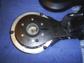

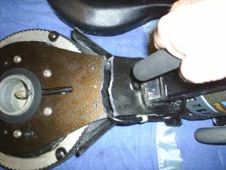

joe harper
Oct 21, 2008
4,993
florida
joe harper
I have one ..that I will trade you for your "ON-DEMAND" tank off that everest...
"IF you know a GOOD WELDER.." :shock:
Les says it can be repaired... 8)
It is the old 2 piece model... :lol:
