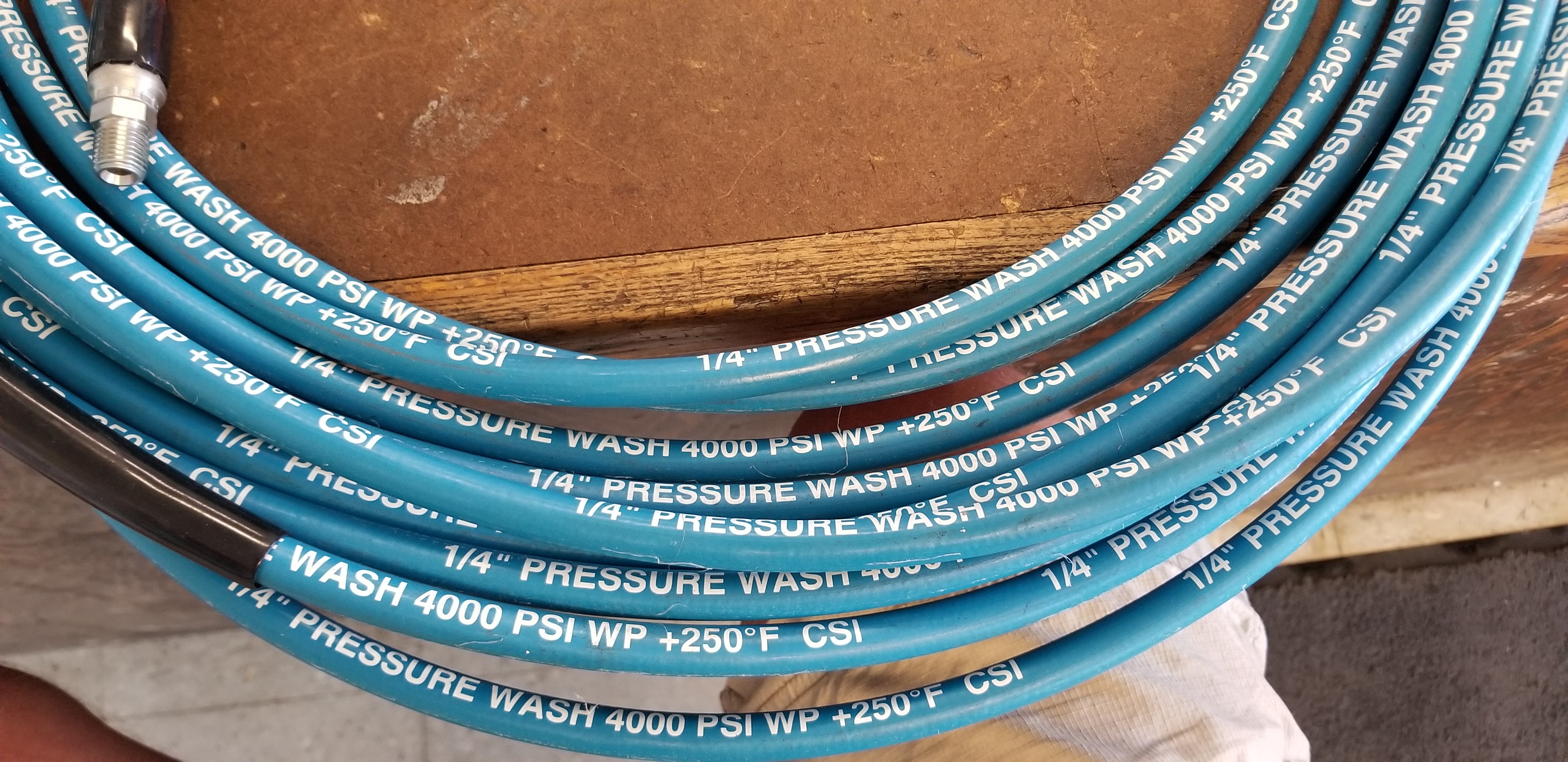

Persistent Parker Parflex Pinhole Problem

So I got the official Parflex crimp in and had the locals install it after cutting another foot off.
When I first fired it up 3 pin hole leaked barely spritzed out then everything settled in and all is well, for now
