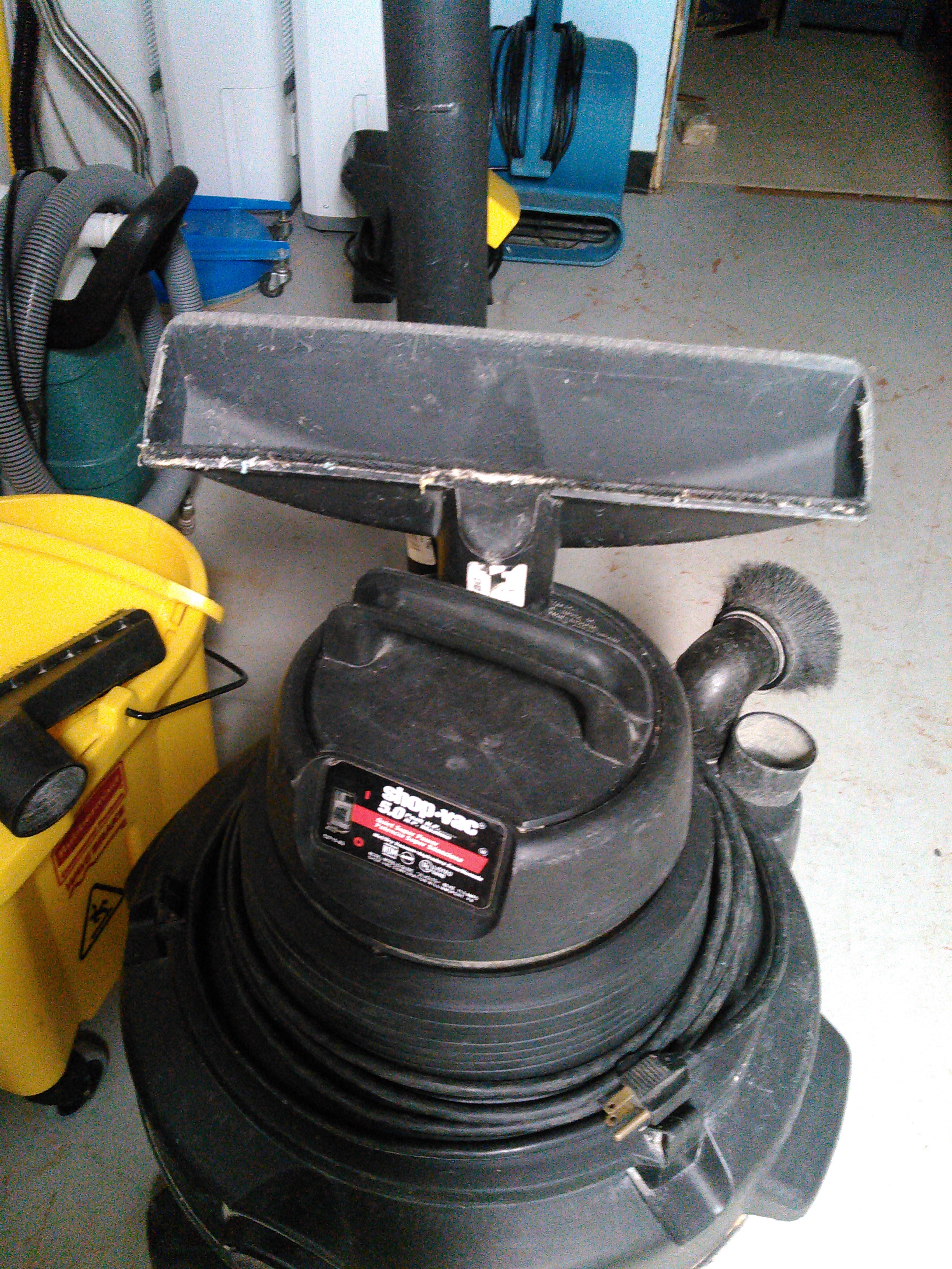

I just use a big shop vac first. Usually gotta clean the filter a couple times. I use the hard floor tool without the brush on the shop vac. Seems to work best. Keep it locked down and walk slowly backwards. Takes about an hour on our basements.
Don't skimp on this step if it's bad. Be meticulous it really pays off when you flush it. Debris will plug your spinner.
