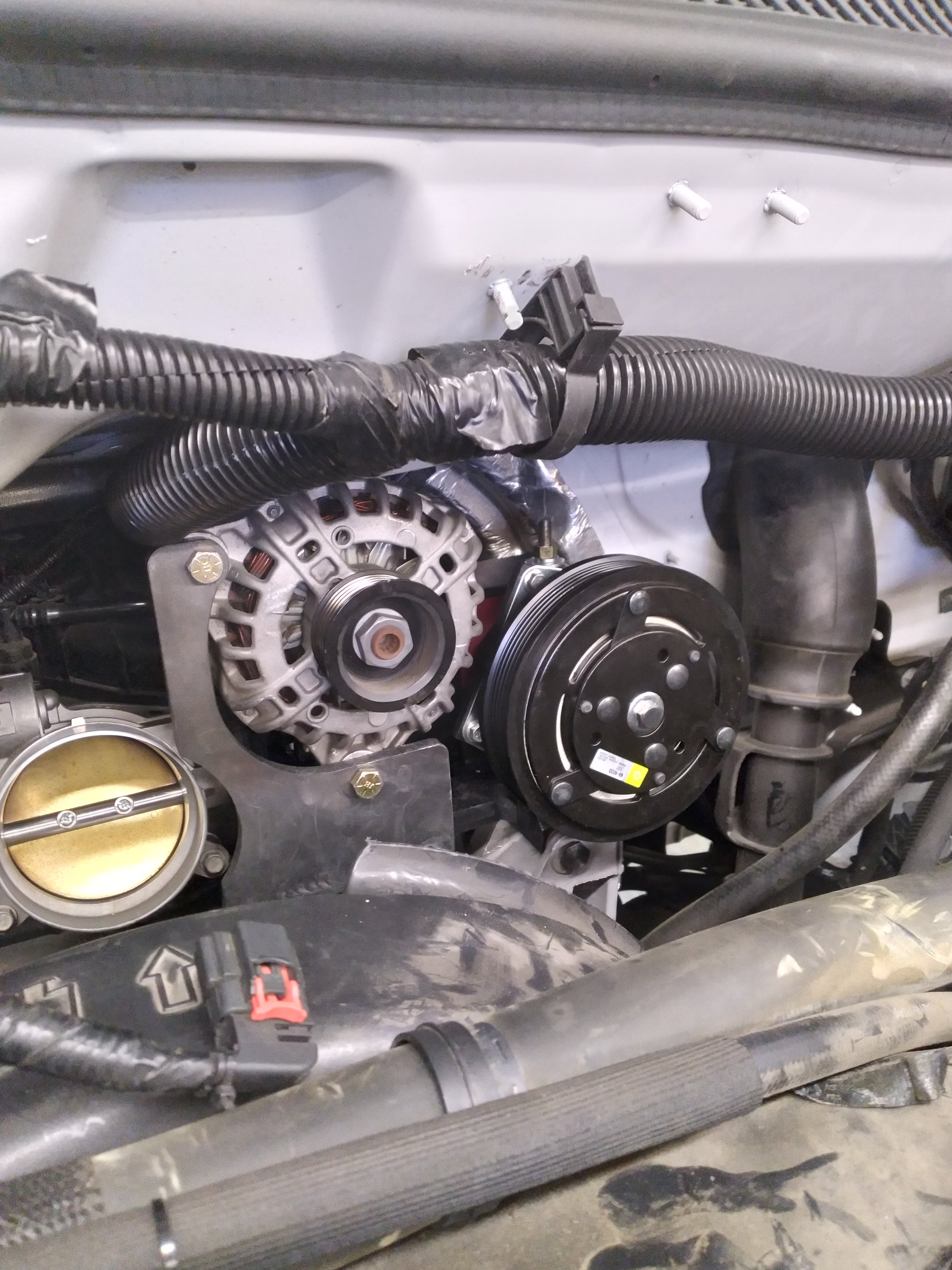

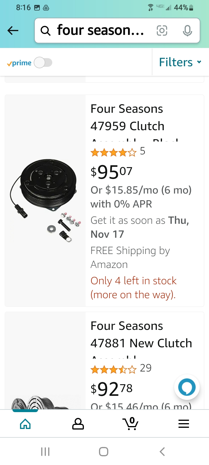

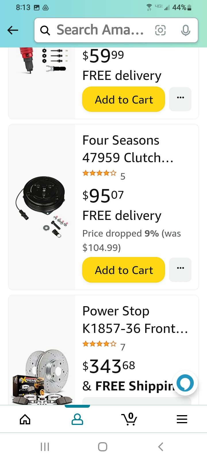

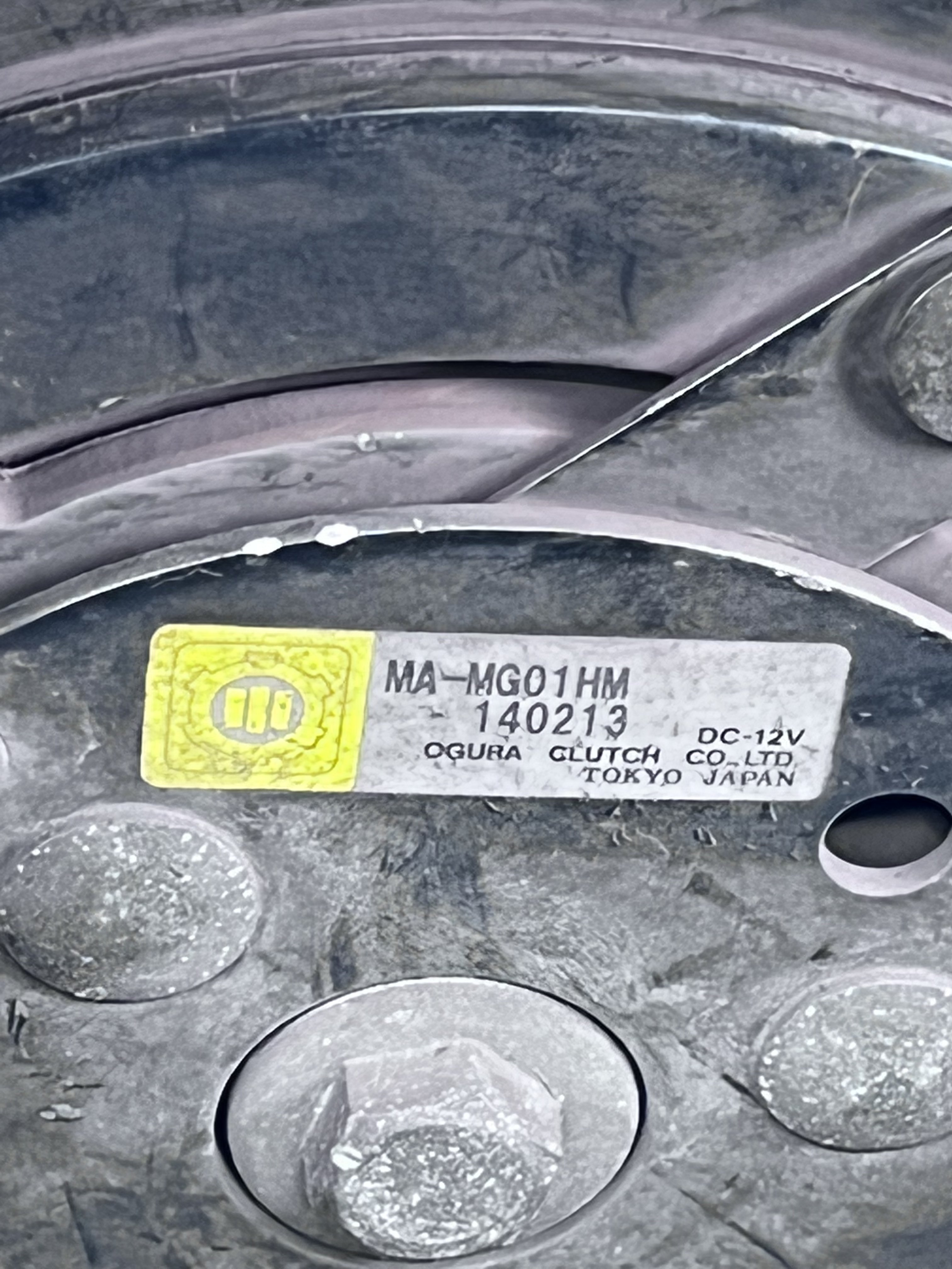

thats what i was looking for so you have used this for your cds before
I didn't buy that one off Amazon because when i bought the install kit for frankinstien it came with a clutch. But i saved that one in my Amazon lists with the intention of buying it, i thought i had a box with a part#on it for the one's that i have bought from napa but i didn't have it ill look thru my records at home i have the napa part# somewhere, i put it wher i wouldn't loose it according to the people that made the clutch, that label has nothing to do with the model# it a code to let them know who when and where it was manufactured, i researched it out and contacted them several years ago about that,at the time i too thought it was a model# and couldn't for the life of me cross reference it. Ill let you know the part# tonight

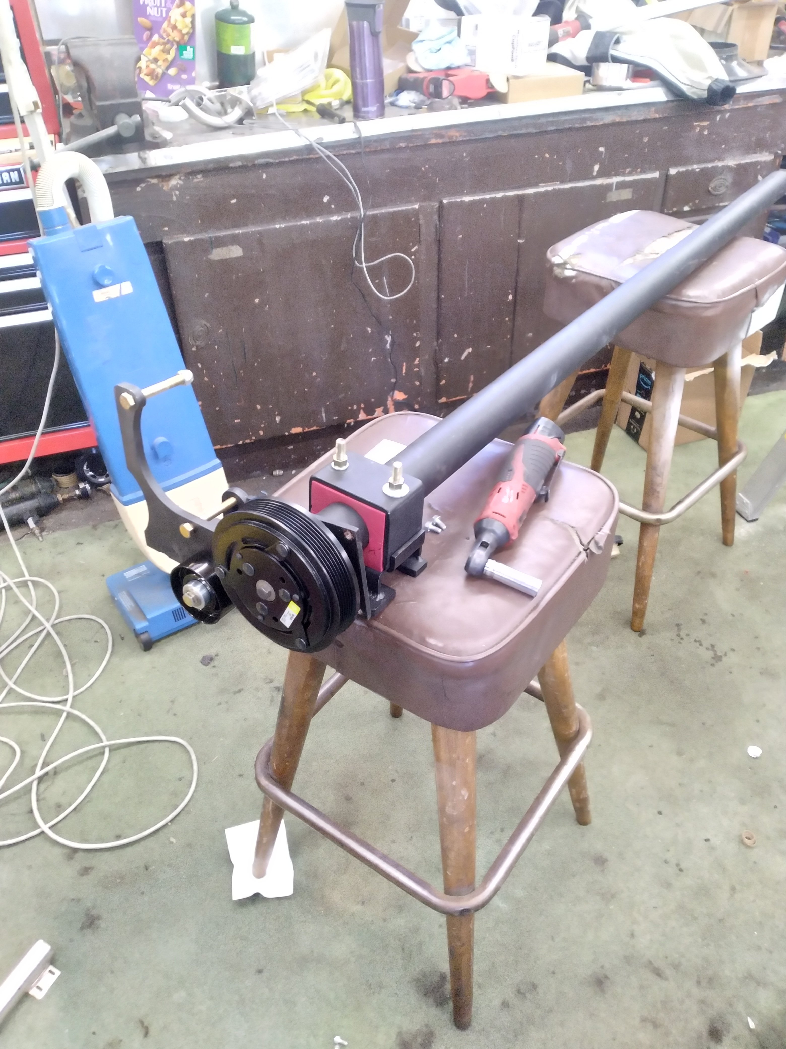

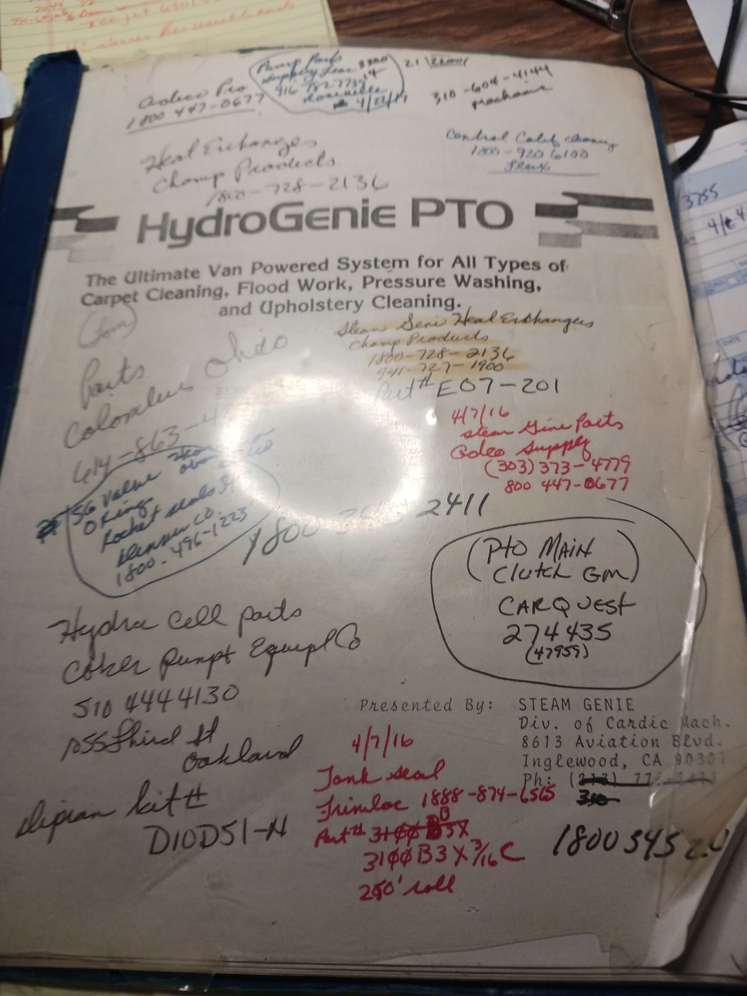

I knew i wrote that f$%@# number down somewhere, here it is its a carquest#. This is the clutch part# ive used for years, although im going to buy the Amazon one the next time i need one
Dwain Ray
Jul 22, 2020
344
That'll do it, keep those #s cause sooner or later you will need a clutch, and you won't have any problems gittin one glad it was an easy fix
