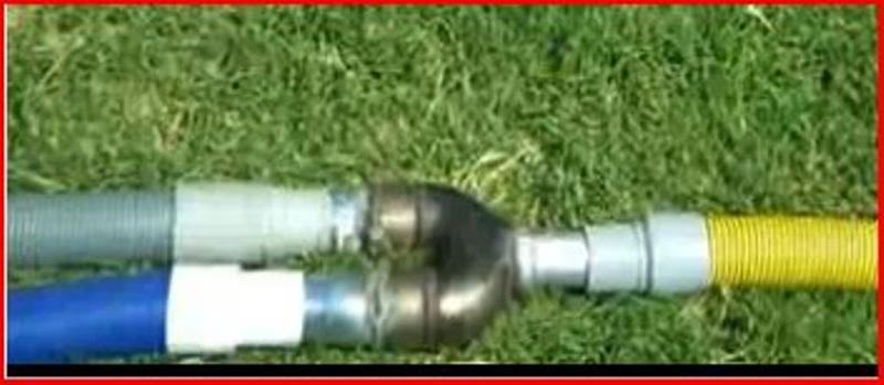

Please explain how this gooped up pos nightmare would NOT interrupt airflow.

I looked at the "Y" that Nick welded up before the vac testing began.
I thought the flow thru it was more than adequate.
I don't remember ANY Goop or sealant.
Larry
117,348
You mean "U"?
Y ask air to make a sharp turn when U can let if flow unrestricted?

That looks like a very nice "Y" connnector to me!
Are they available in anything other than 2 inch?

Turbulence is the enemy in a U or tee configuration. The one Larry posted is certainly better than the one used at the bbq, but neither will perform as well as the one Jeff (Greenie) makes or the one Larry used to make.
Larry, please brink back your original wye!

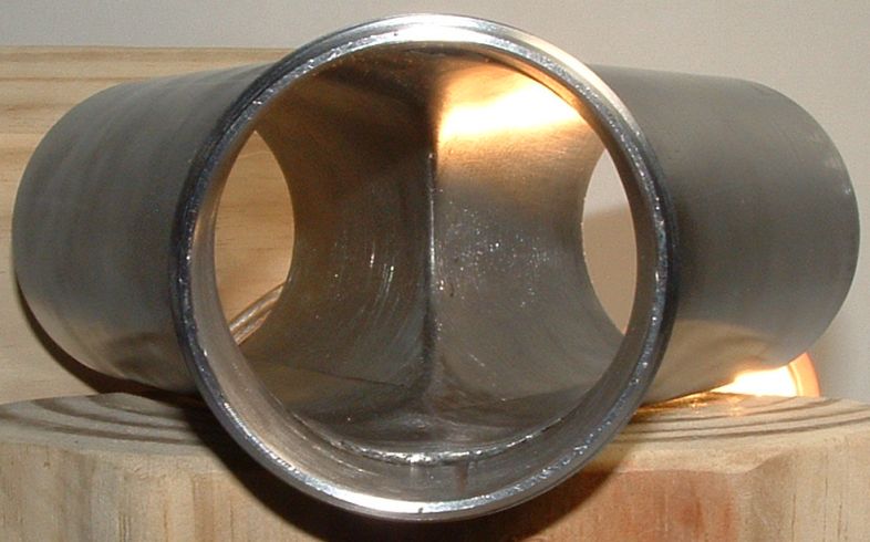

The one shown above is one 2.5" to two 2" hoses.
This is the business end of the old one at the 2.5" inlet:
Larry
