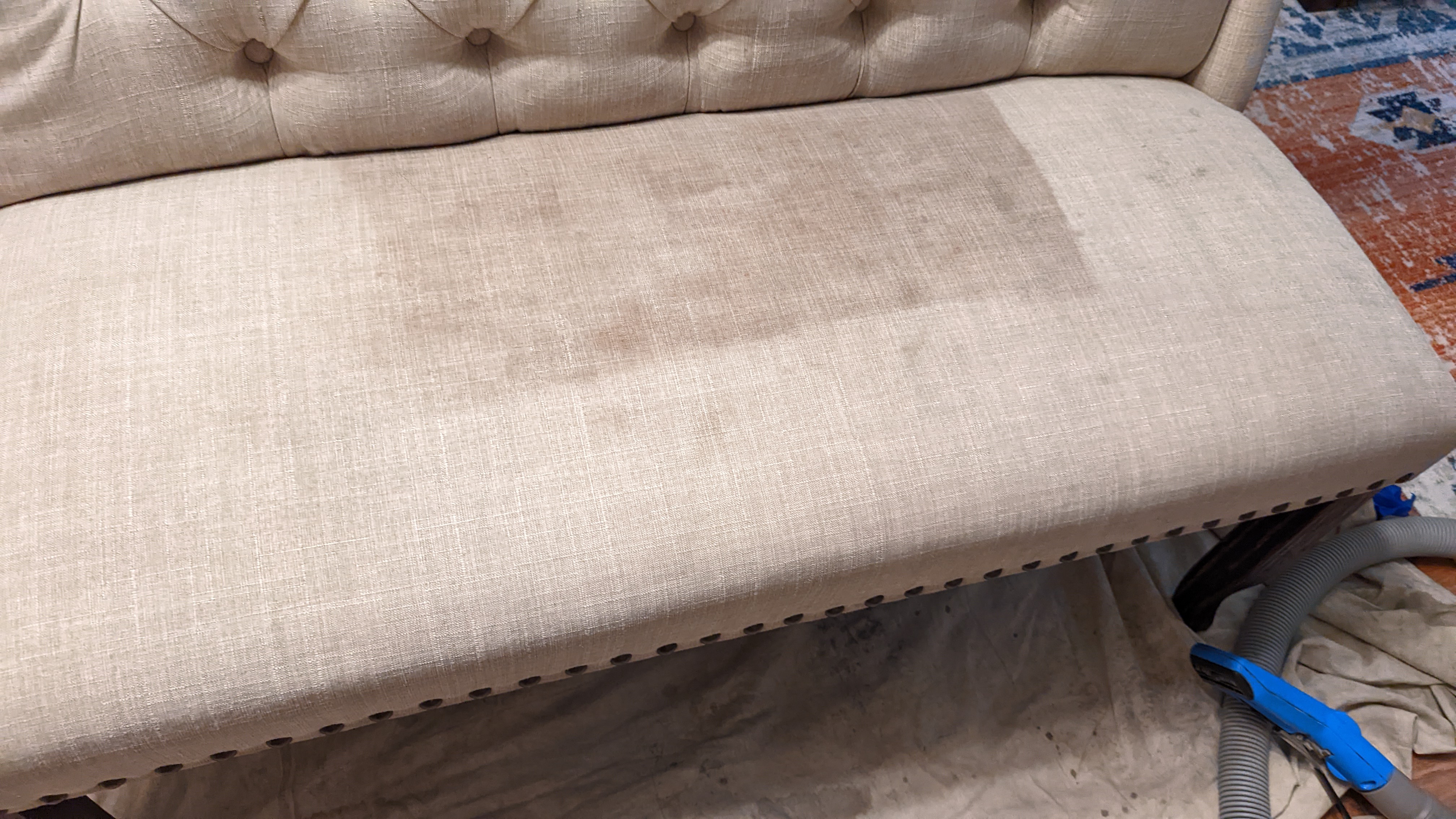

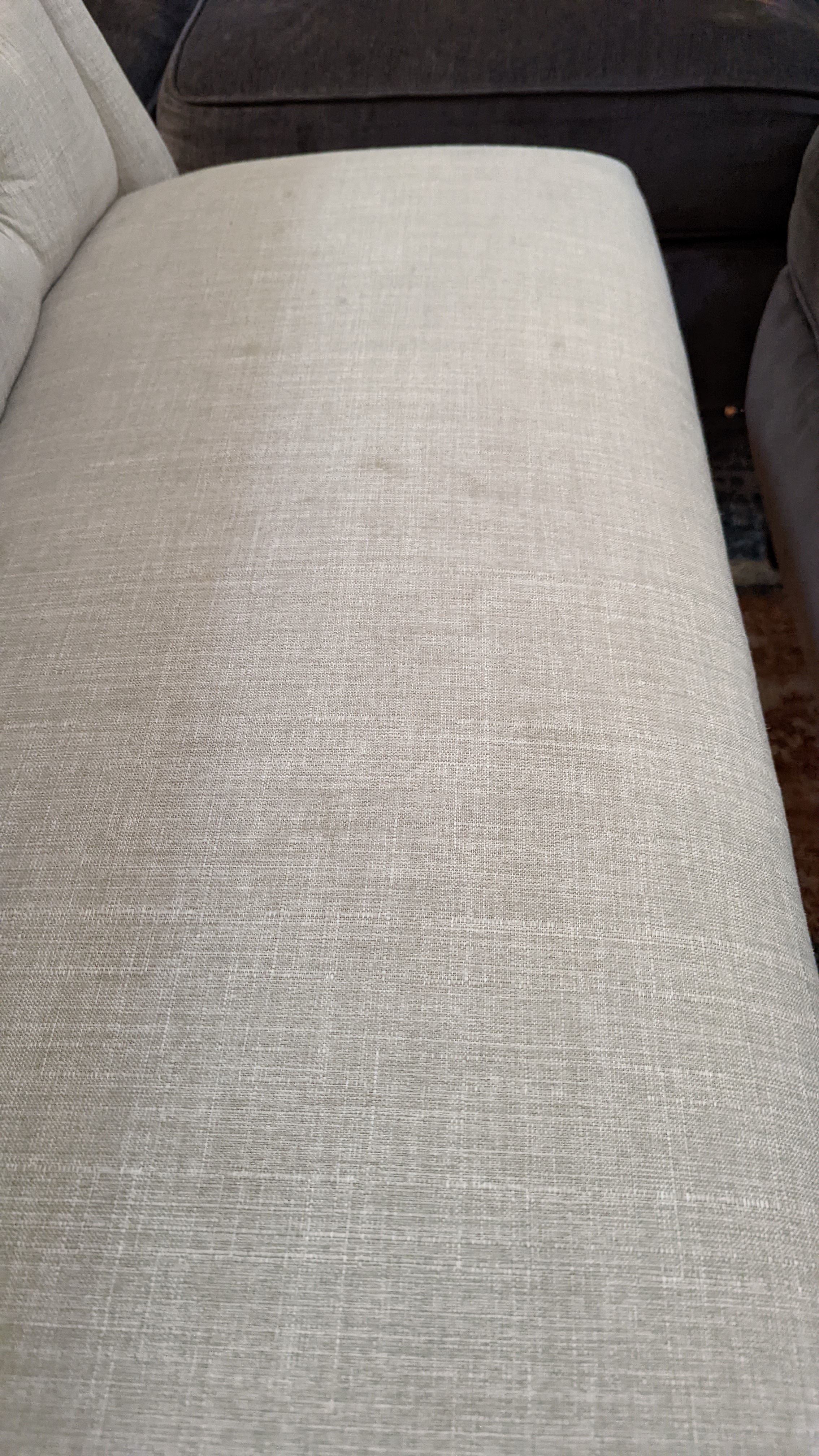

How do you deal with subtle soiling when the typical " linen" (!beige) color gets so dark when it gets wet, do you :
-Only clean in plant, touch up when dry.
- Force dry in the client's home.
-Go back and touch up, if needed..
-Sorry mam, thens permanent.
Reactions: Bryce C and SamIam
14,253
When I get a plant to clean it in…I’ll clean it.
Until then, I don’t clean
27,967

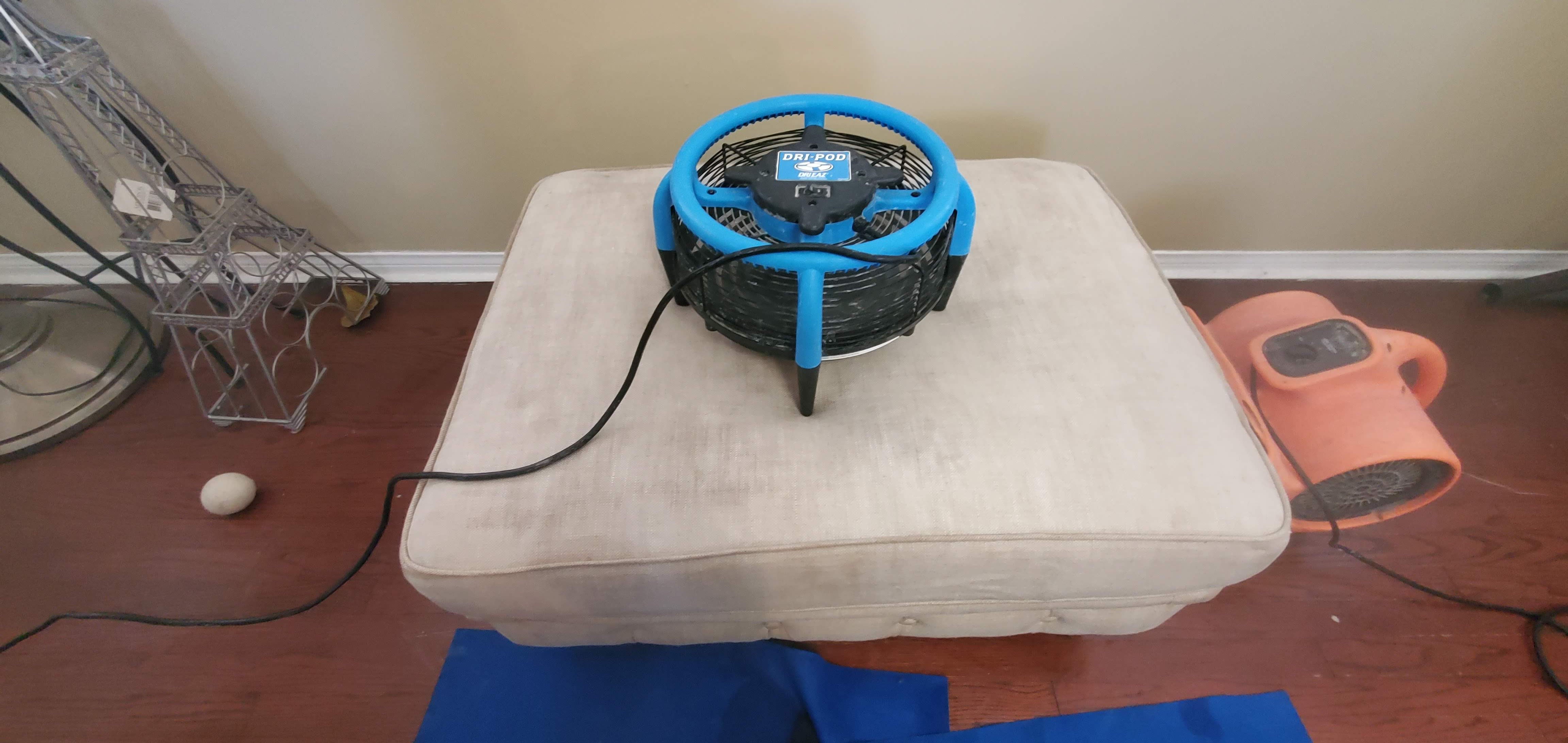

It's hard to tell when it's clean. Good prespray, thorough scrub, rinse evenly and do multiple dry passes. Use fans. Do the worst pieces first, often they will be dry before you leave.

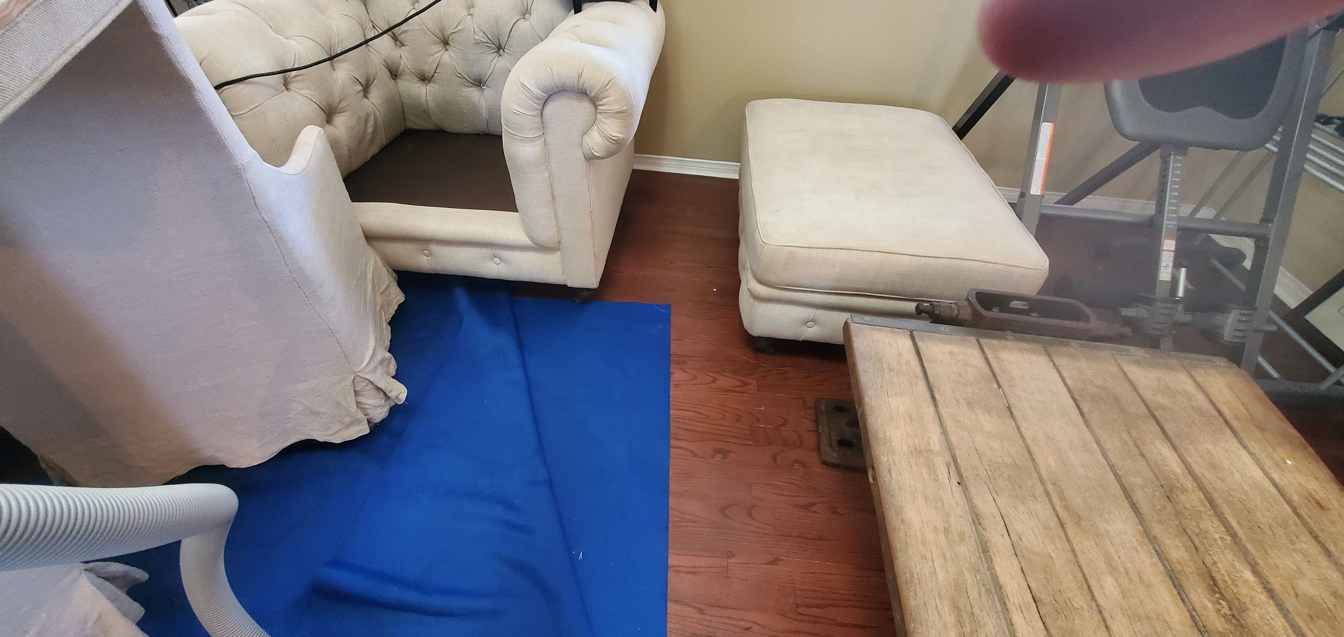

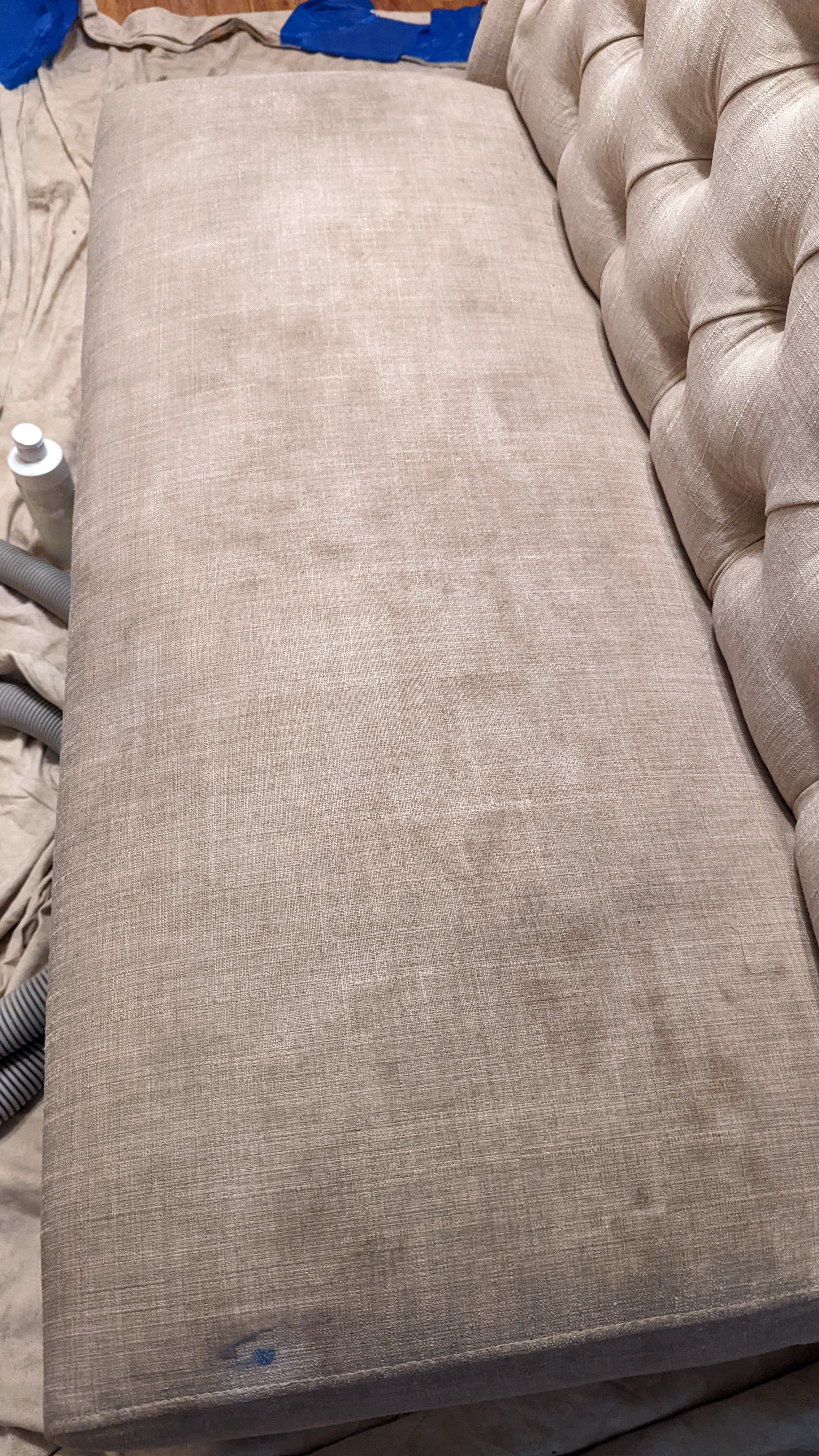

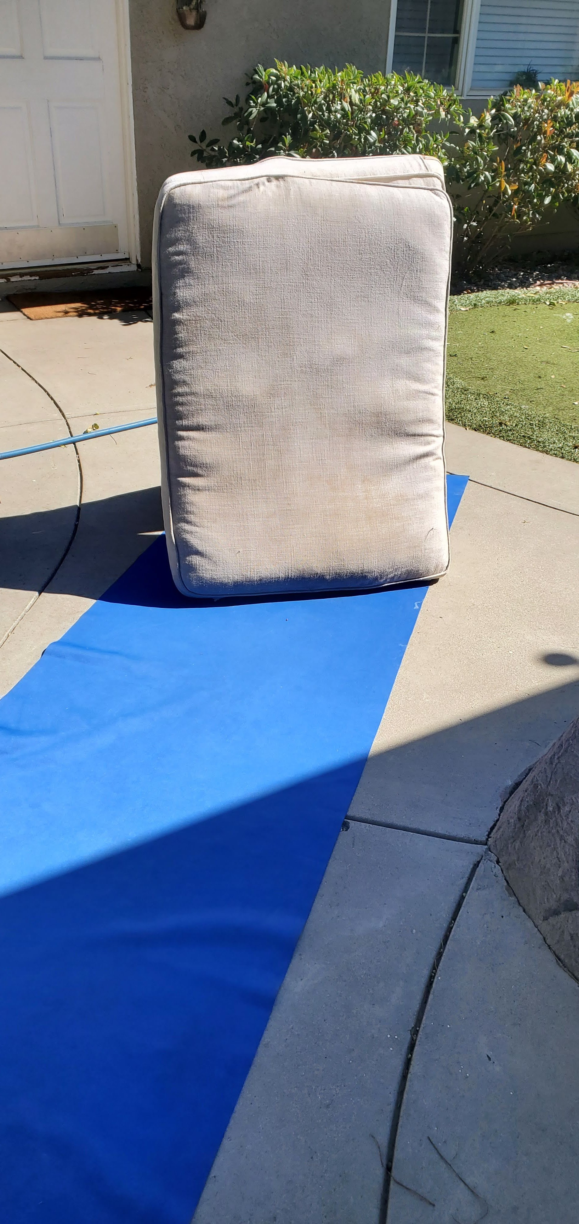

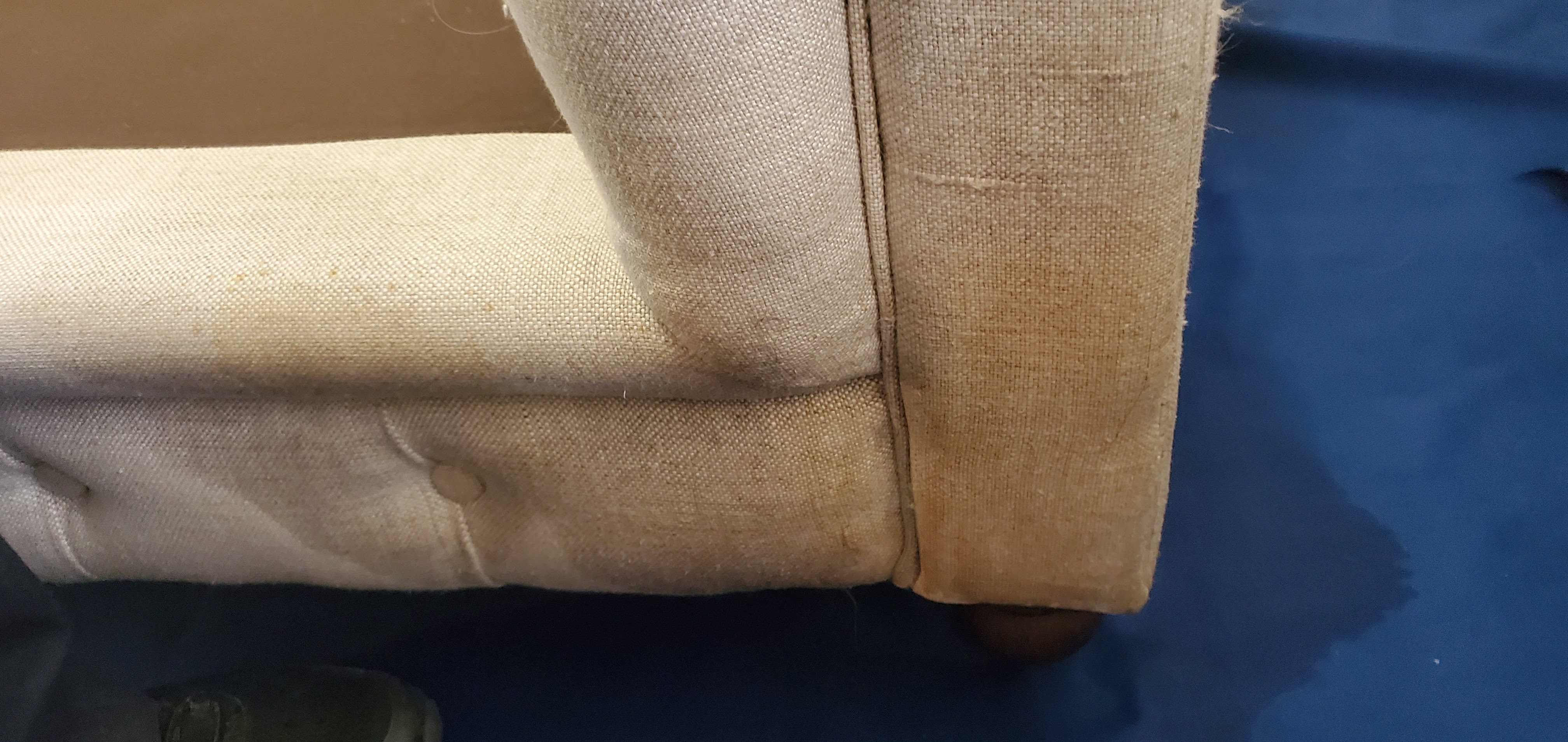

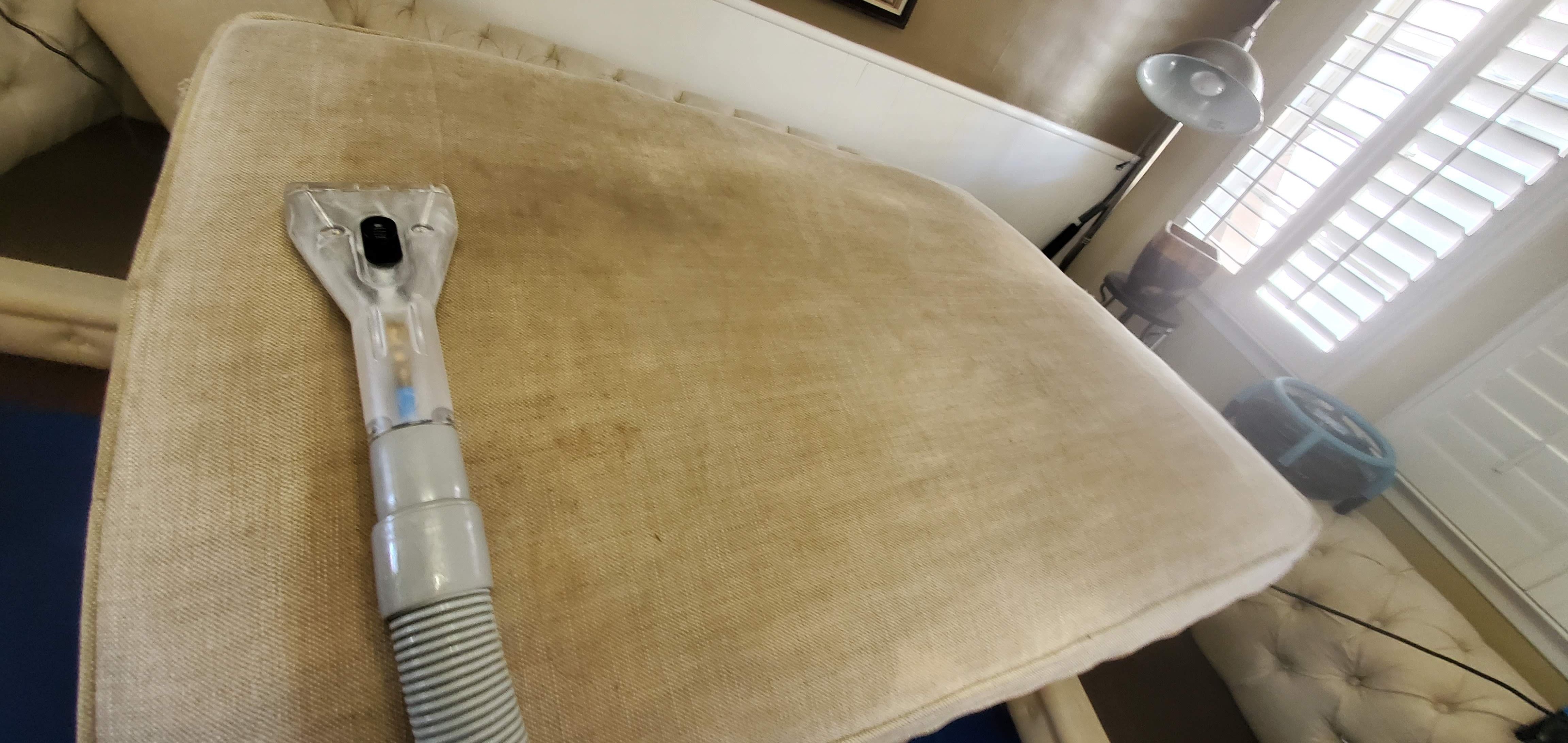

I warned the guy, pissed on all the frames and the dogs use it as a bed.
Thought it looked bitchen until it didn't.
3 seat cushions streaked.
He was an ex cleaner and swore he was replacing it just do.your best.
I got the pee stains off frames came out great.
I told him throw those last cushions in the washer with oxydol. And put them back on the foam to dry.
