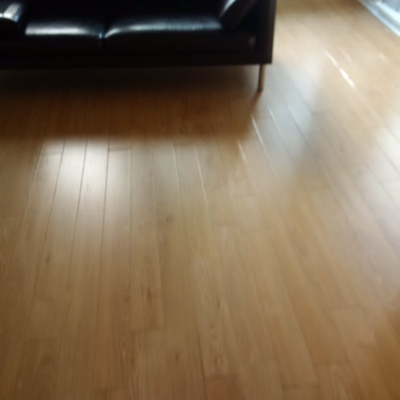

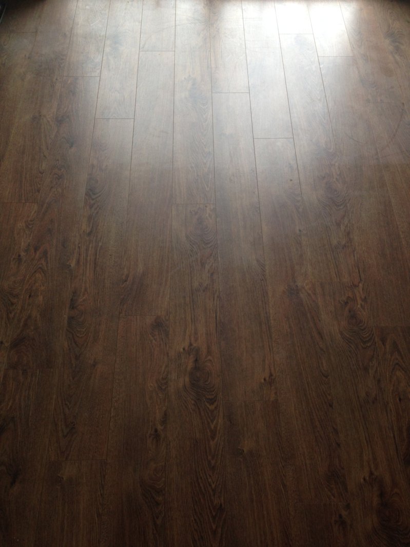

Whata ya not watching the superpigskin flying event today? This laminate business is becoming a fact of life for us these days. a lot of the condos I do have carpets in the bedrooms only and laminate every else. We might as well make some money on it. Even with all the good advice I received, I think I am just going to use my microfiber mops and just do a basic job. I am charging 150.00 for the carpets and the same for the L floors. I am going to experiment on my floors and see how it comes up but this job is tomorrow. ( yes I know it's a holiday) gonna wake people up with my super sonic portable screaming in the hallways.

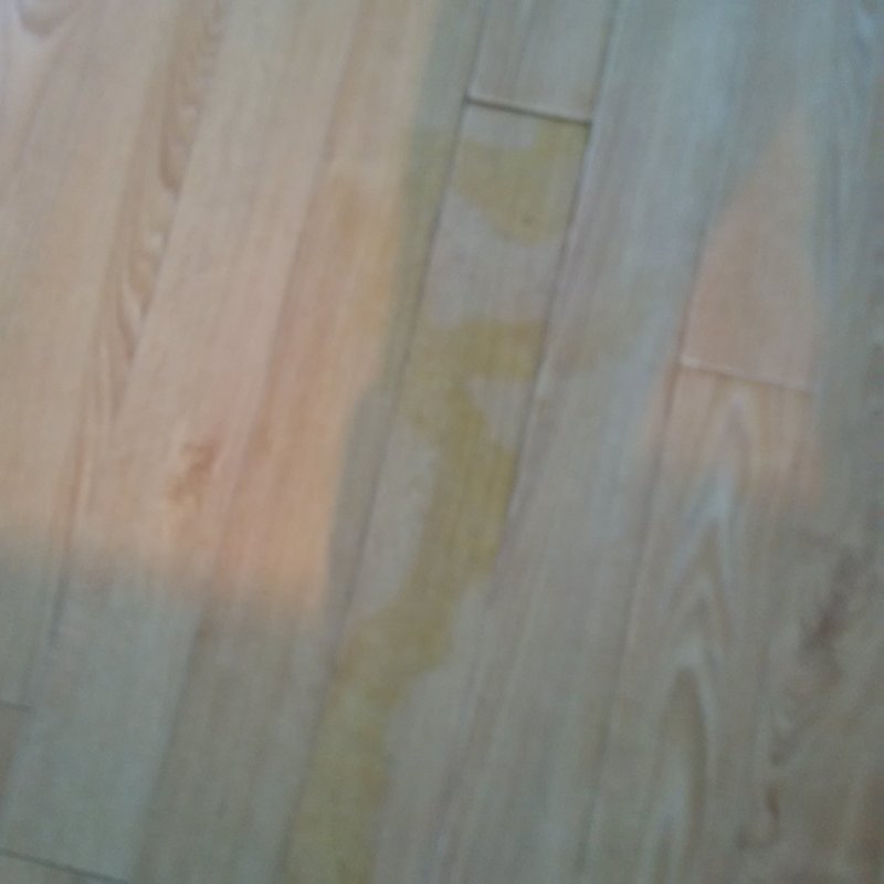

I just did those laminate floors today. Turned out they were badly water damaged and couldn't have used a 175 on most of it due to warpage. Floors should be replaced but lady wants them cleaned for now. Used my wife's handy/dandy spin mop with a neutral cleaner with some urine deo in it. Then a scrub with zep l. Floor cleaner. Then rinsed it again. Came up nice except for the damaged areas.

lordy, someone has been over wetting that floor in the last photo.
I hope you din't make it worse.

she had a small flood and her tenant did the rest apparently. she just wanted it to be more sanitary so she could move back in and plans to replace it soon. I'm thinking on my next one, I am going to try a 175 and cotton bonnet.

Ron, all kidding aside, you did exactly right to use a spinning microfiber mop and minimize the moisture. It is amazing how much territory one can cover with those things. Sometimes, low-tech is best.
