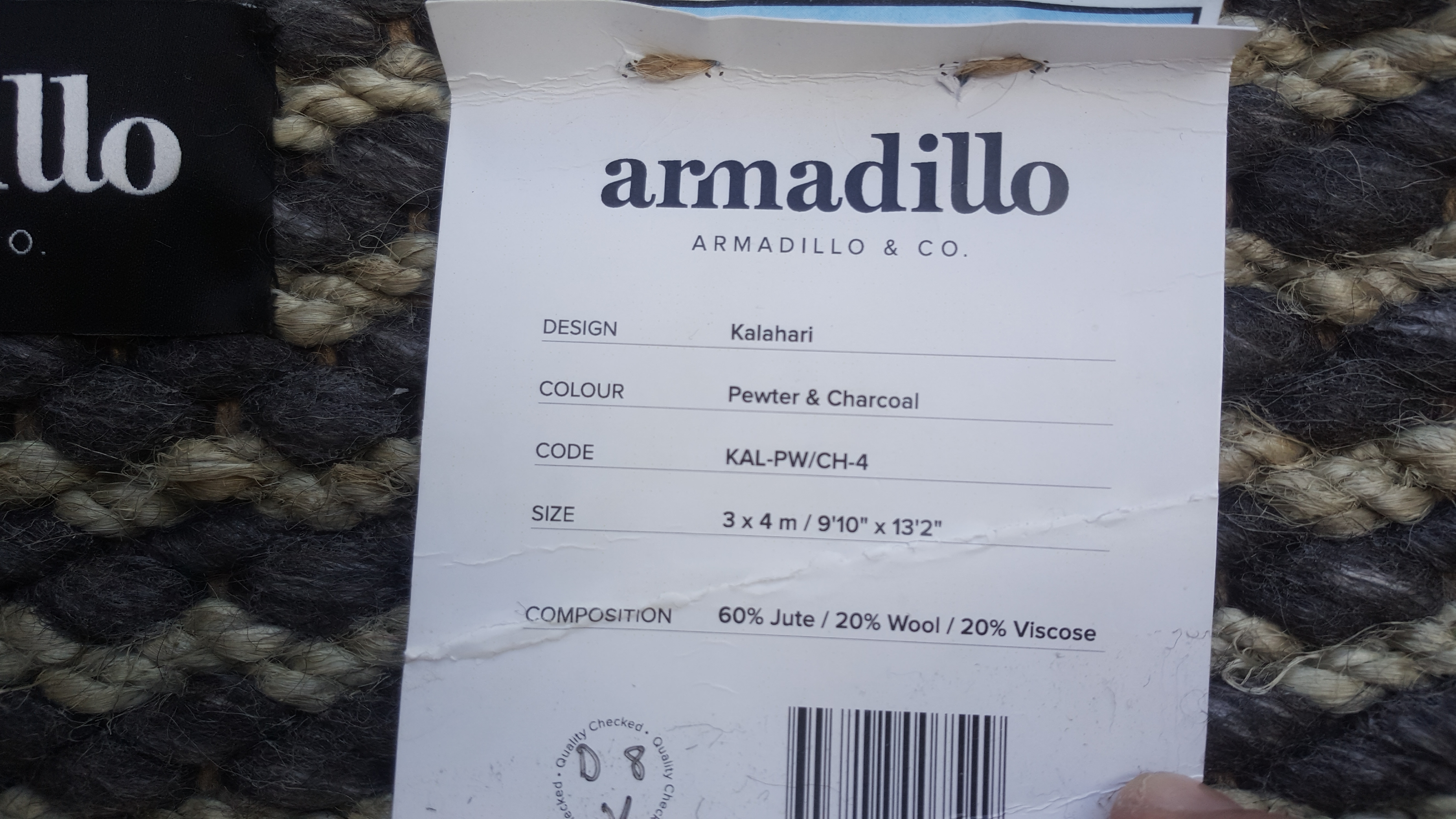

So I've got this near new rug that there puppy has peed all over..
current retail is $3890
dont say refer it to a rug place because there isn't one here..

can HWE or 2 step encap, I've washed more $$$ wool rugs in my driveway, its the composition that has me :headscratch:
I'm thinking of lightly misting 6% HP on some of the visible staining and flushing acid rinse encap into my spot claw if I put that under the rug just to rinse some of it away
possibly light misting over rest of rug with acid rinse encap follow with microfibre bonnet
open to suggestions or criticism :biggrin:
12,673
The jute content will make this one prone to browning, and the viscose content will make it subject to fiber distortion and color bleeding. The presence of urine will already make these weaknesses more apparent, and your need to flush that urine out will mean it's even more likely to bleed , brown, and/or distort.
What worries me is that you don't have a rug specialist close to help you if any of the above happen.
What is the job worth to you?
12,673
handmade rug this size around $350 for me, this client around 3k a year
I can see the value of your customer to you. But if she thinks you ruined it, you would lose over the 3K she's worth in cost, and probably lose her on top of that.
I said "thinks you ruined it", because actually the urine has ruined it. With the above advice in mind, have her understand that the rug in its condition would have no appraised value, and your efforts will be done with that understanding.
