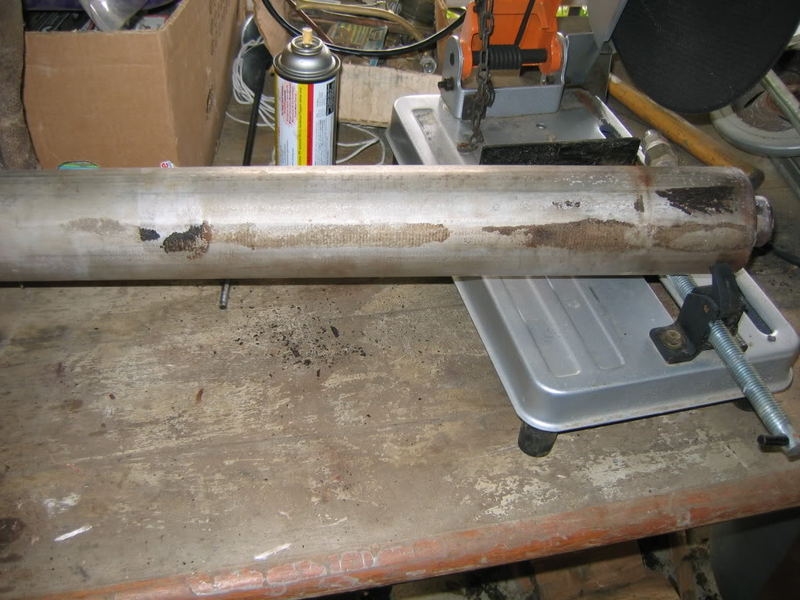

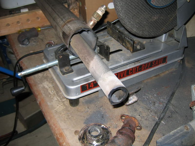

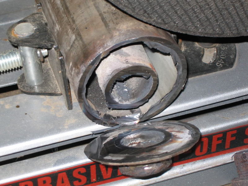

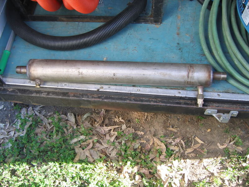

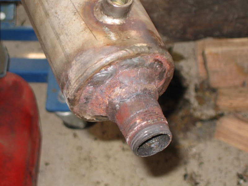

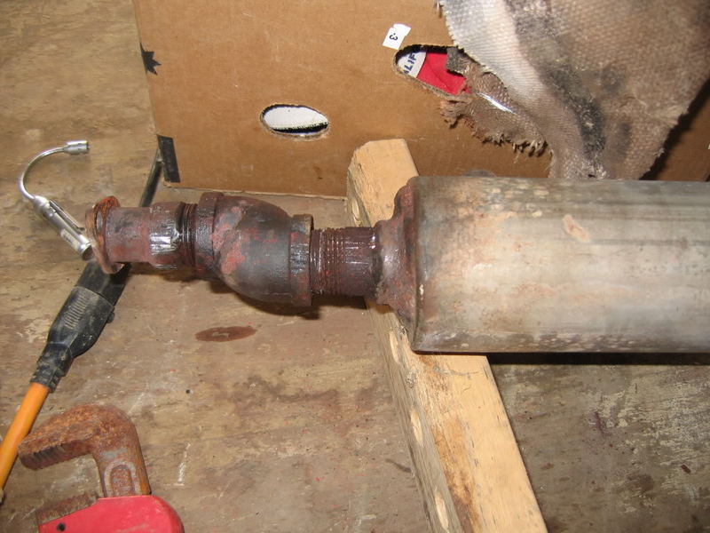

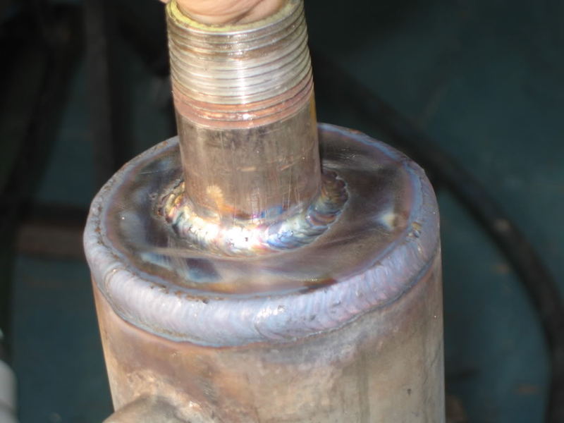

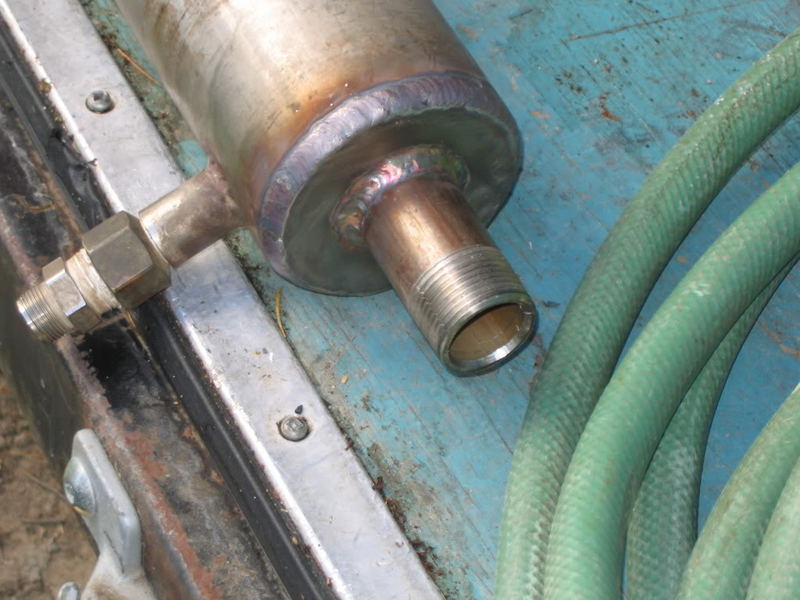

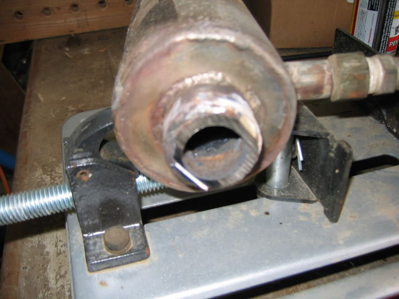

This is my heat exchanger out of my steam action I had to remove it after it started leaking and fill my cylinder of my engine over night. didn't know that until I went to start the motor for a big day of work and it wouldnt start and made a horiiable backfire turn it over just a couple more times and could tell it had too much compression. stopped it and pulled the plugs and spun it over and looked like a water hose. so here is a pic of where I took it out of the other one the other side is a duplicate heat exchanger that comes off both sides of the motor.

It's not quite a nick-o-weld but it'll have to do.
What did ya do to move the HX height so this can't happen again?

all that is is a pipe around a pipe?
what pressure will that HX take?

Damn Chad, you made those welds look hella sweet. That's something I always wanted to learn. :D

Man I think those are sweet but I can't weld worth crap nice job

Greenie can only dream of the day that the welding on the greenhorn wands are half that smooth.
Great job Chad!

I didnt weld it but did all the prep work and found a friend who does it for a living that let him do it because he does it every day I can tig weld but just dont have a tig welder. but either way pretty simple design.

I really don't know, but I'd say somewhere between a whole bunch and a hellavalot
