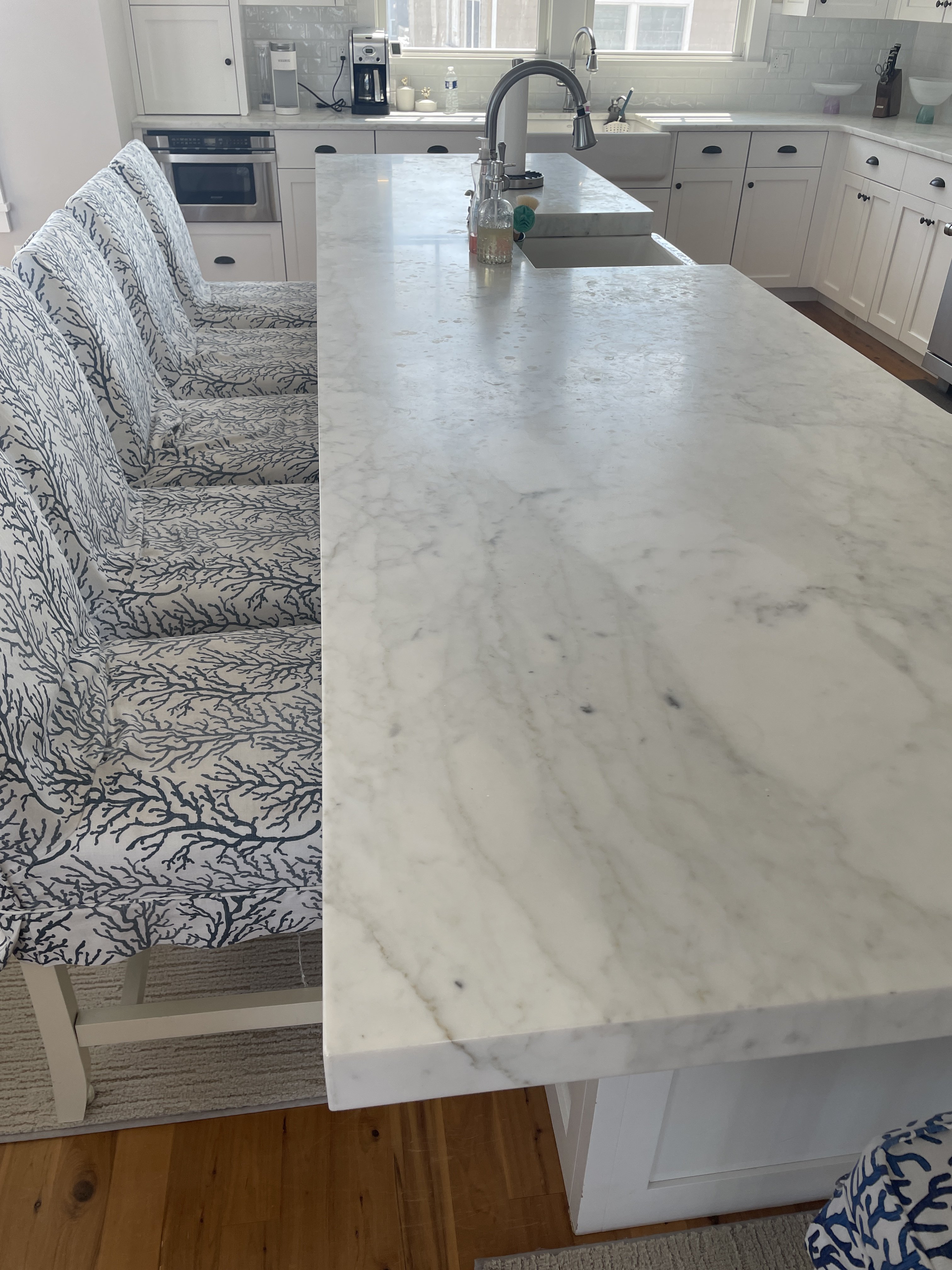

Is this "EZ" to fix
Mike J
Feb 21, 2022
1,326
Mike Joannides
I noticed the surface damage to this counter when admiring it. How difficult (for you pros) and how much coin could I make if I fixed this. The picture shows it but worse in person.
I think I may be a total stoner at heart.
117,232
you can fix that marble with a bit of training and practicing in your garage but they will continue to etch it.
Every liquid in the refrigerator damages a soft calcite stone like this.
and no, sealing wont protect it.
MB Stone offers training to apply a very durable "antietch" coating on marble counters, that hotels and restaurants sometimes chose to do when the anal owner can't take it anymore
