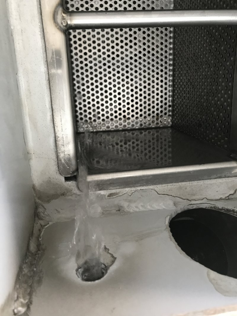

I did that once and it sterilized the ground and killed the grass. I think the current solution are the larger water boxes that are suppose to re-circulate the water for up to 20 minutes before dumping? Not sure how it works...I only had one machine that dumped hot water.

Number one, don't park on the grass. 2, the fitting should be a v or t jet. The water will be cold before it ever hits the geound.

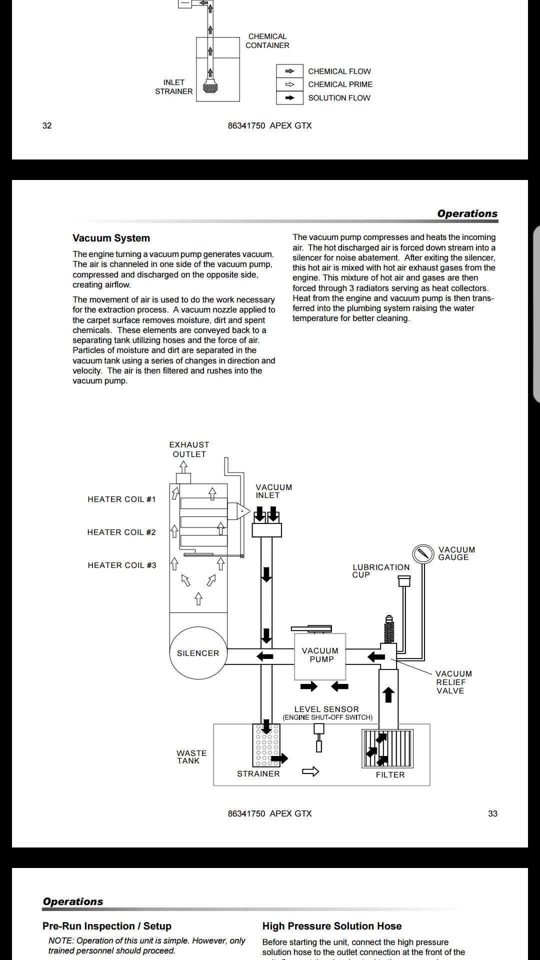

At least they are starting to look better. All I know is the 570 is a heat beast. Divert into freshwater tank seems to be only viable option.

The pic above isnt telling me too much about diverting. My SS370 has a maual diverter to bypass the heating chamber - but I want it to bypass on its own as it reads selected temps rather than dump the water to bring the temp back down.
A
Able 1
The new Gtx diverts the exhaust, at least that's what it looks like to me.. I was looking into it because I noticed they changed the heat control lever position.. I saw it on @Dan Lofsten post, and wondered what they did.. Maybe he can fill us in..
