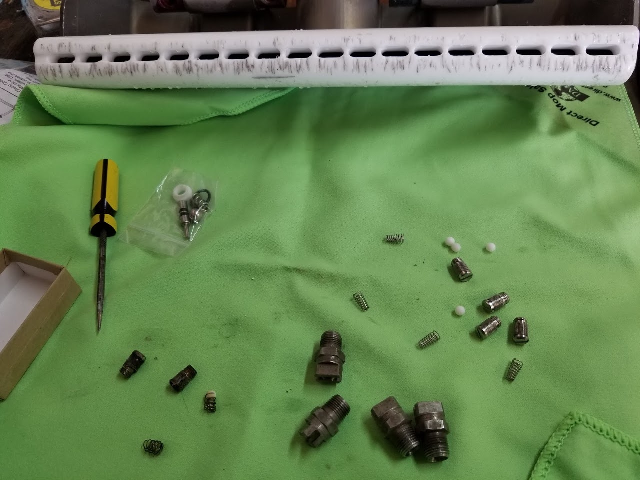

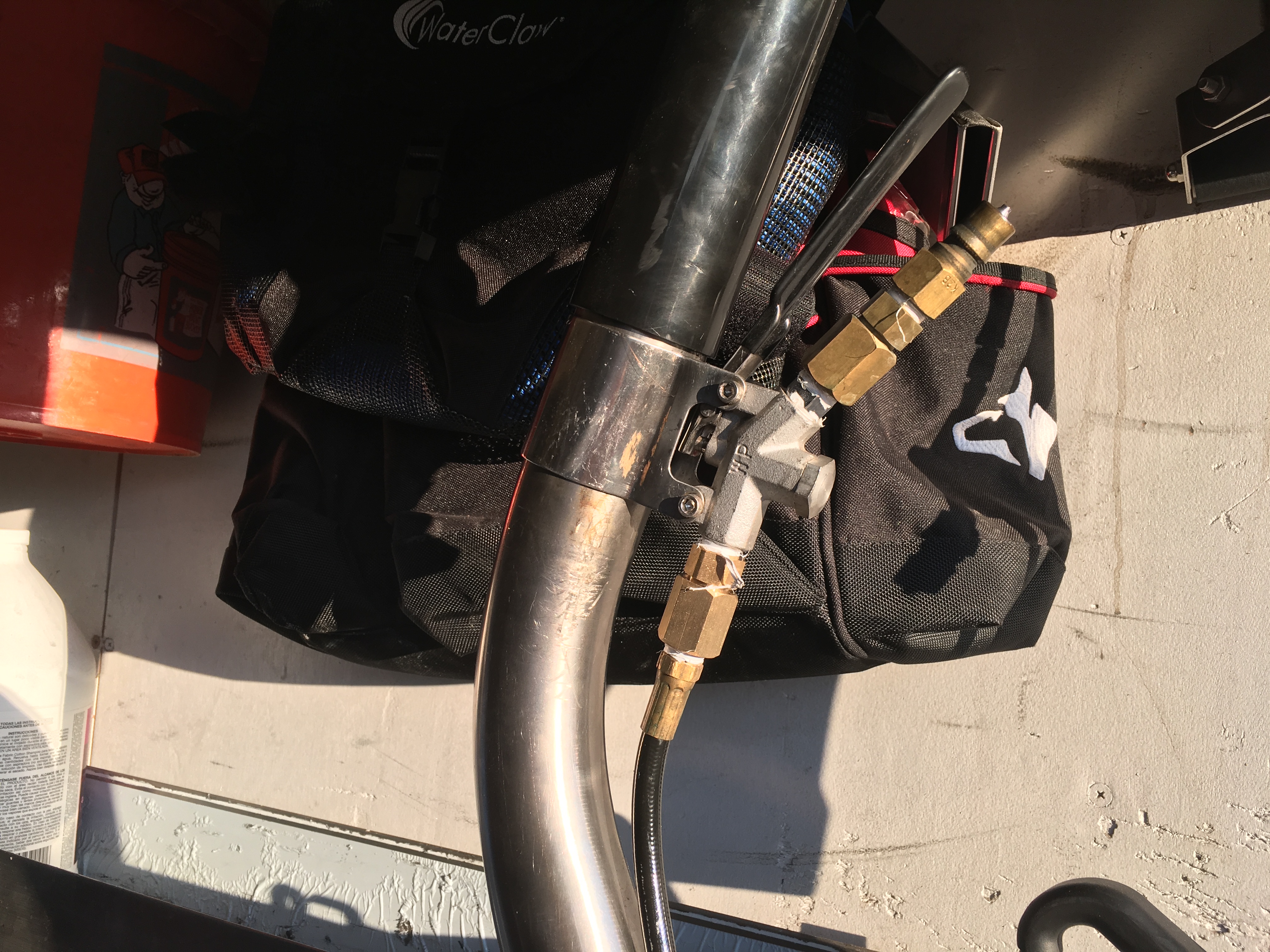

i took out the wand jet filters, upped the flows from 1.5 to 2flow jets (making my wand 10flow), and installed an in-line filter after my soft touch valve, as well as before like always
Since I’m now using 10fliw on my wand, should I increase or decrease my water pressure?
