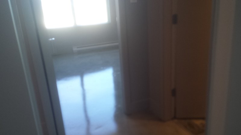

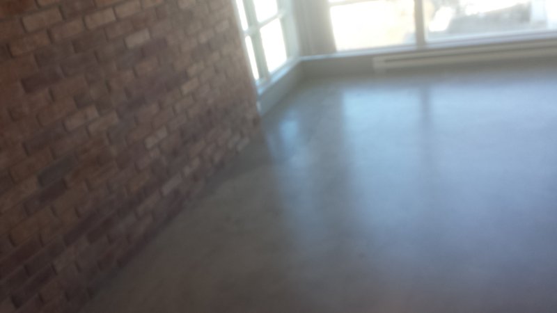

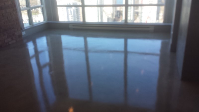

I'm keeping it really simple. Clean and apply finish - that's pretty simple.
Here's todays stuff.
Reactions: Captain Morgan
