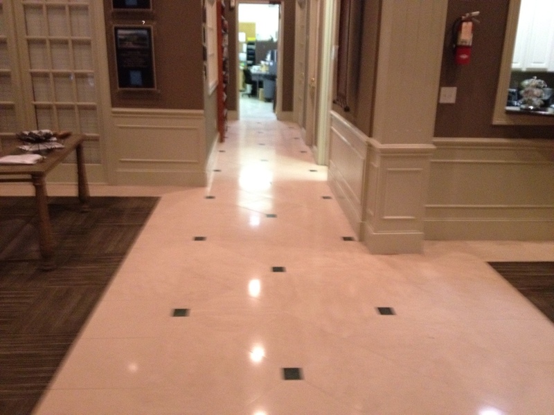

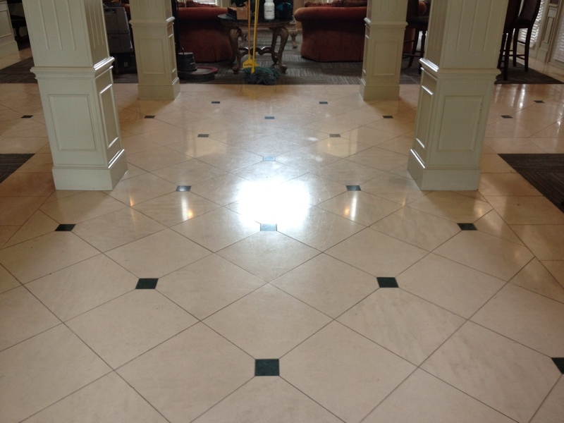

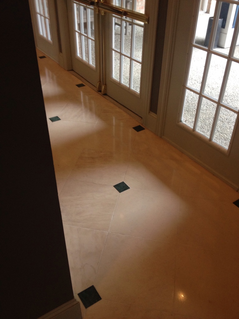

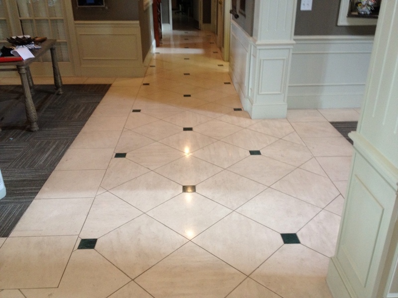

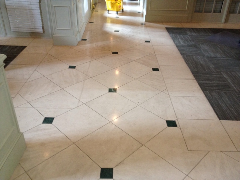

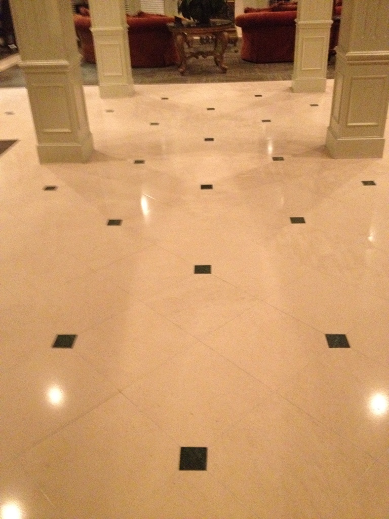

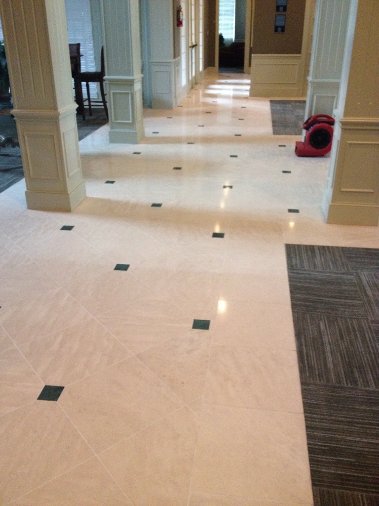

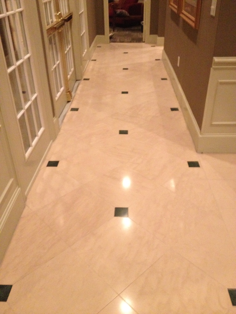

cheetah pad(Larry let me borrow a cheetah to try out). I have to first say I understand now why stone guys charge so much, it is like doing the same jobs five times in one day. I started using the number two cheetah pad but it made a lot of noise and actually started falling apart so I thru it out and grabbed the monkeys. I decided to start out with four hundred and work all the way through the set of pads to 11000. For me it was challenging, mentally, because the first three steps I saw so minute change it was quite trouble some for me. By the 8000 it started looking ok but not great. The 11000 gained some clarity and added some depth but not as I hoped.
The customer is just flat out amazed and is very happy. I was not on the other hand. I see all these video of these guys doing the same color marble ( I know none are completely alike) and mine did not look like theirs. Here are some pics and have to say, I think it looks better in rh pic than in person. It took me 11 hours to complete and I'd the 11 hours, 5 hours was stripping the floor and getting 5 or more year old wax and sealer out of the grout. I am already looking at a real set of stone equipment to really get it done right.
Before
After
Before
After
Before
During 400 grit
After

I see what you mean. It is much better but not the results you see in the videos. Did you have a weighted machine? That might make a difference. I hope you charged enough to make a profit. Stripping wax off stone and grout is a pain and time consuming. What were you at per sq ft price?

All I see in those pictures is potential damage/replacement cost. One slip of the rotary and you'll bepainting baseboards.. There's much lower hanging fruit out there. :mrgreen:

Just powder polishing would of gained you alot more shine out of the stone. This would have also required either using a splash guard or putting up 100.00 worth of tape and plastic.
While not sure of the severity of the strip job. I would have been at around 1.00 per ft for stripping/cleaning, and around 1.50 per ft for powder. I would have charged another 3-3.50 per foot to use diamond resins on the floor.
Clean and powder polish : Better
Clean, hone, powder polish: Best
These are the 2 options I give people.
Re: I just finished my first big job with monkey pads and on
I liked the before better, can you put the dirt back in it? :p
Very slight improvement, especially for the time spent. Looks like tough sledding.
117,285
I hate to tell you this Michael but you just spent 11 hours polishing Porcelain :lol:

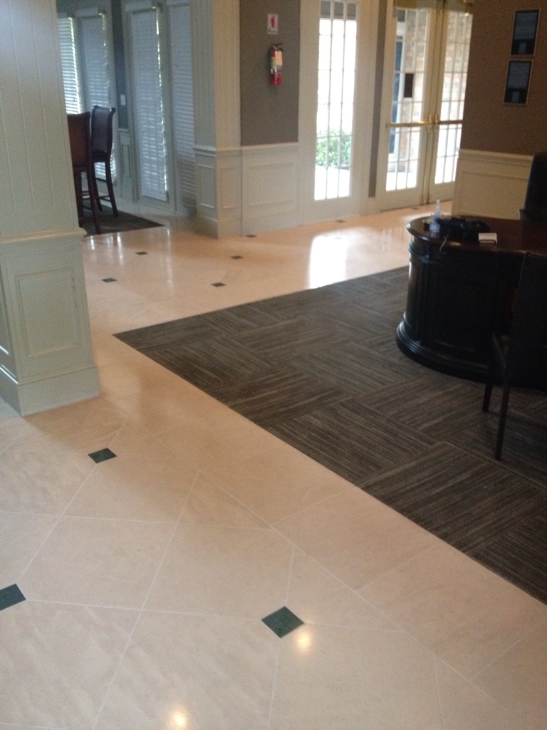

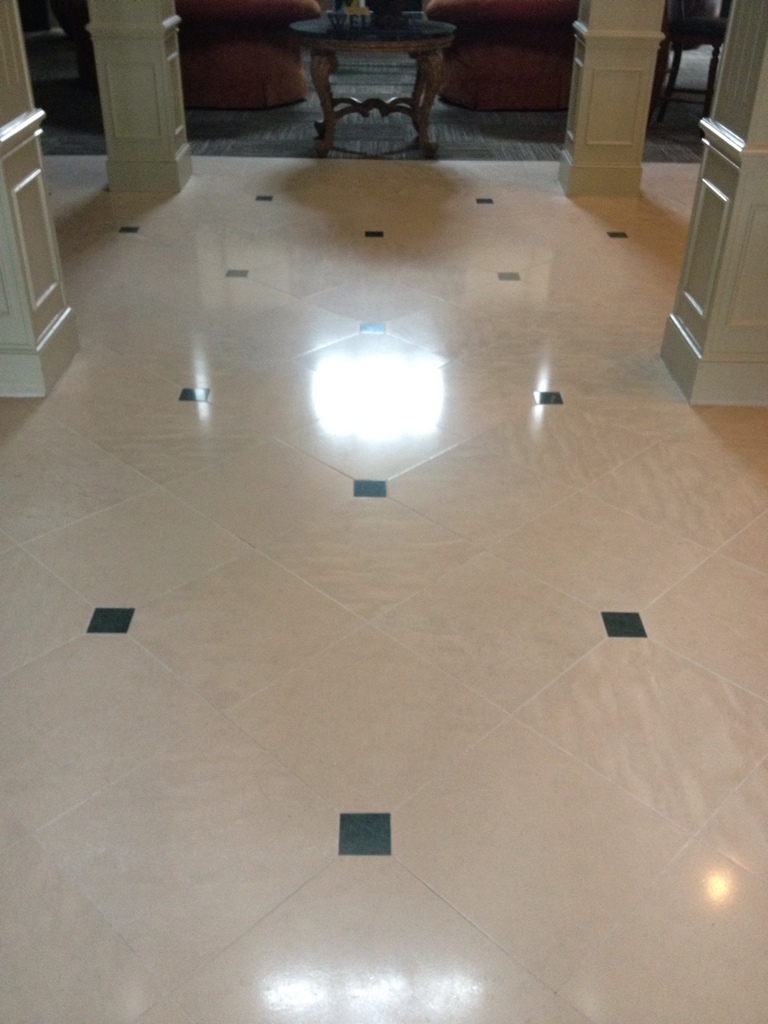

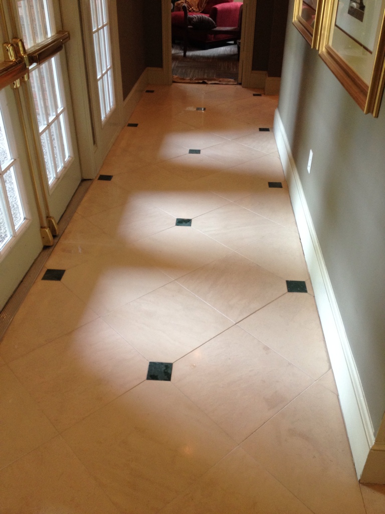

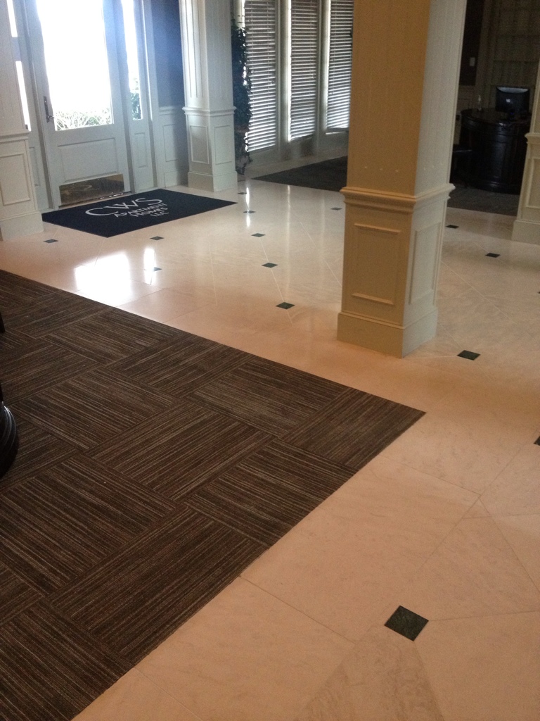

I left one of my airmovers and went back to pick it up. I have to say it does look better during the day. Not perfect but definitely better. Customer was very happy.

Looks much better in those pics Michael. Good job!
Hahaha here I thought those were serpentine tile inserts and now Mikey has me thinkin they might be 4 inch vct tiles....

as long as your customer is happy, that's what matters. there is some orange peeling going on there looking at the reflection of the pics. i finally used those pads on a travertine with sanded groutlines and major lippage recently, i didn't like the orange peeled look, but the customer was happy. i think twister pads are cheaper as well, i may be wrong.

I asked Larry Cobb and Ron lippold about the orange peel effect, and was told that I took too long with last two steps and burned it.

Mike the floor looks fine, sure some will bash but if the check cleared and they are happy your good to go. You will lean the time. Wjen its time to buy diamonds you will step up. Just get a little time on the pads first.

Going back to clean the carpet you piled all your equipment on? Good thing it was dark carpet huh..

I cleaned the carpet before I left. Man some you guys are wound tight.

You did good for just monkey pads. The cheetahs were clacking because there is some pretty bad lippage on the floor. Powder polishing after the 800's would have saved you some time and would have popped the shine. But it does require some practice so with what you had it turned out good. I could be wrong but that looks like limestone not marble. Did you get to see a spare by any chance?. Some limestones don't shine too well and are sold in a honed state.
What was your procedure for stripping the floor?.

I layed stripper down with a mop 5 to 1 . Let dwell 15 minute, layed more stripper and hit with a 175 and a Cimex with brushes. The grout did not want to come clean, spent almost three hours trying to get all the wax out of just the grout. Most effective removal method was with grout brush and small stiff brush. Two different strippers was used.
