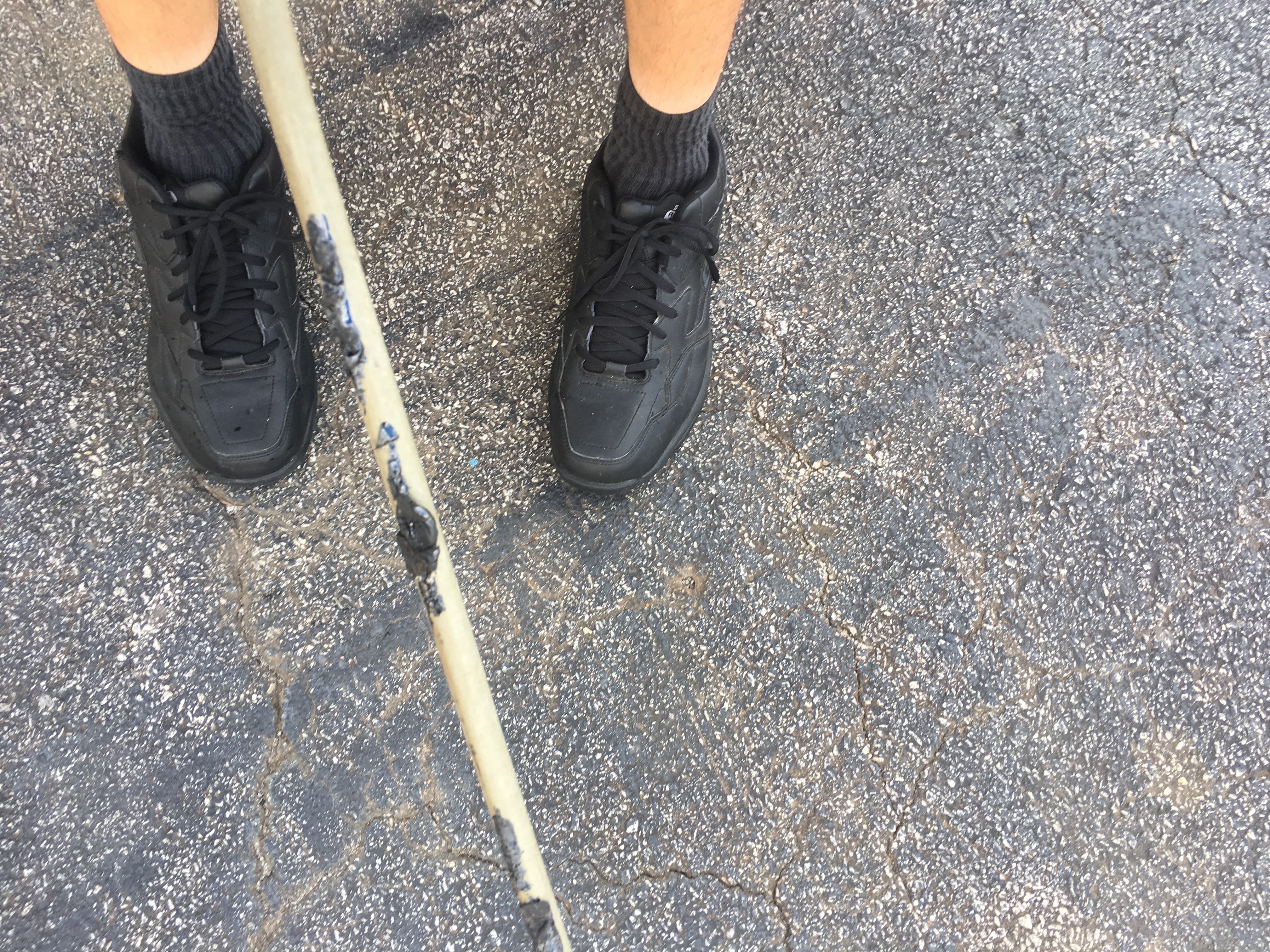

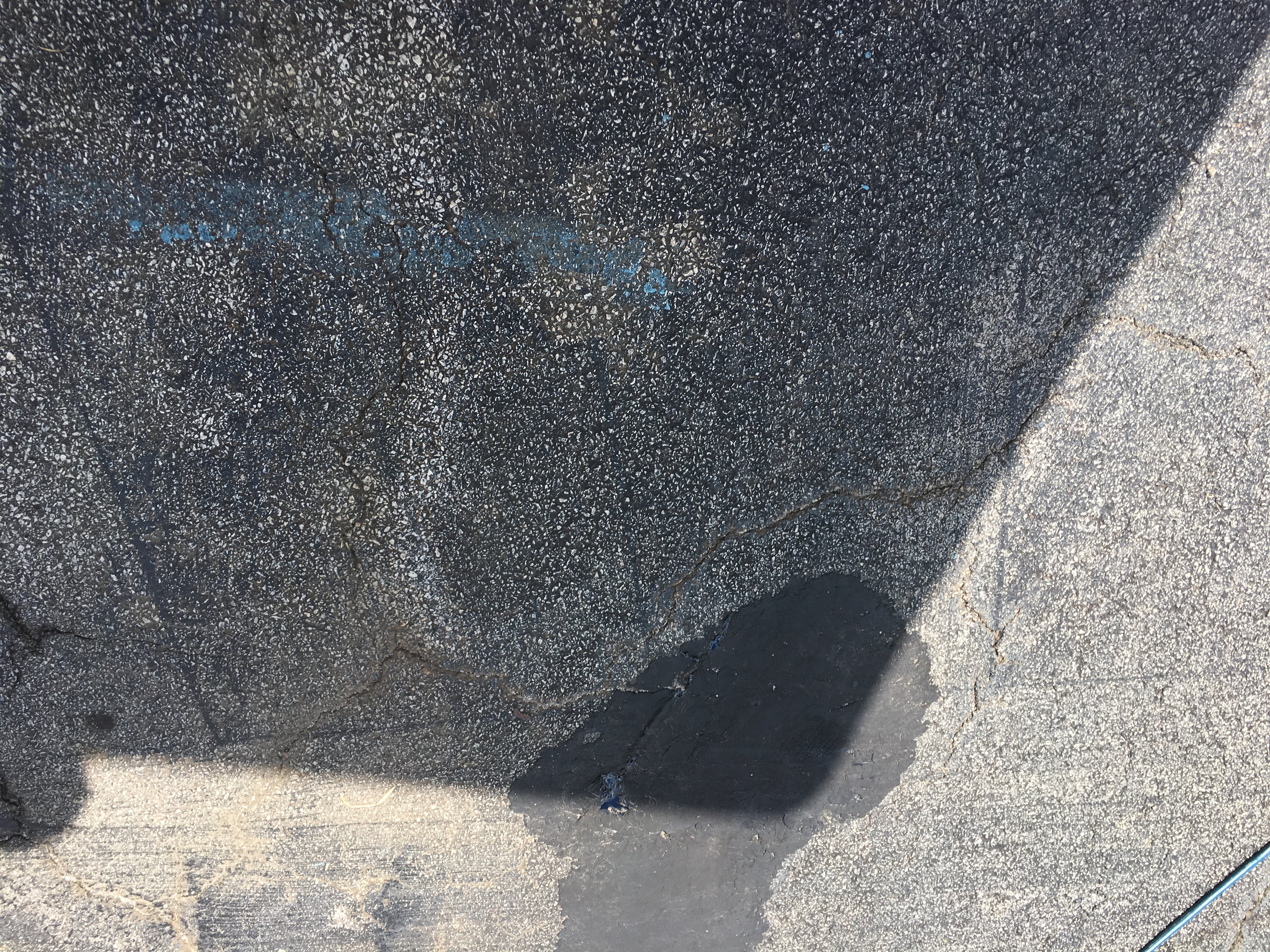

I think where the hose meets the crimp you have open wire brade which corrodes quicker than the rubber breaks down. I usually recrimp once or twice. Then I just don't trust it. Plus by then its leaving blue on the driveway.

14,254
This happened today. My heat was turned off on this job. I hate summer heat
