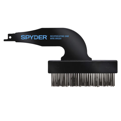

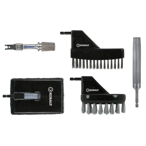

My wife attached a small tile brush to a reciprocating saw and cleaned the grout in our kitchen.
It worked great. You gotta love that woman.
Actually, that’s pretty frickin cool...
I’ve wanted to get a mini square scrub (Doodle Bug I think), and try that....

or the industrious MacGiver can easily make their own with any brush they want

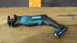

and here are some sawzalls that are "sOOper approved"
full size are too unwieldy, heavy and stroke too long for detail work
so I won't mention them and stick to compacts
battery
for corded compacts, the Rigid is a solid "contractor grade" tool
(Rigid has stepped up their game in the last 10 years, and some of their tools are now "fo-reel" contractor grade)
this is one of them
