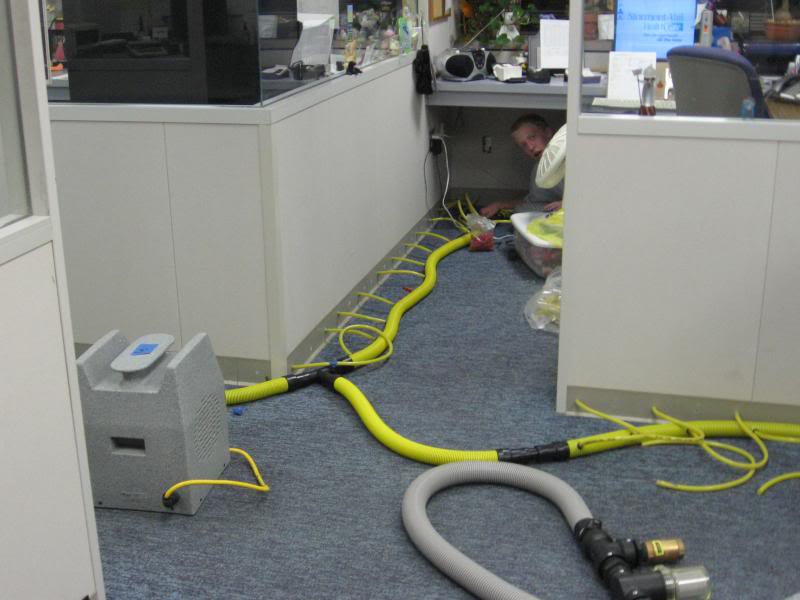

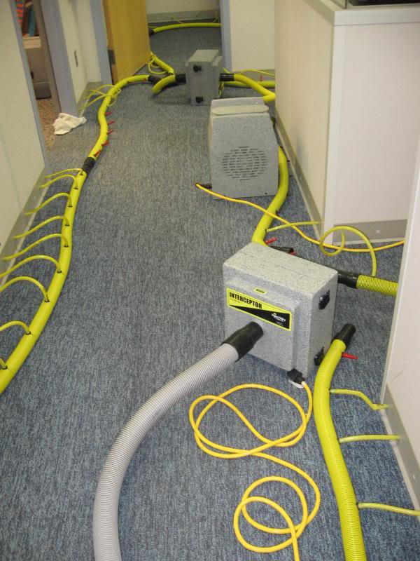

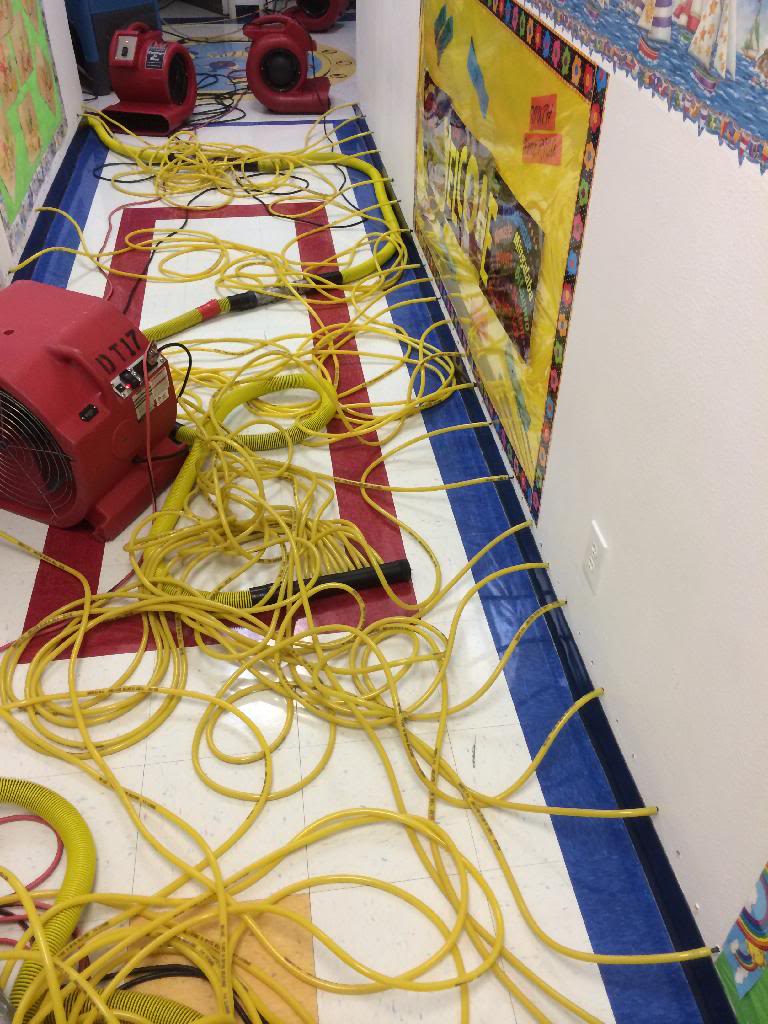

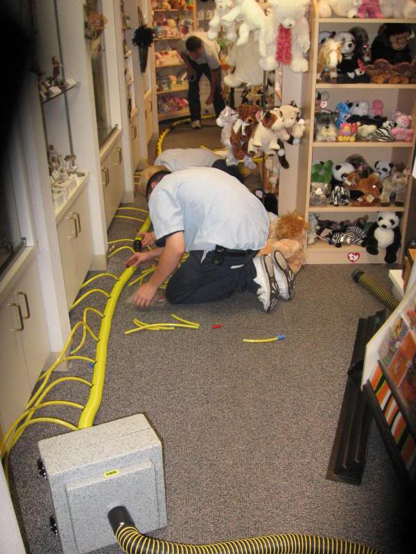

I don't like using injection wall units because of how chaotic they look while in use
hack...
and wtf wouldn't you pull the cove base and pop the holes there.............smh
but to answer your question, hack, here ya go
http://www.injectidry.com/activeh.htm
and cut the small hoses to a couple easily identifiable varied lengths and bundle them....or buy a few different color tubes and vary the cut by color and throw them in a tub..
no reason to have that cluster**** in the walkway

Problem with cutting hoses short like that is, then you have to try to guess with bags you will need for which jobs. In other words some bags will have the long hose manifolds and some will have the short manifolds.
I will say I like that injetidry setup better than our inter air for the reason that the whole hose is a manifold instead of trying to branch out 8 or 10 runs from a single foot wide manifold.
Reactions: TomKing
A planet far far away
That hose is cheap and they usually supply you with too much to begin with. Just cut two or three sizes like Fred mentioned.
If you don't want to buy different colors just lay them out and hit the ends with a little spray paint for fast recognition. We have a "close to the wall size", "a long size" and anything else we cut on the job.

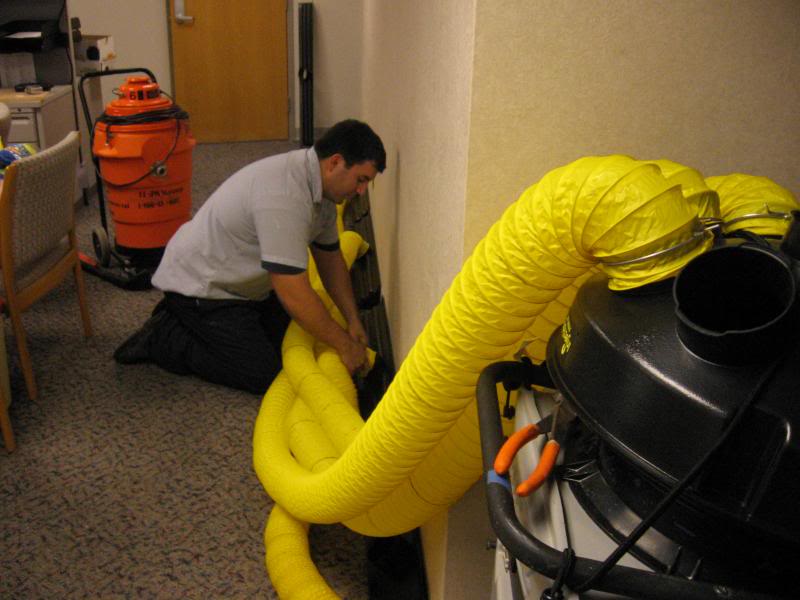

We will also use air scrubbers to put suction on walls that we think that could have some contamination inside. We don't recommend the facilities manager save walls with possible contamination but we are not the mold police. As long as its documented and they sign a "refusal of recommendations" then we will reluctantly dry them. By using the air scrubbers the processed air is filtered though the HEPA filter trapping any spores that could cause you problems in the air space. It's an option when they can't afford the down time for removal and replacement of potentially contaminated drywall. :neutral:

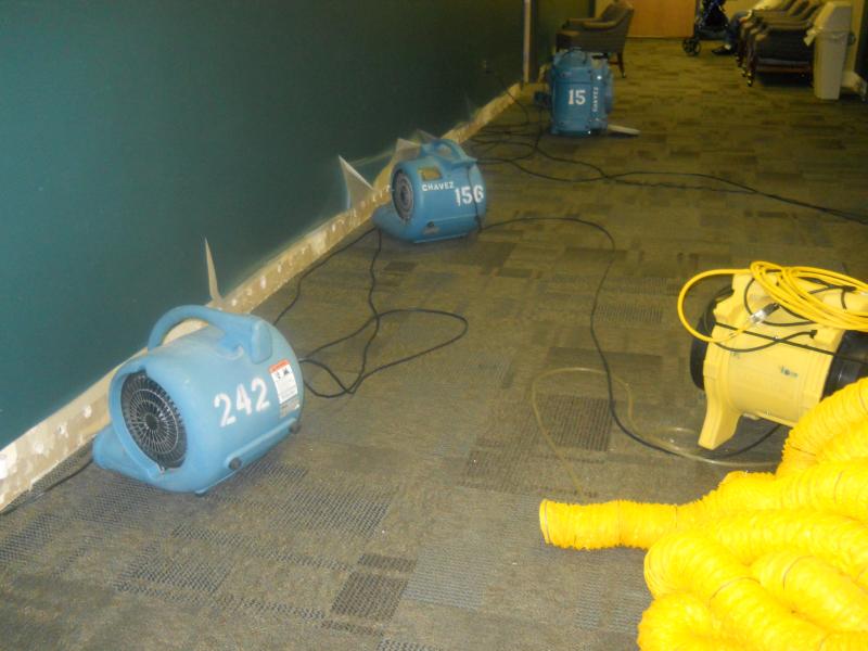

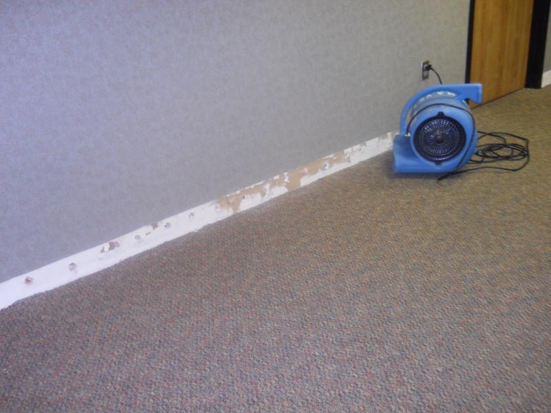

In certain situations/settings we pull base. In others if we pulled base or even drilled thru them during operating hours we would get fired in a heart beat.
I would prefer to remove base, the. Drill holes at base level. Only to come back after dry and reinstall base over holes but again, in some places this is not possible without repercussions job wise.
We maintain our water mitigation reputation by doing a lot of small things that maintain a business running with the least possible downtime or demo as possible. Customers like to see order as it gives reassurance in the product or service they are paying for. So for us, we provide a service with very little interruption ( not always possible, but if possible we do) to their business without compromising the structure or any of the safety of the inhabitants of the structure. And we are pretty good at it ( at least we are told)
As you dry clinics, hospitals, schools, some government offices, you will notice a need for this type of service. There are many ways to dry a structure and most of the time ( in commercial drying at least) working with your customer, who is worried about his or her customers, with a plan that is less intrusive by " mitigating the loss", you will earn a reputation as the go to guy to dry in certain circumstances and settings.
As always, if you imagine it was your house or your business and you dry it, imagining all aspects involved with the job, you will do an overall better job and the customer will be very satisfied and comfortable throughout the job.
But you still have to replace the cove base so why not remove it, I think it dries faster when you don't have the rubber barrier of the cove there . Lazy people !:stir::stir:
We will do what ever is best for the situation. Often its removing base, in this job we drilled through it and the hospitals ztaff removed and replced it as we confirmed it dry. It kept our crews drilling and drying so we could cover the large area we had affected. We do mitigation only no repairs or replacement to add to a bill. We wil also leave vinyl cove base inplace when drying walls with wall paper.
It been our experience that drying walls when the base is removed it can become tattered and torn fron the turbulence created from the airmovers. We had few issues when leaving it in tact.

I had temp of 80 degrees Grains in the low 30's. I hooked up a injection unit and moved the wall board from 30% moisture content to under 10% in 24 hours.
I doubt slow moving air would dry that fast.
Also you have to have 700fpm from your air mover to break the surface tension of the water and initiate evaporation. A slow moving air mover might not be enough fpm.
I get that you do not want to rip up wall paper.
I was just at Kurt Bolden's Commercial Drying Class. He said he cuts the lower part of the cove base off.
Lots of good examples at the Hydro Lab
