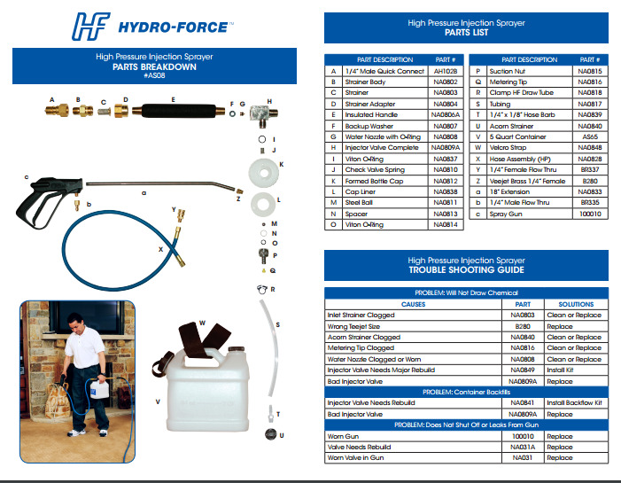

HydroForce is dropping pressure
117,251
Filter is not clogged.
If I take the sprayer out if the picture, the gun alone spray fine, hook it back and pressure drops in half but is still drawing chem.

Check the dema valve, check that the small hole in cap is clear.

Do you get bubbles while spraying with chemical? A small hole or crack in tube will cause pressure drop.
The pressure is supposed to drop significantly when hooked through the actual HF. From about 400 psi through your line to 120 or so out of the jet.
I'm guessing you know that, though.

Can get those dema blocks at dultmeiers. Of course they won't have that hydroforce brand name stamped on them : )

It was on your other sprayers. What makes you think the hydroforce would be ok?
