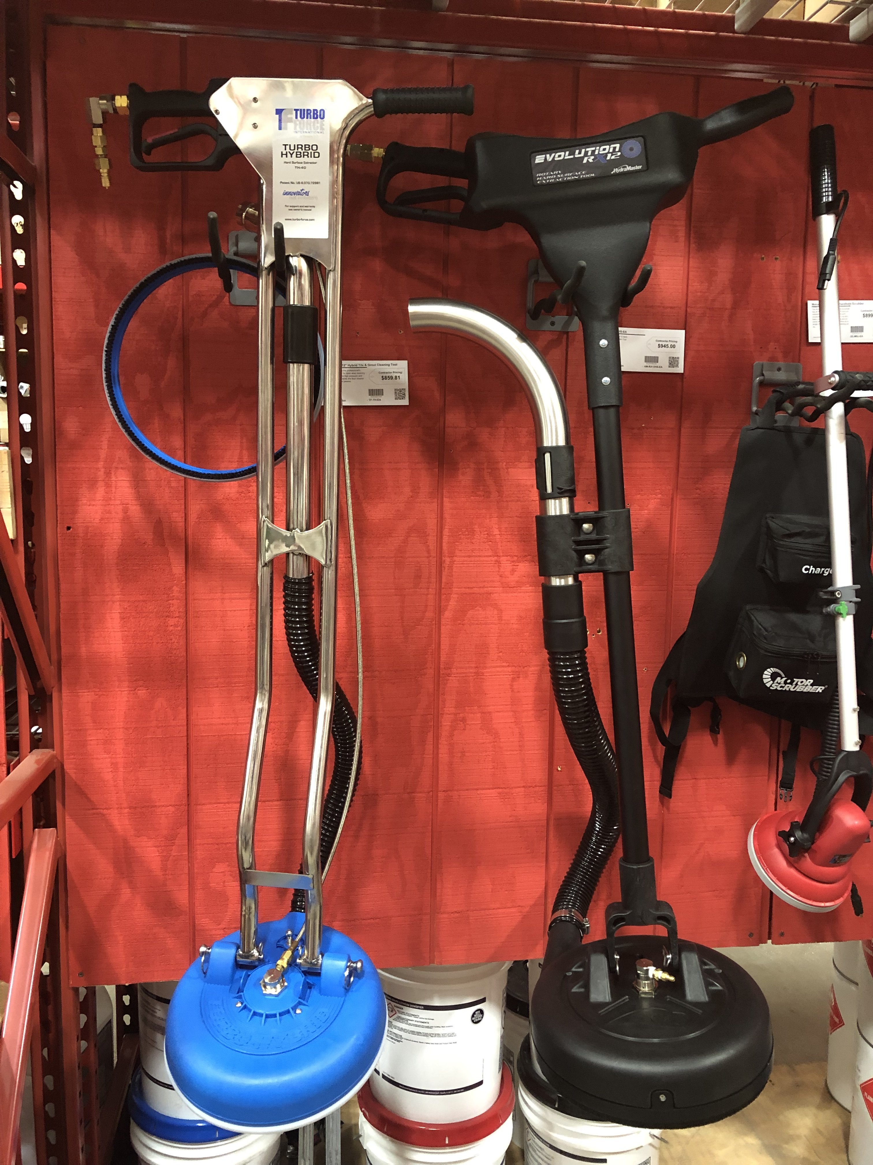

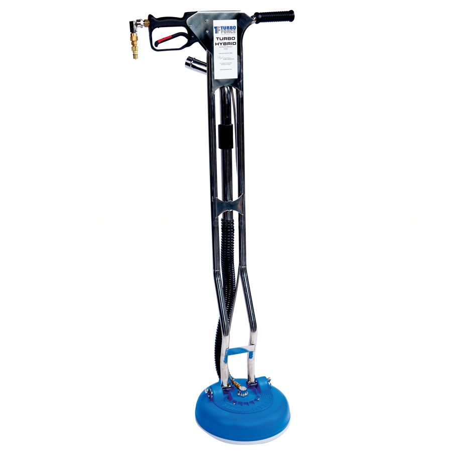

Exactly my remark to them on their youtube video...the brush idea sucks, the vacuum with slots suck (literally), and the "plastic" non-Teflon glide sucks...Not only that it looks bulky and heavy...I mean, why aren't they sending these tools to critique to people who use them every day? Step 1, study a turbo hybrid?
Side Note:
BTW turbo hybrid needs to make the mold for the Teflon boot (notches) that hold it to the tool better quality...

HydraMaster started the spinner tools and had a huge time advantage to take the RX 20 and lighten it or a light version of it that would compete with the turbo and the 360i. This is a bad knock off to the turbo tool and makes the problems with the turbo spinner worse by putting the spinning jets even further from the edge. Hoping that in the future, before they go into production with new tools, they get input from experienced users.

Honestly, Bob, your spot on! Speaking to Mark Markovic alone gets the right designed tool...LOL...

Looks like the one Markovic scrapped
