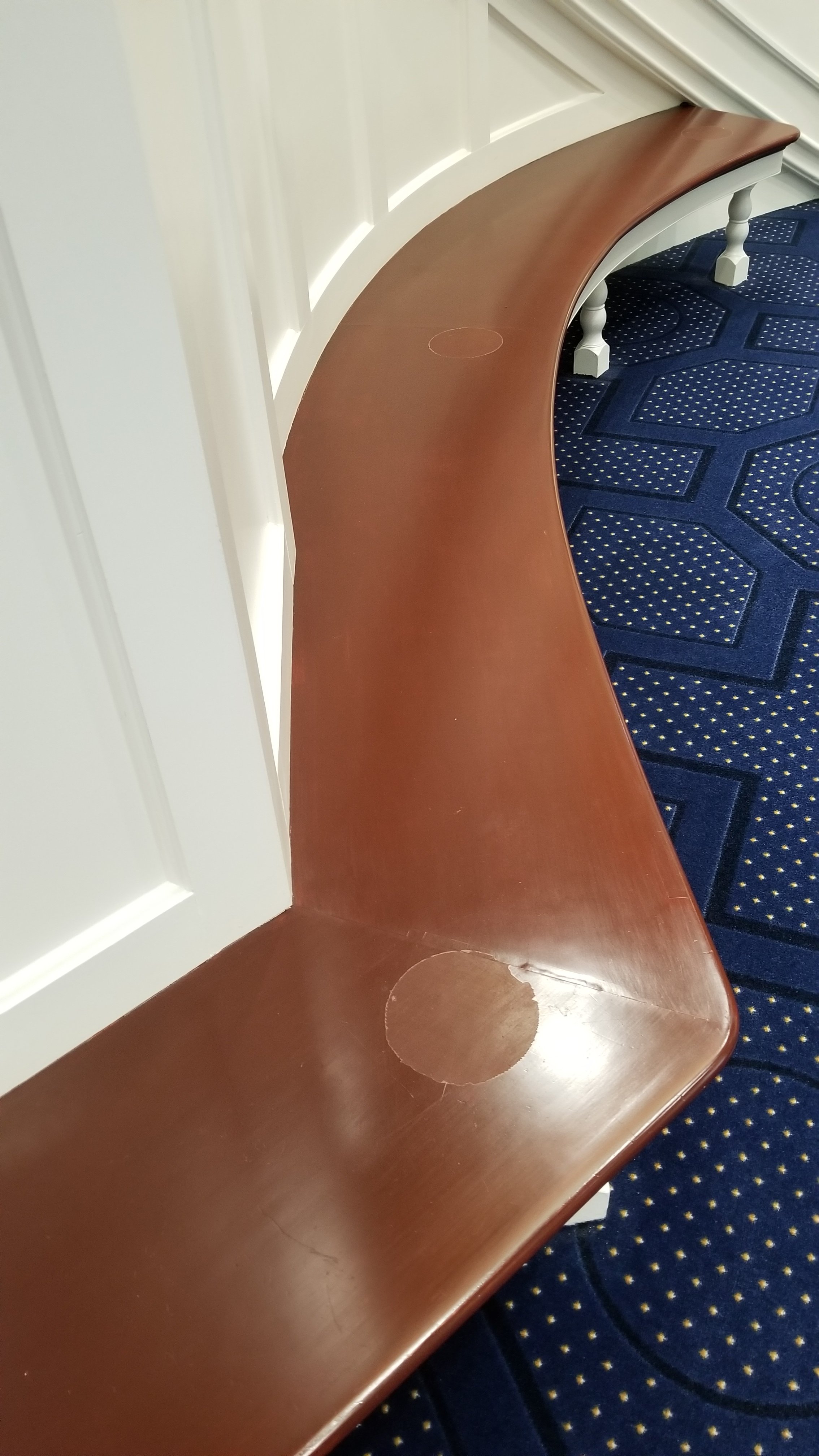

We took up 300 stickers in the Union alone. Very little residue. Sprayed a dlimoene product on it and no problems.
One did have issue in the other building with some put on a wood bench but it was more the custodians fault. He just pulled them off, taking off the finish and then called me to tell me.
We used a heat gun, warmed them up and they peeled right off the wood, no issues.

Had he heated up the sticker she would have peeled off fine. It was the only casualty of war.

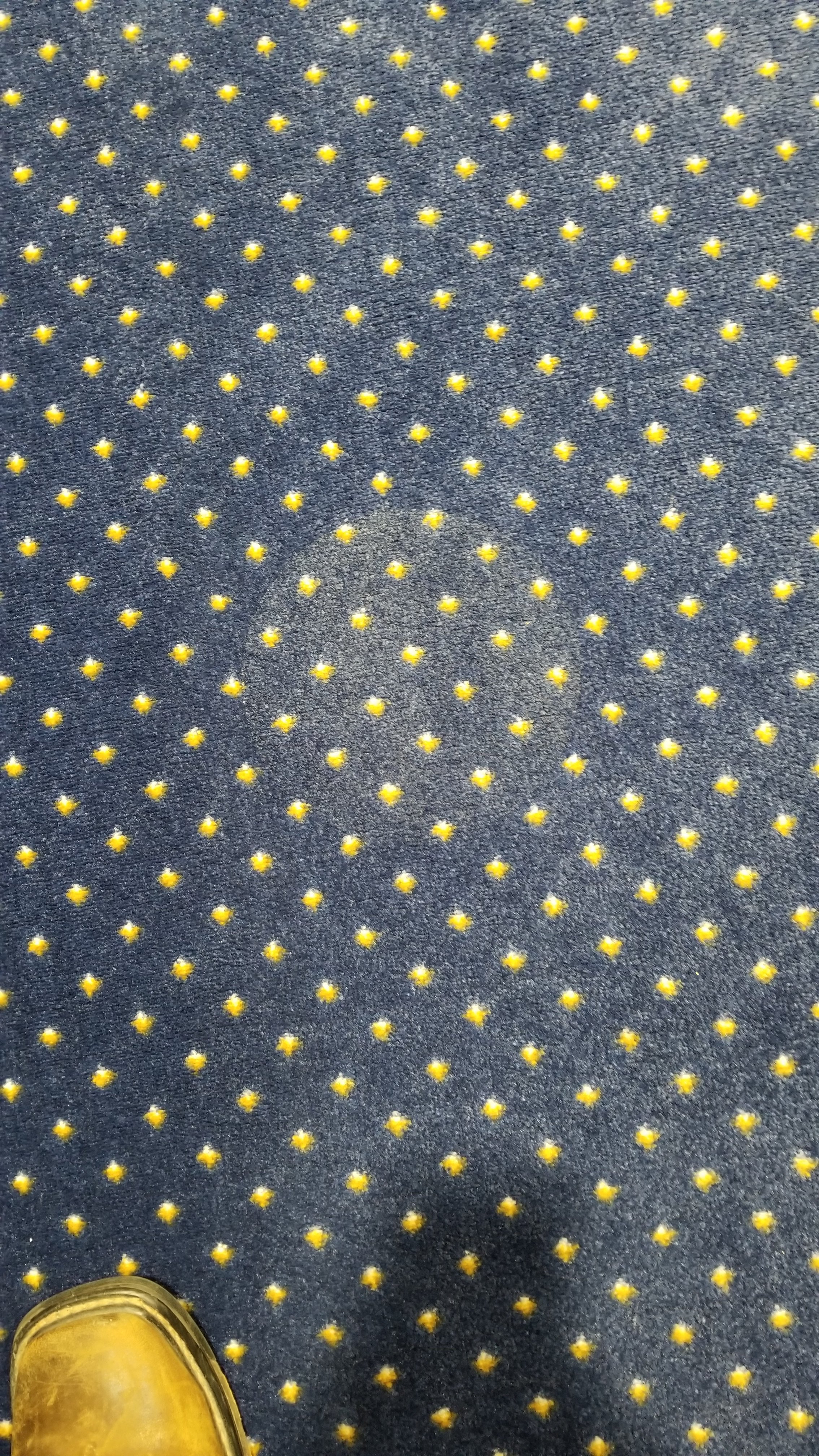

This is the question that brought me here. While I believe d’limonene will do the job I’m apprehensive to leave the “cleaner than the rest of the carpet streak” down the middle of the school hall carpet. School has warm water and uses everyday cleaners as pre-spray. The machine is an EDIC private label portable. I believe the results will be predictable

Here is where one was. Not sticky and hasn't resoiled in the last month. Still doing good so far. Although it did kinda crush the fibers down, hopefully it lifts back up with vacuuming and cleaning.
