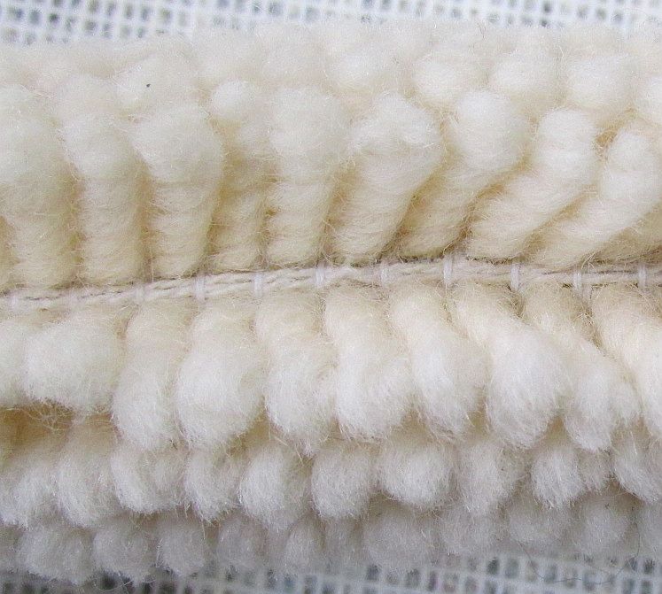

This is the most basic way to tell if a canvas backed rug is loomed or tufted. Grin the rug and see if the nap breaks open in even rows. (Left side) You'll see the weaving construction at the base of the fiber. (Right side) Hand tufted rugs won't break in even lines.
The reason these are worse than tufteds is that high rows in the weaving may not be encapsulated with latex and will fall out in use, with vacuuming, and especially in cleaning.

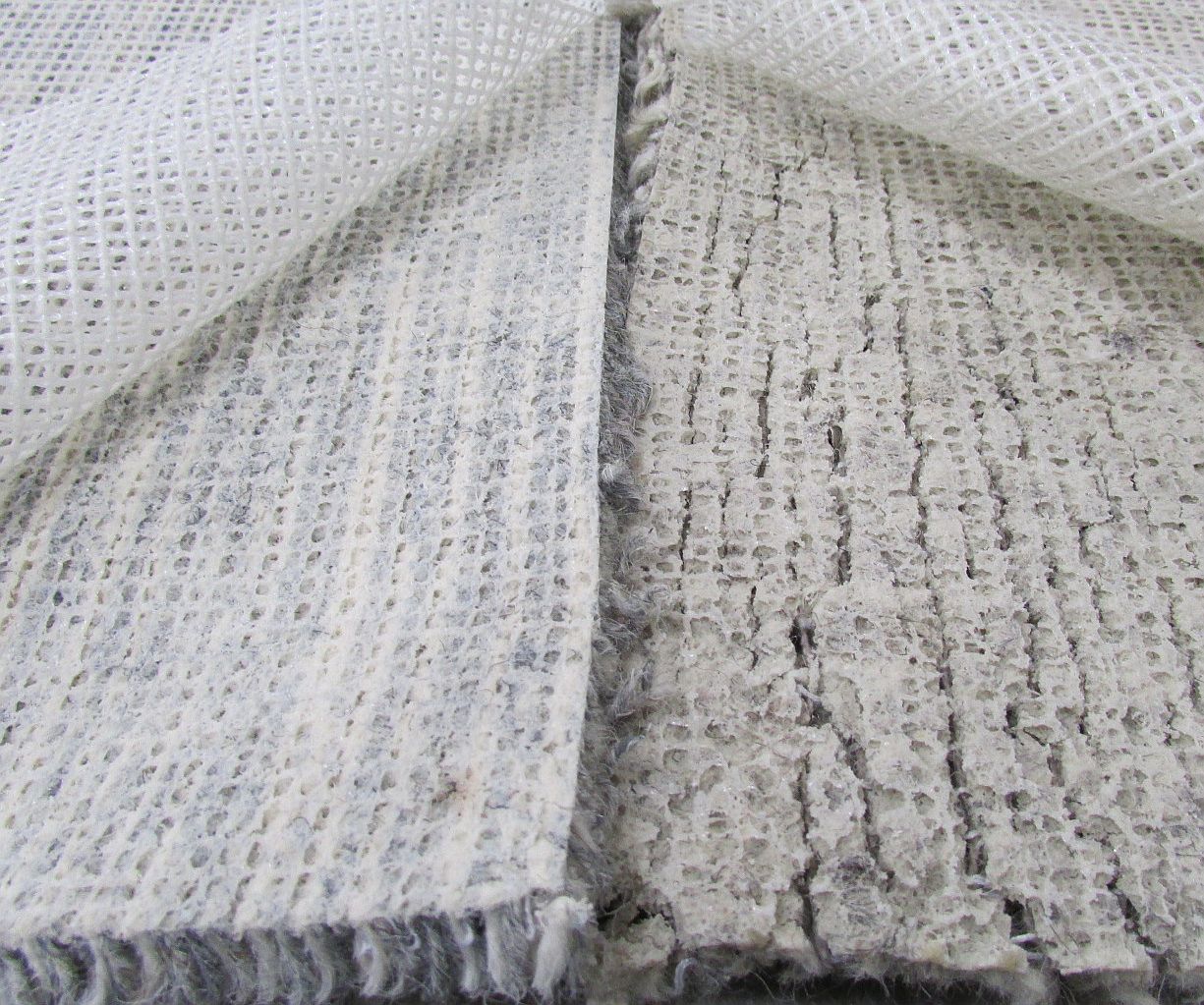

Is there a way to tell if a tufted rug is machine made vs. hand made if you are able to peel back the latex coated canvas. I would think machine would be really uniform.

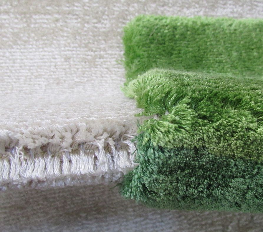

The hand loomed copy of high-end machine tufted carpet uses a similar poly mesh backing, but low quality latex. We've seen these fail in less than one year of use.
Can you tell which is high-end machine tufted vs. woven copy?
No need to peel off the backing though. Grin the carpet the same way as a hand-tufted. You'll see the woven structure at the base of the nap.
The difference between the machine tufted backing above and the hand tufted backing is pretty easy. A hand tufted will typically have a canvas back that comes in several colors and will have a 2 inch wide folded cloth or strap trim.
The picture under Pics? shows two rugs that have the typical hand tufted canvas backing, and most would call them both hand tufted. The hand loomed (woven) copy of a hand tufted rug will look identical from the back and face, so grinning the rug is important to tell the difference.

Is there a way to tell if a tufted rug is machine made bs hand made if you are able to peel back the latex coated canvas. I would think machine would be really uniform.
I dont think it matters. the latex will hold the weft/warp yarns of the primary backing in place.
