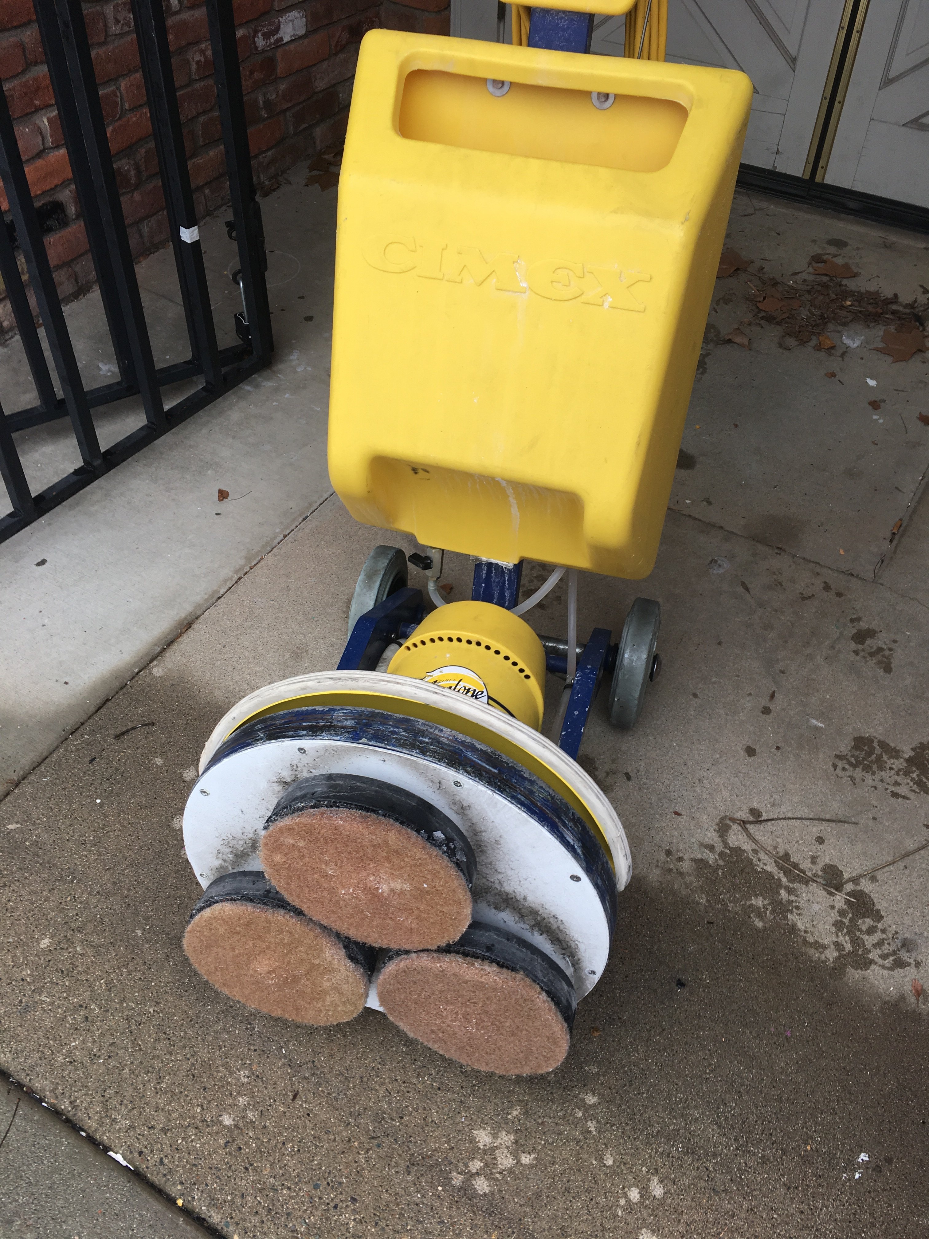

I should clarify, I flip them after the first tank and change them after the second. Using the grey pads. They seem to wear down quickly. I used one set last week and they were worn out after the first tank. It depends on the type of carpet. Maybe some products provide more lubrication. I haven't tried releasit yet.
27,970
For example, I recently did 17 hallways between 500-600 sqft. I could do 3 hallways on one tank. Flip the pads and do 3 more, then they are pretty worn out.
27,970
Must be clean carpet.
I average 1 gallon per 150 ft or so with the Cimex
So that's 900 sqft. Maybe I'm not using enough solution. I do seem to get good coverage though. The hallways weren't heavily soiled but had been protected during construction, leaving clean carpet under the plastic and soiled carpet on the other side. We had to even it out. Came out great. Still learning the Cimex so any input is welcome.
