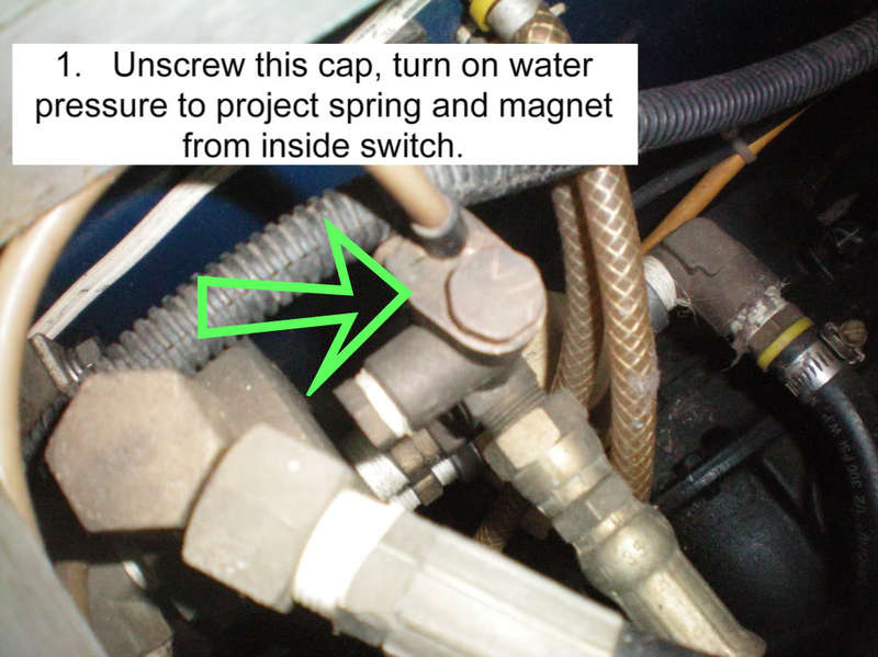

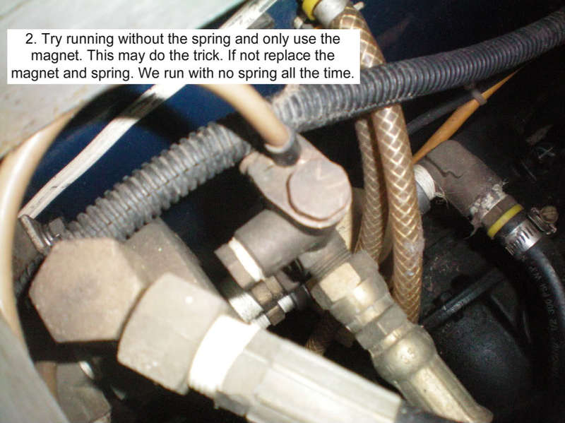

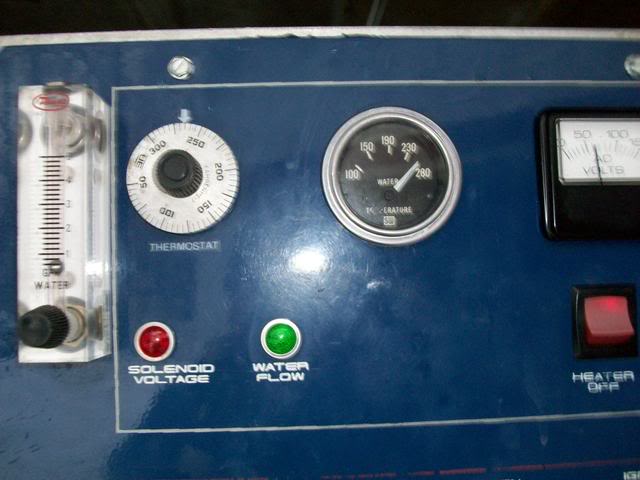

Used the Steamway Powermatic 2100 today for just the 2nd time other than warming it up in the parking lot.
First time I used it it was popping sizzling heat in the 250º arena.
Today it would not budge above 170 º.
The burner is firing with every trigger pull.
The Kero tank is full.
The thermostat will shut off the burner up til 150º but from there it stay on as well as as the red solenoid light.
Unit as only 64 hours on it.
I have not messed with anything other than oil changes and a 2.5 conversion.
500 psi with a 04 or 020 wand yields the same results.
meAt's first guess is that it needs to be descaled.
Olson's in the thermostat has gone bad.
I'm hoping it's bad fuel. I did buy new stuff since the last (successful ) time I used it and the kero is not as clear as meAt says it should be.
I'll try Diesel in it tomorrow.
If that ain't it I'll descale it next week.
Any more guesses?
