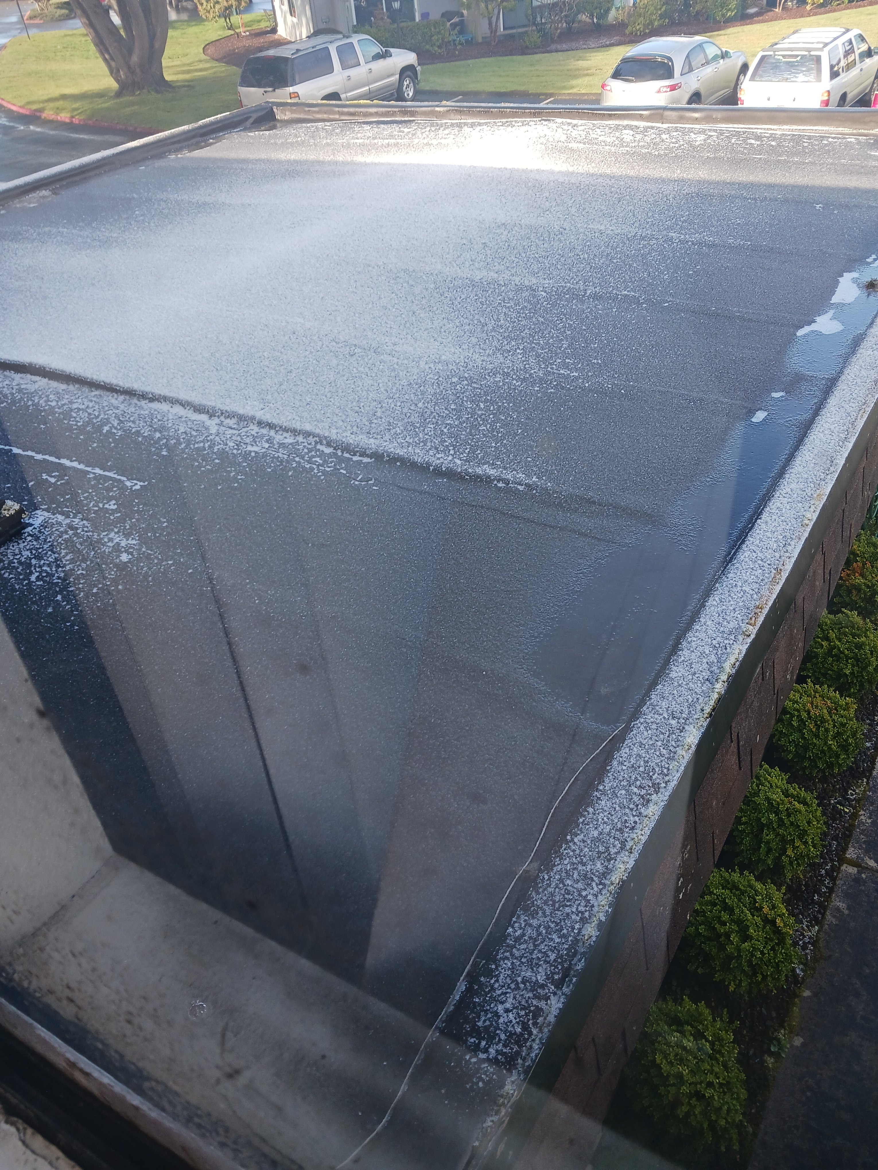

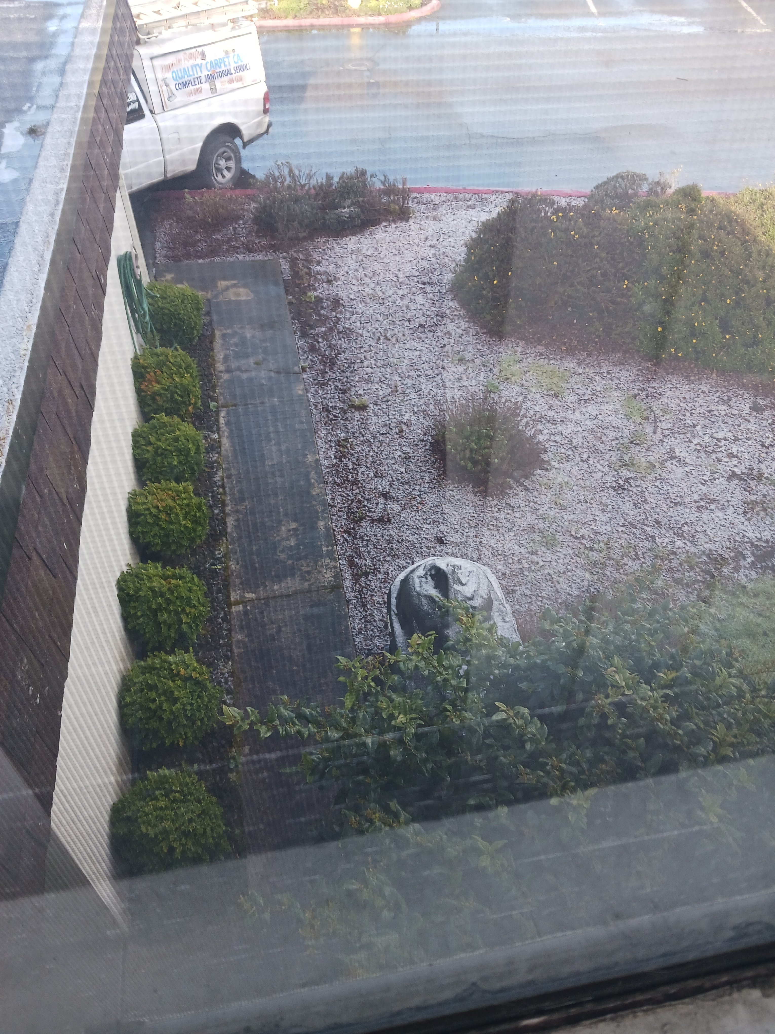

Thanks for checking yes I did just light snow on the vans nothing I know of happened lol
Cool, but if it drops much more consider a heater, when i put um in i used the ceramic heaters or the big oil filled radiant heat ones i stayed away from the ones with the glowing heating elements because of the possibility of 🔥 but at 32° a blanket should be fine. Got a little cold here last night and im within sight of the ocean
