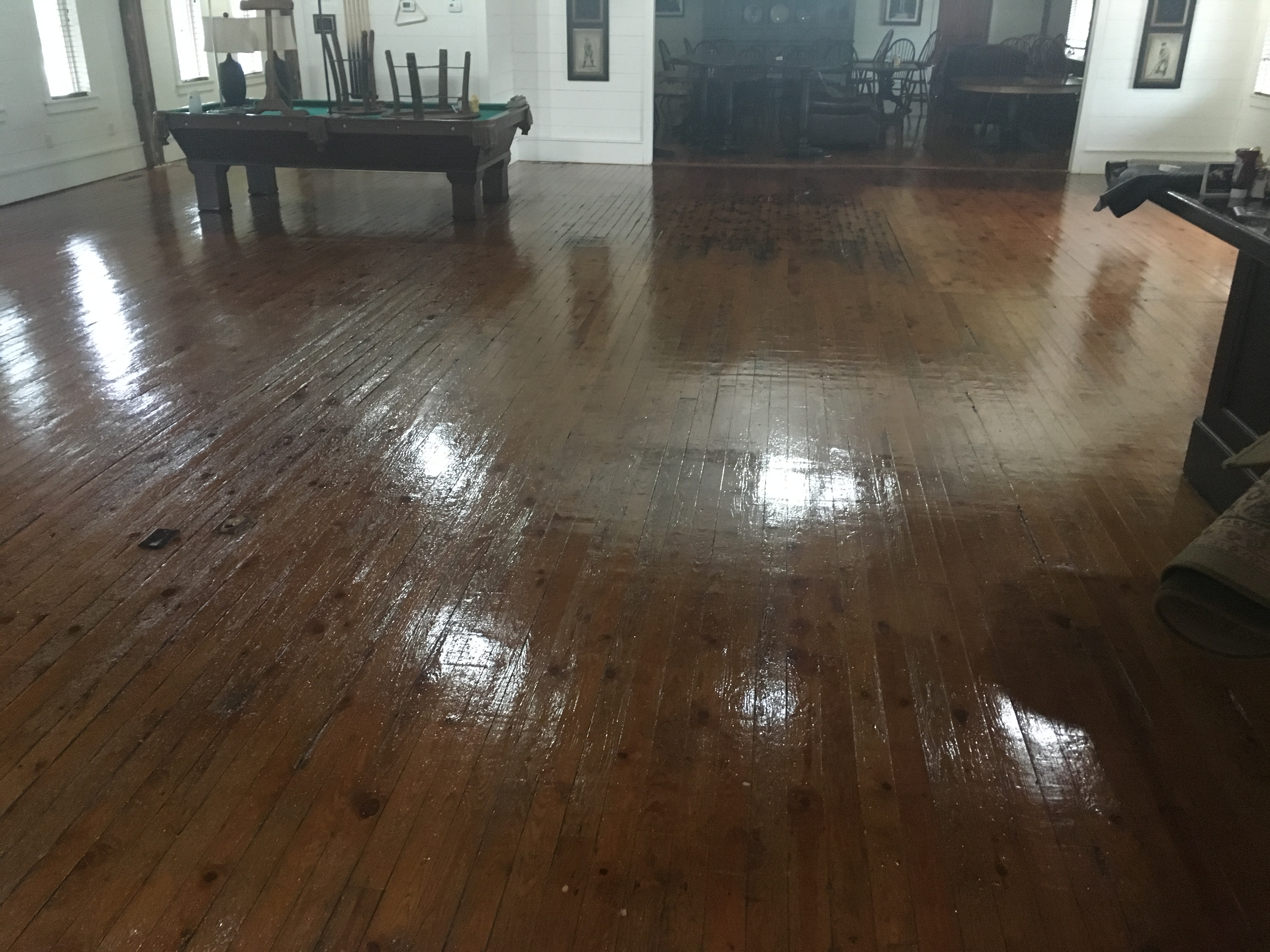

I just did a 2600sq ft restaraunt dining room and had to add an extra step with a mist spray of heavy duty chemical to break up the mop water kitchen grease with a red pad before I used the machine to get as much cleaned as I could and it did wonders without overwetting and it made the floor so much drier than any tile wand would’ve ever done. I’ll attach before after pics in the next post
14,255

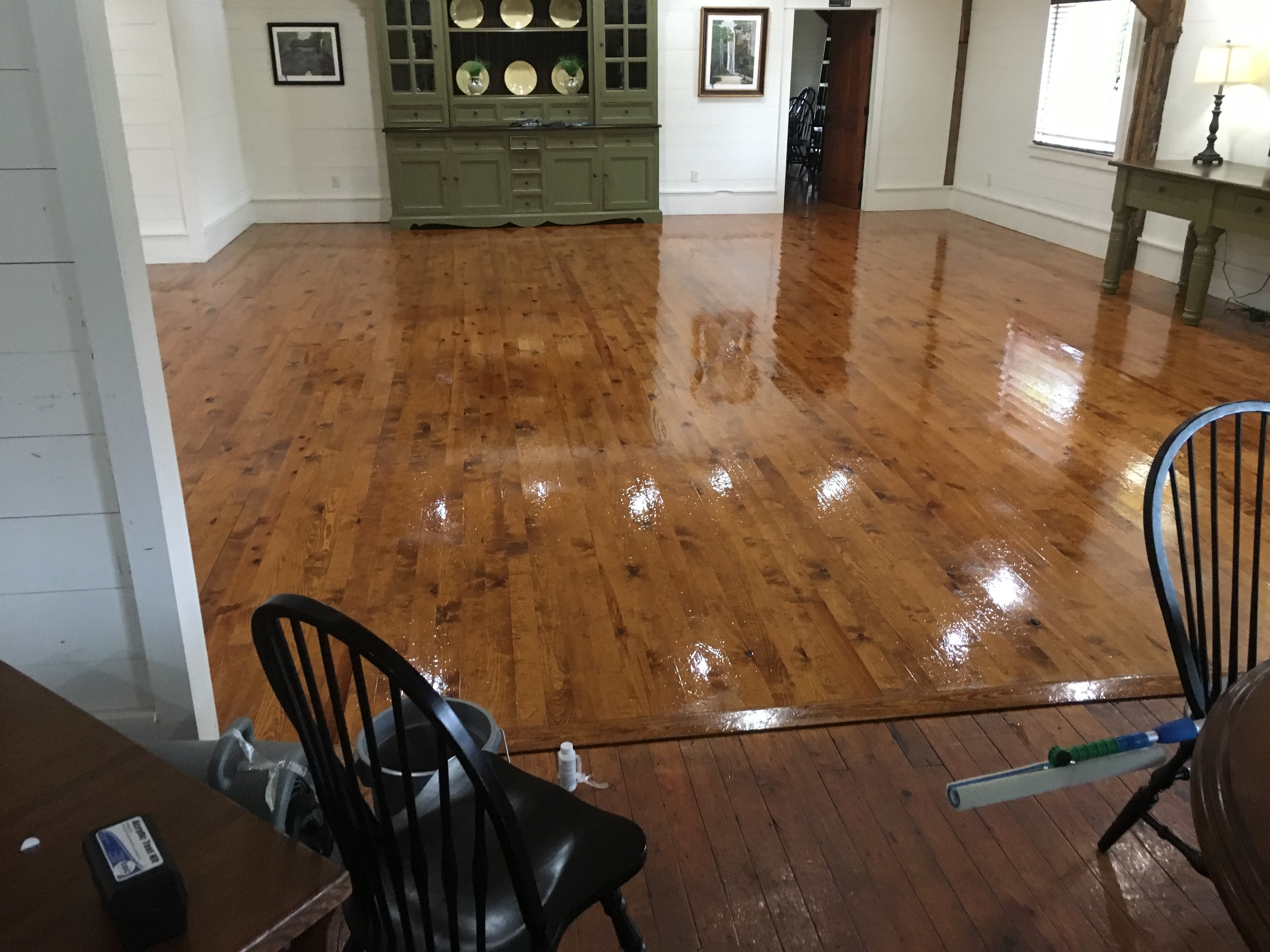

This was just two coats
BF97D4AB-C6A2-43FA-BCC2-8023FE1B4E06.jpeg 7451C89D-3CE4-4D57-9D7D-D40446080C2D.jpeg

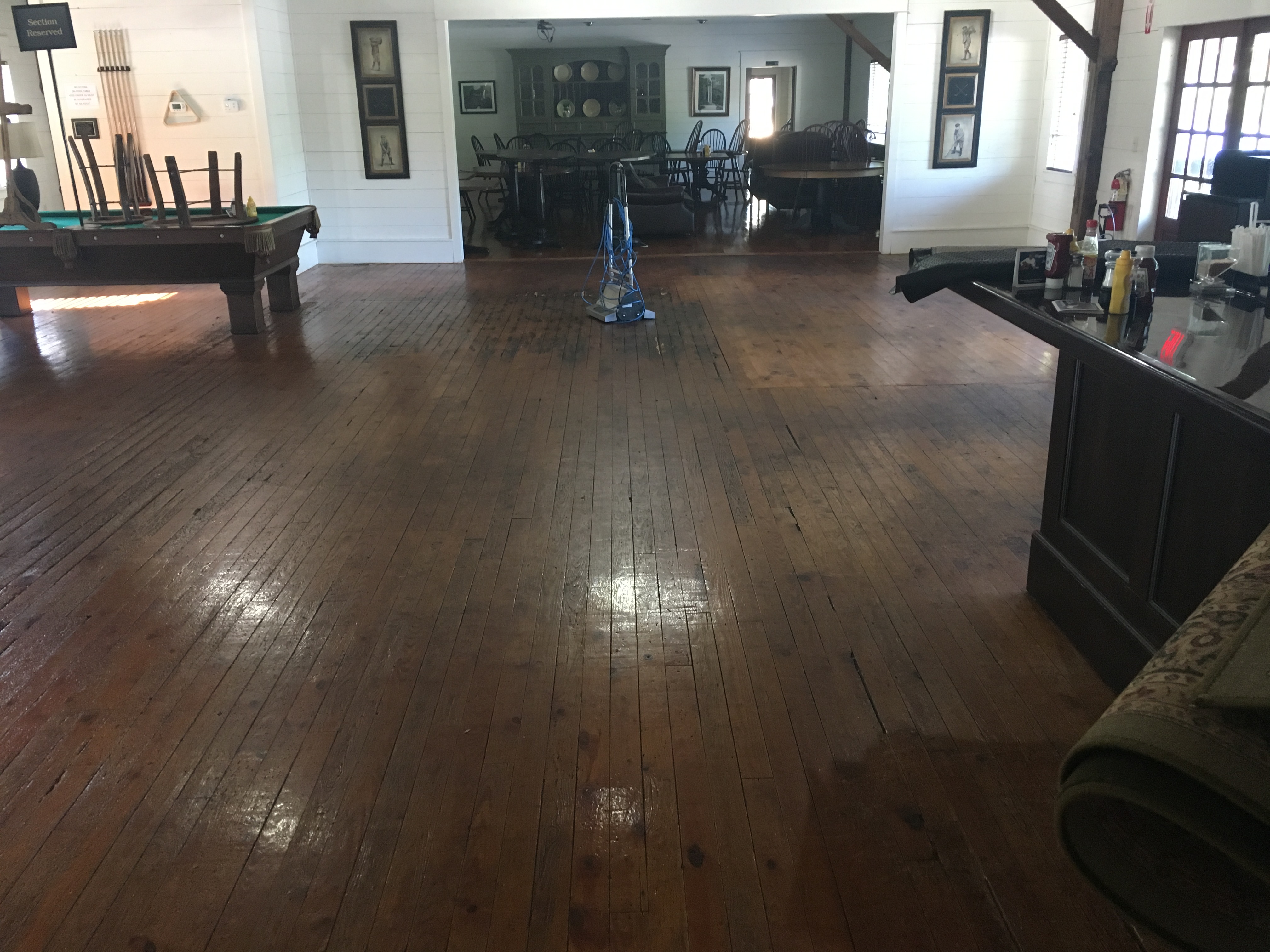

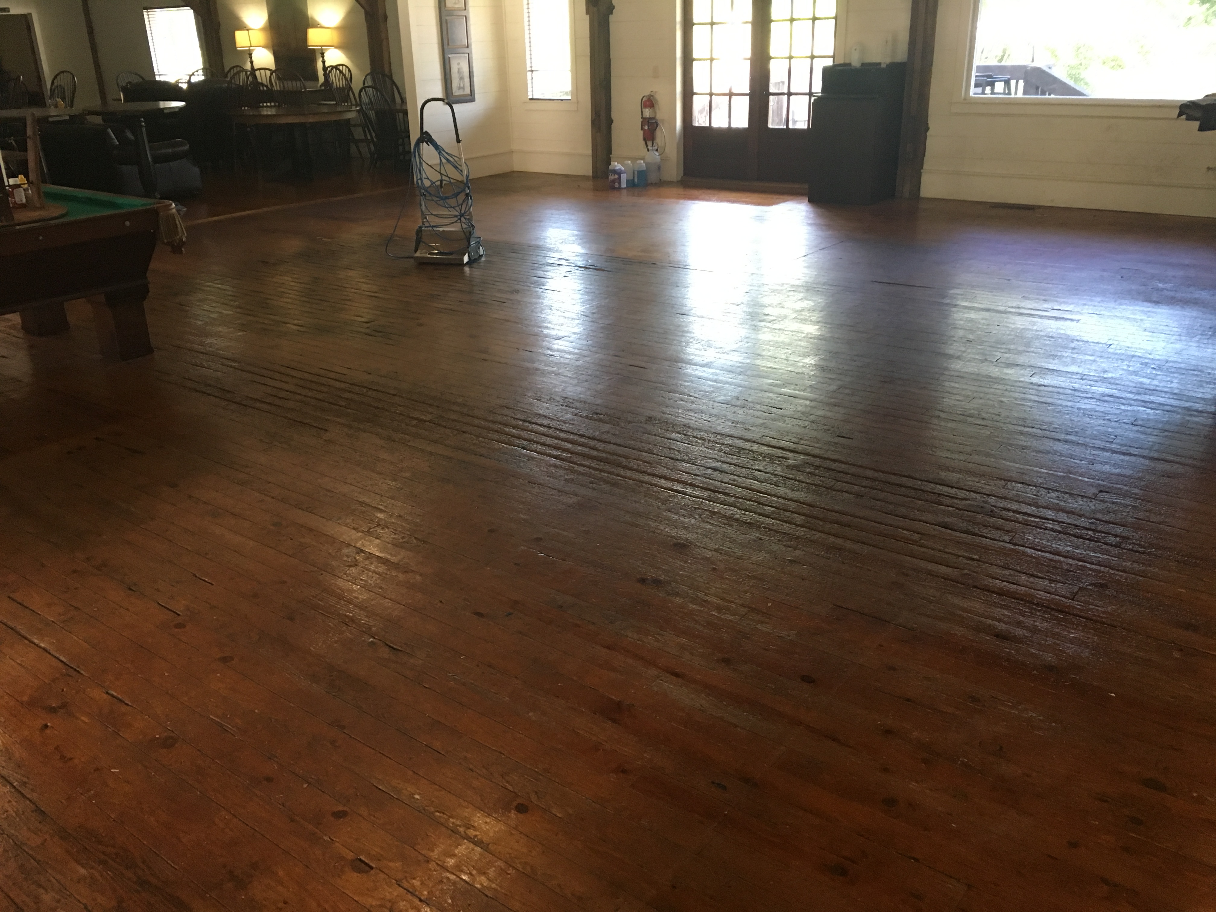

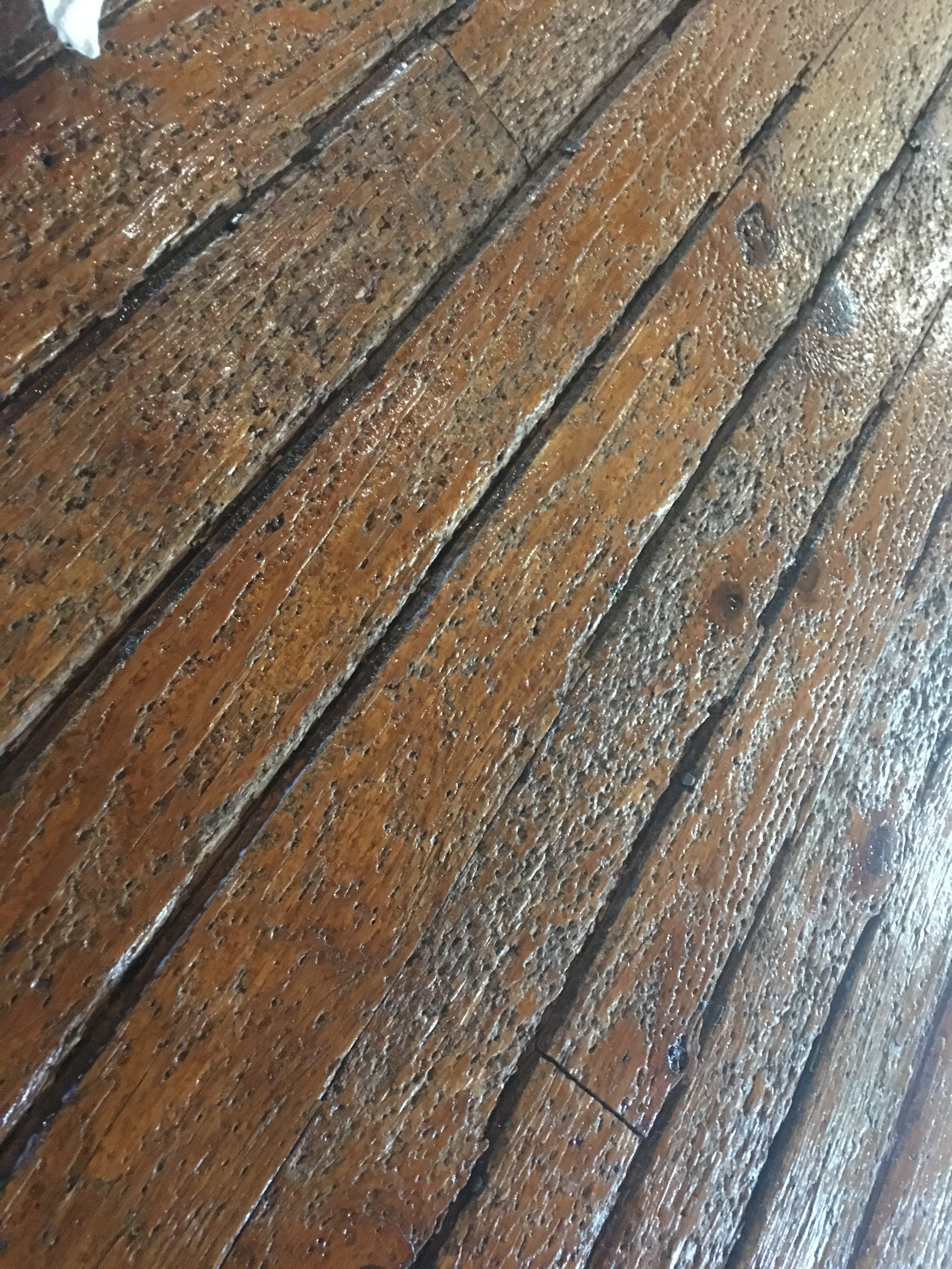

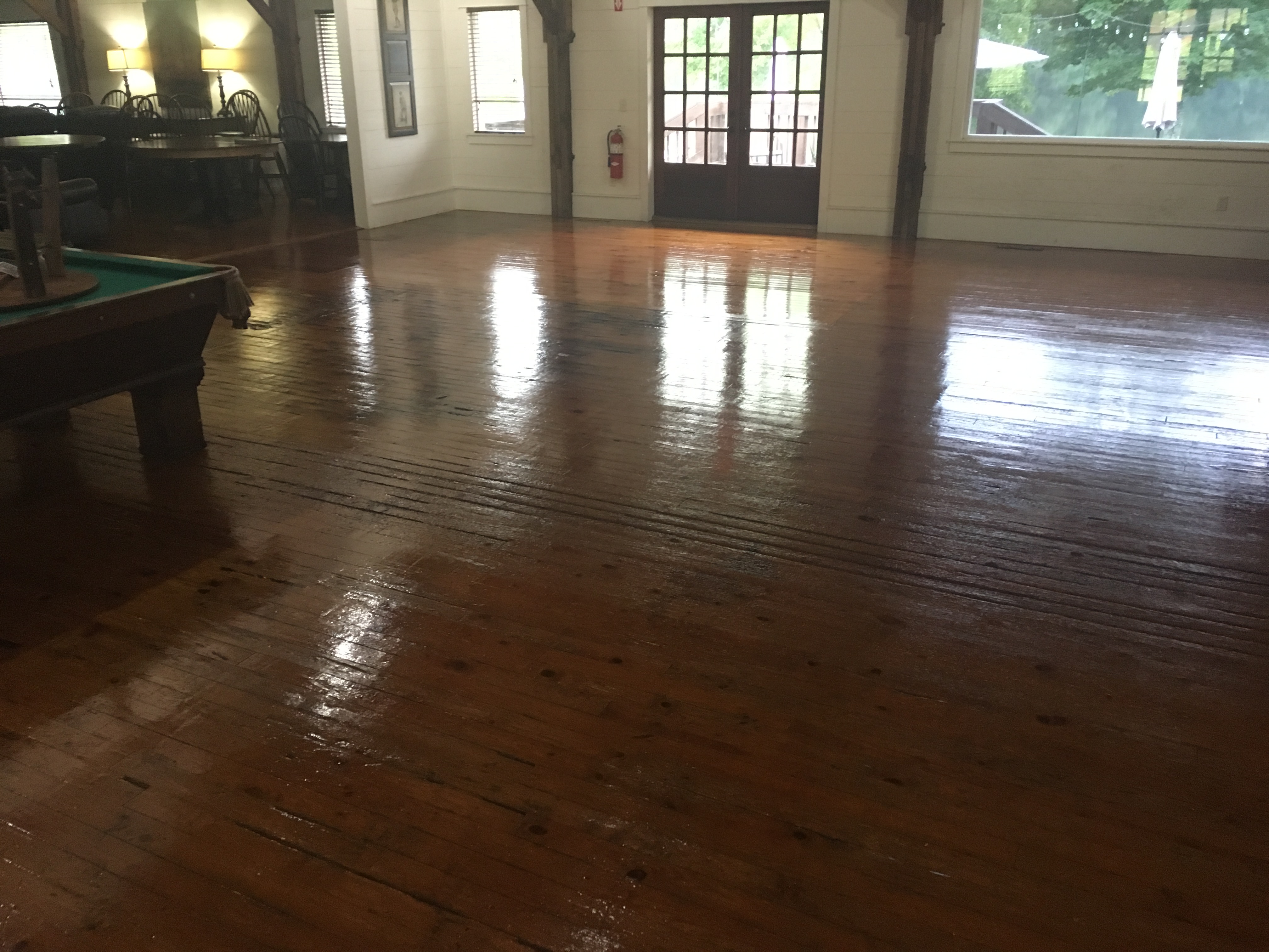

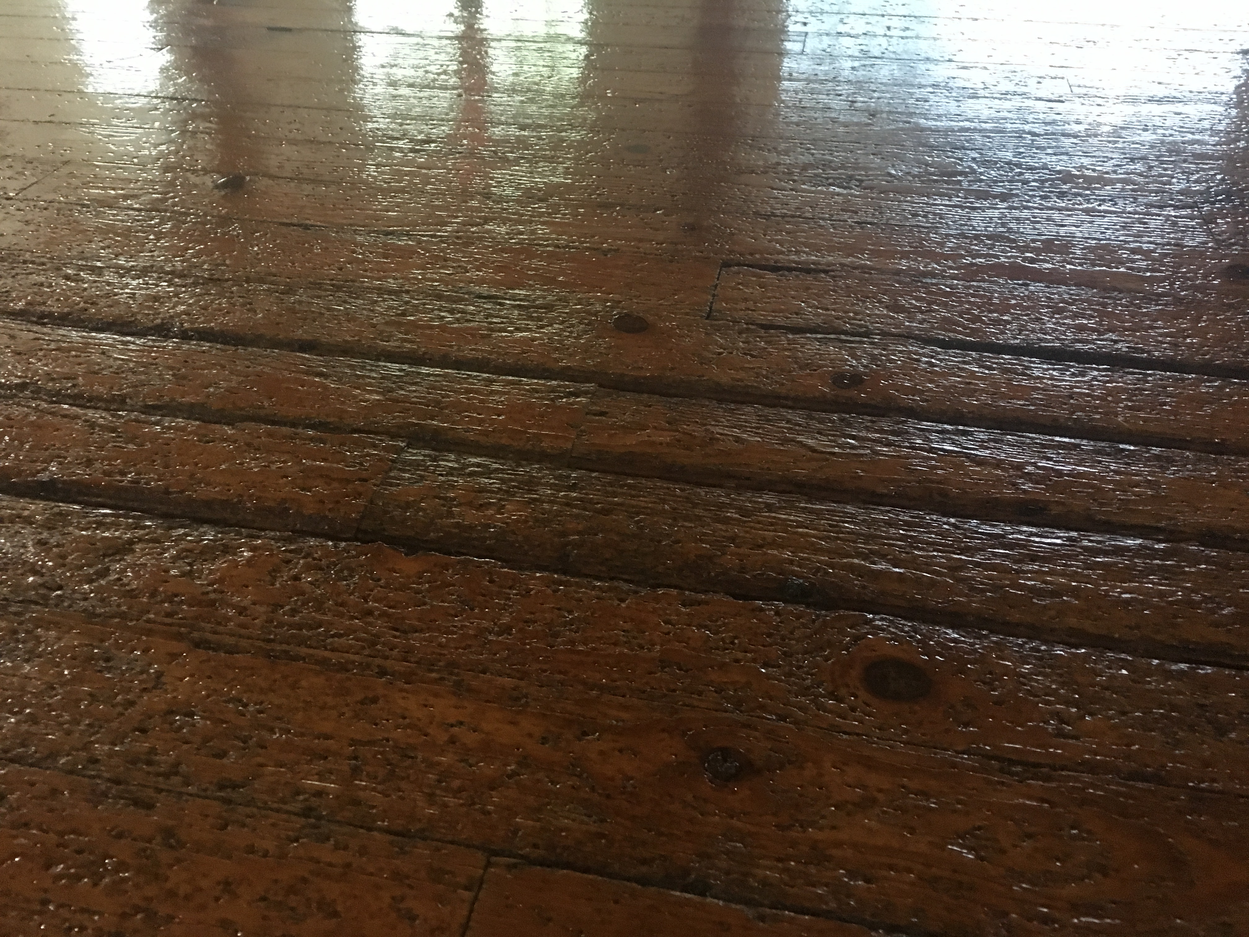

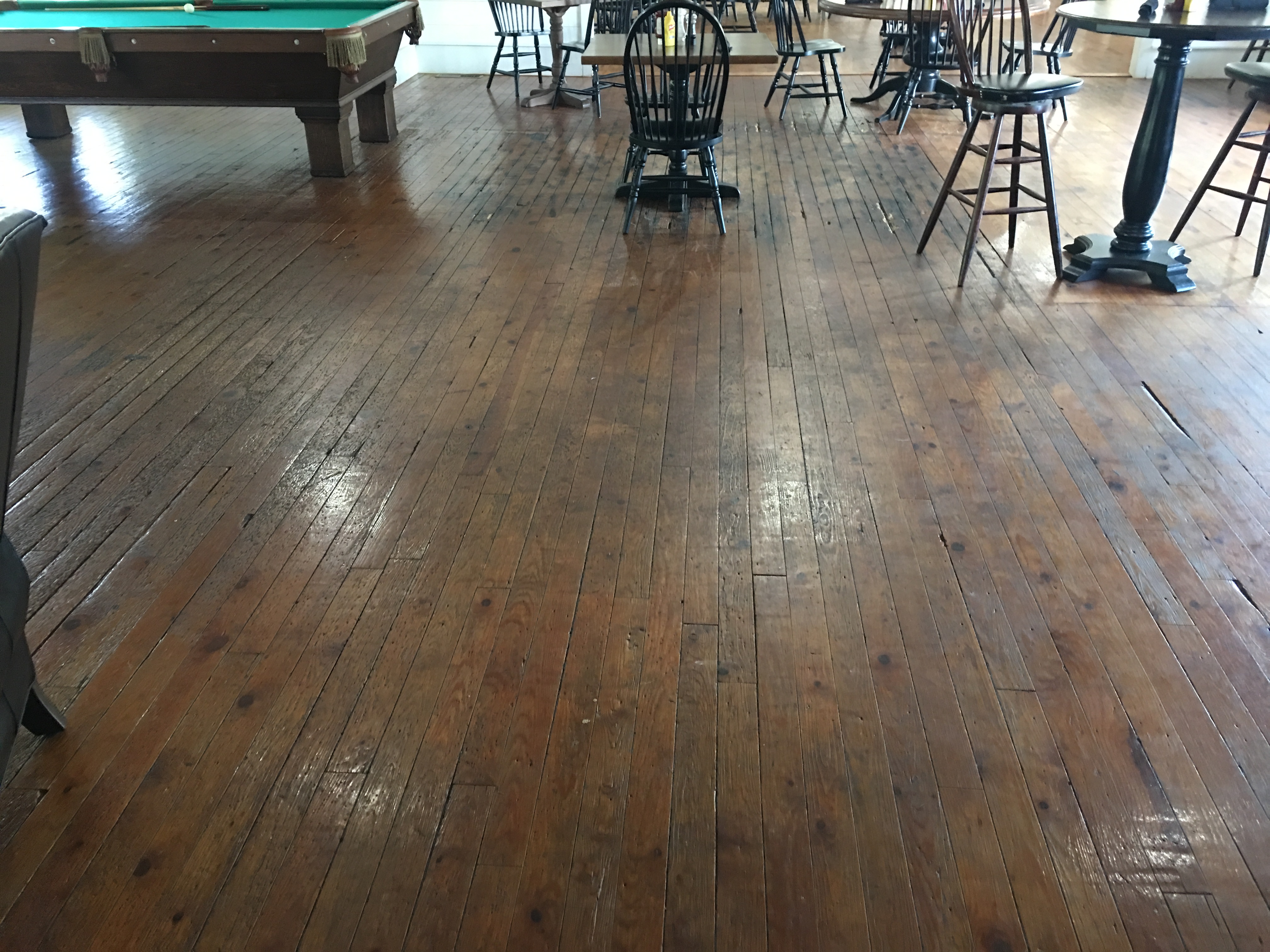

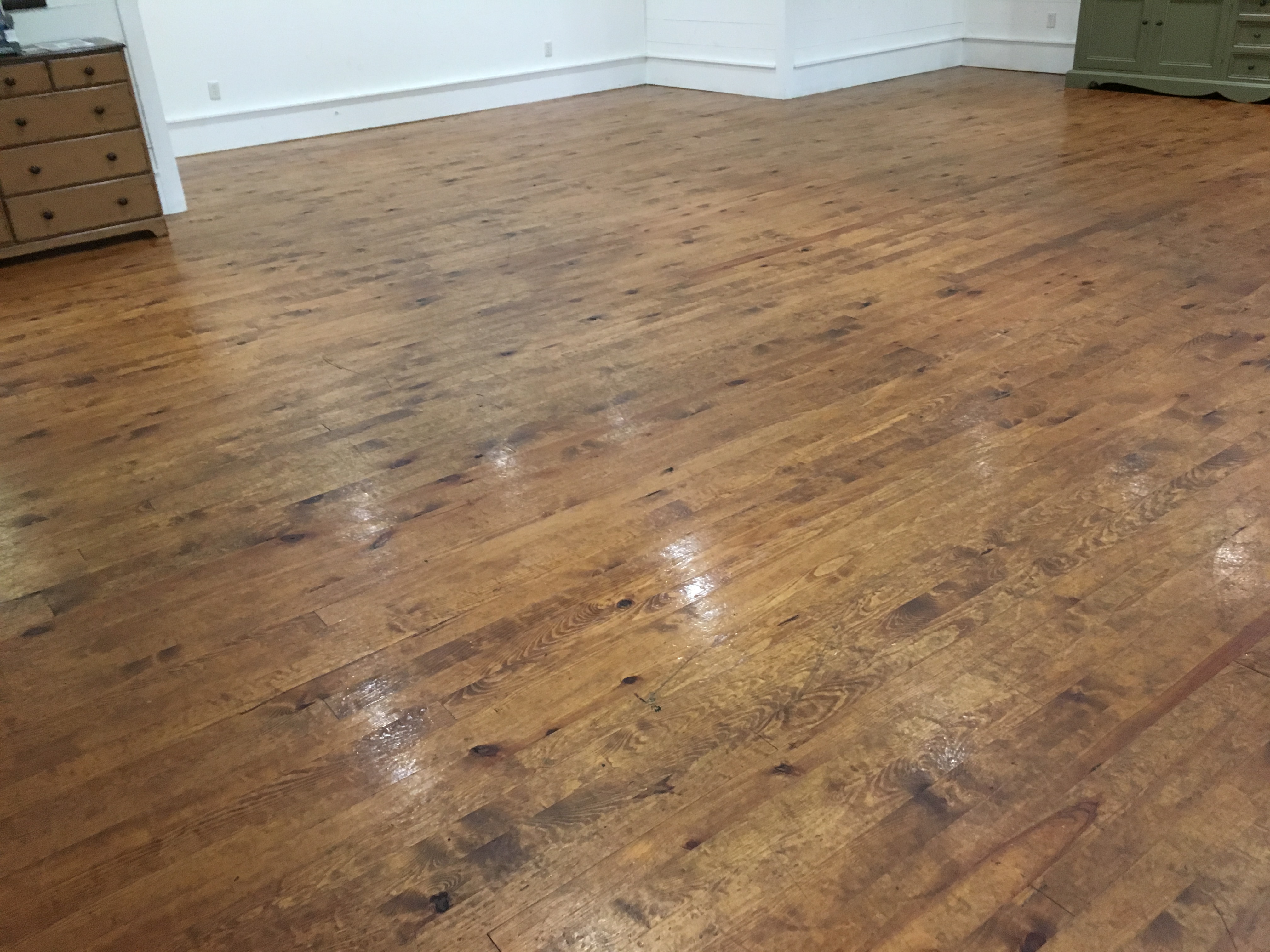

I had to work to preserve this damaged floor from golfers metal cleats in the 50s that they wanted to stay that way. The first 3 are before. I had to dry crb it to get the sand out fromnin the big gaps
And I was also told from one of Basic Coating’s chemists that you Can use Streetshoe in place of minwax polyurethane on bare wood if the need arises to avoid the dangerous VOC and has a much quicker cure time. You’d just need to do 4 instead of 2 coats
So that’s my feedback on the process of preserving hardwood floors.
BB7E3C46-EA0E-40C9-ADD9-4108F4991AAD.jpeg 15F5EA9D-56D9-4CD2-80E3-2607C68E4966.jpeg E00A0083-A60E-41D2-B8B4-68BF028A136E.jpeg AAF35F34-A34A-4427-AF34-38E62D55D47F.jpeg 6F377BE5-68B9-4B1C-8E5F-D1FF7845E2B7.jpeg 4E2DB251-8779-48D3-90B8-895F21DF7C20.jpeg B779520A-E7AE-4107-A71E-1A539192660C.jpeg

Keep in mind, all those after pictures are 24hrs later after it's dried. Just to answer the question if that was a wet picture. Nope.

Matt on that heavily worn floor a T Bar applicator would have filled up all those voids creating a big mess. Some times less is more.
I agree. And I saw it fill in those gaps. I went behind those areas with a dry rag to absorb the puddles.
