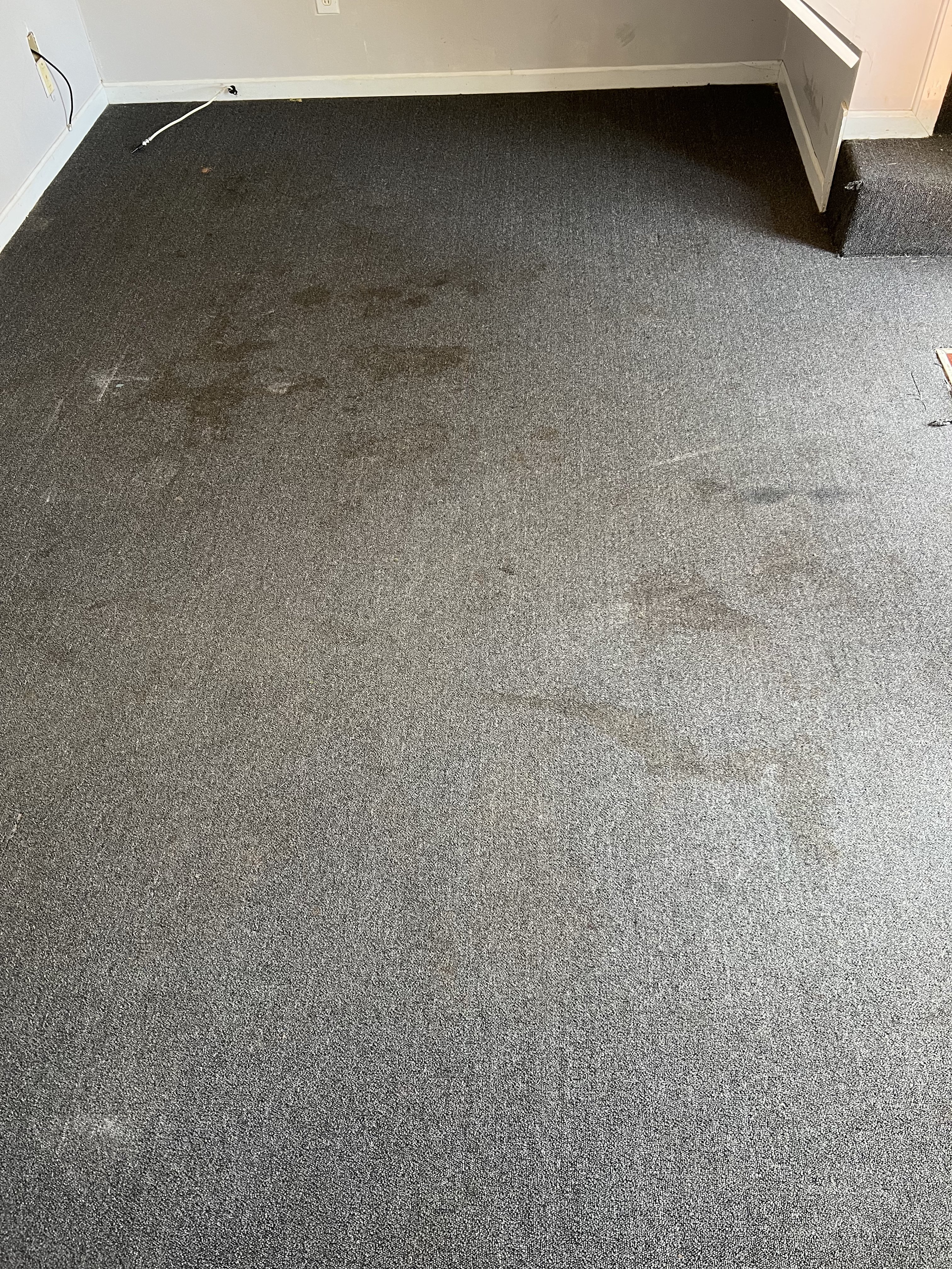

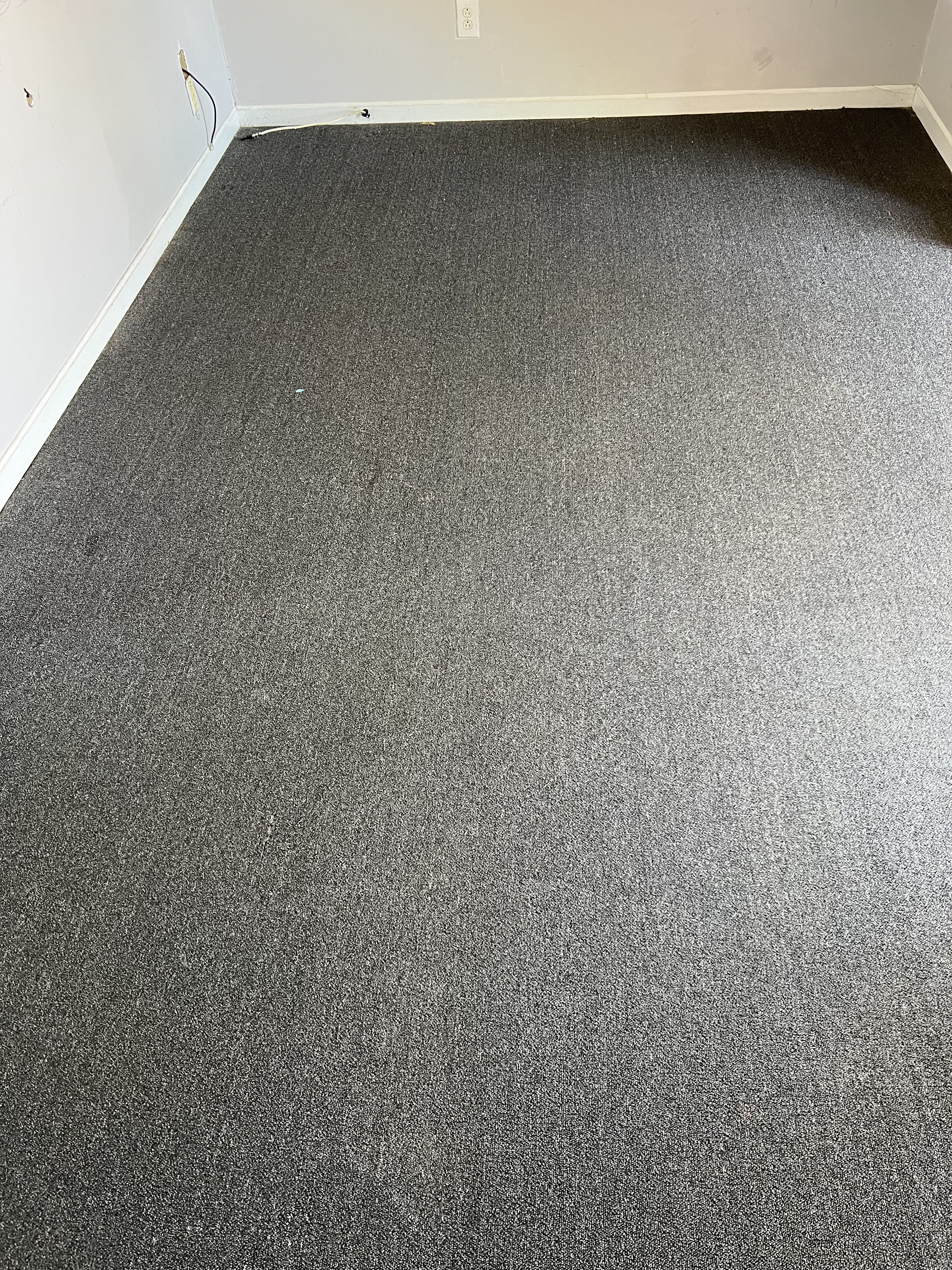

The naysayers will eventually bash your results. Looks good.Before and after pics from one of the apartments we knocked out today. We used a Phoenix with a grey pad, 4 opg Awesome Encap, 2 opg Go Oxy, then followed up with a blue/grey striped microfiber. I also had my son give it a post cleaning vacuum and sprayed some Fresh Scent Odorcide at 2 opg.
View attachment 122489 View attachment 122490
I don't understand post vacuuming. The product is still wet, hasn't crystalized yet and you're picking up moisture with your vacuum. Probably not good for your vacuum.Before and after pics from one of the apartments we knocked out today. We used a Phoenix with a grey pad, 4 opg Awesome Encap, 2 opg Go Oxy, then followed up with a blue/grey striped microfiber. I also had my son give it a post cleaning vacuum and sprayed some Fresh Scent Odorcide at 2 opg.
