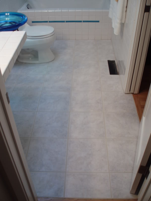

Can you tell this has been color sealed?
Not horrible but urine stained none the less.
B4
After

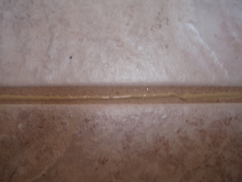

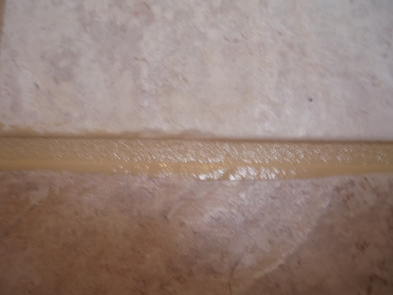

Apply a very thin line..

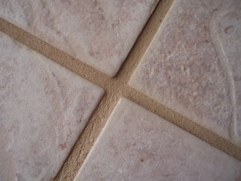

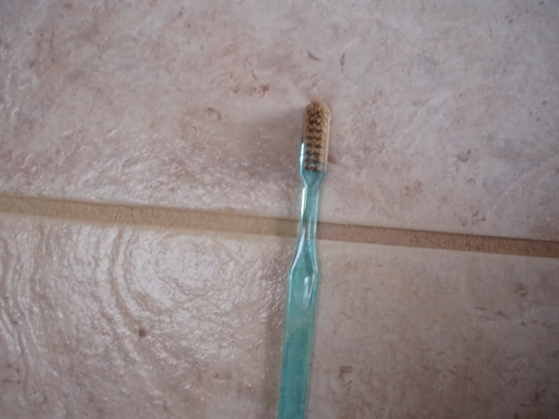

Scrub it in with a tooth brush..

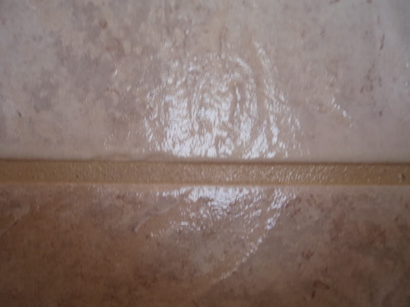

And wipe off!
To the left is Color Sealed..

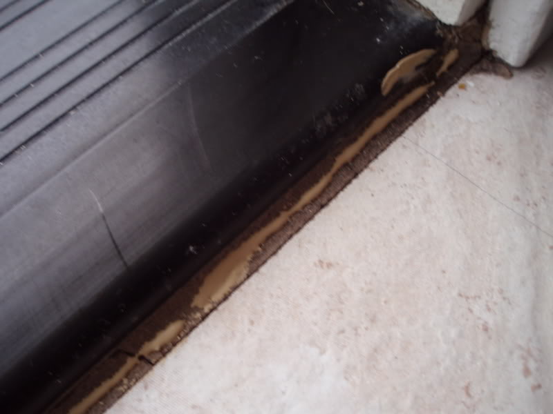

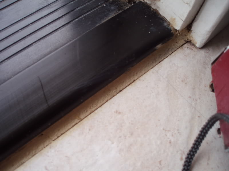

Nasty door jamb area full or Mop staining.
POW!
b4
after

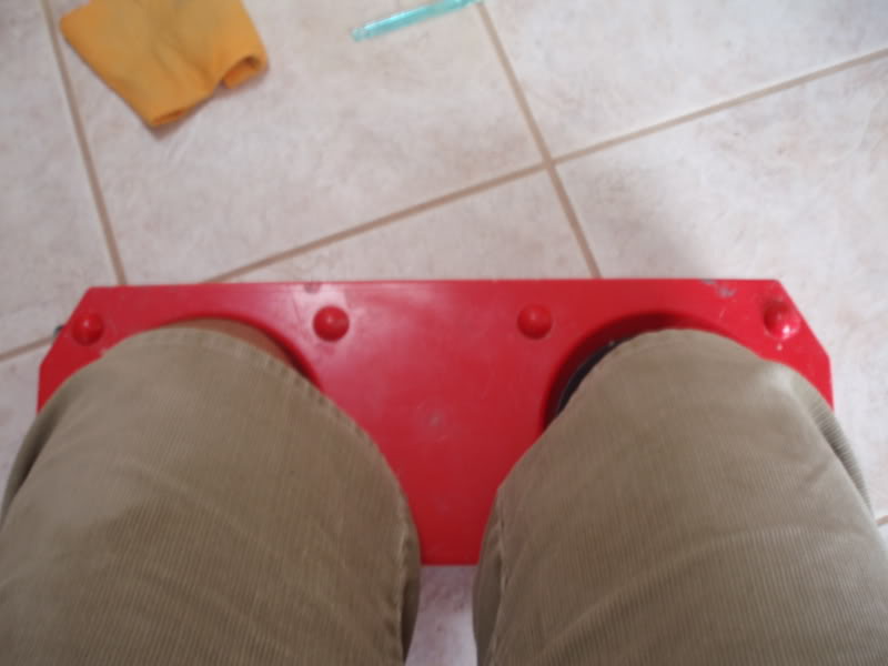

I love my knee roller specially the sound it makes when I run over grout lines it means i am making top dollar :lol:

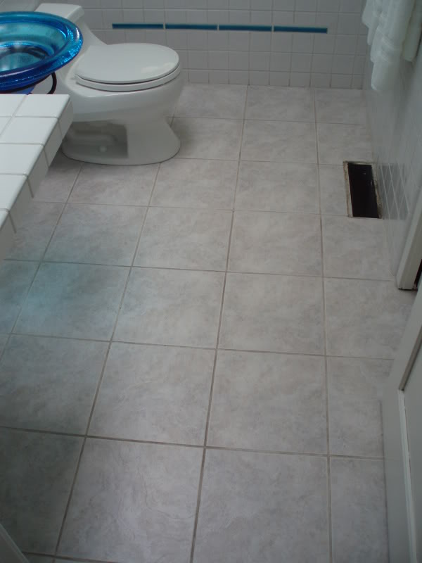

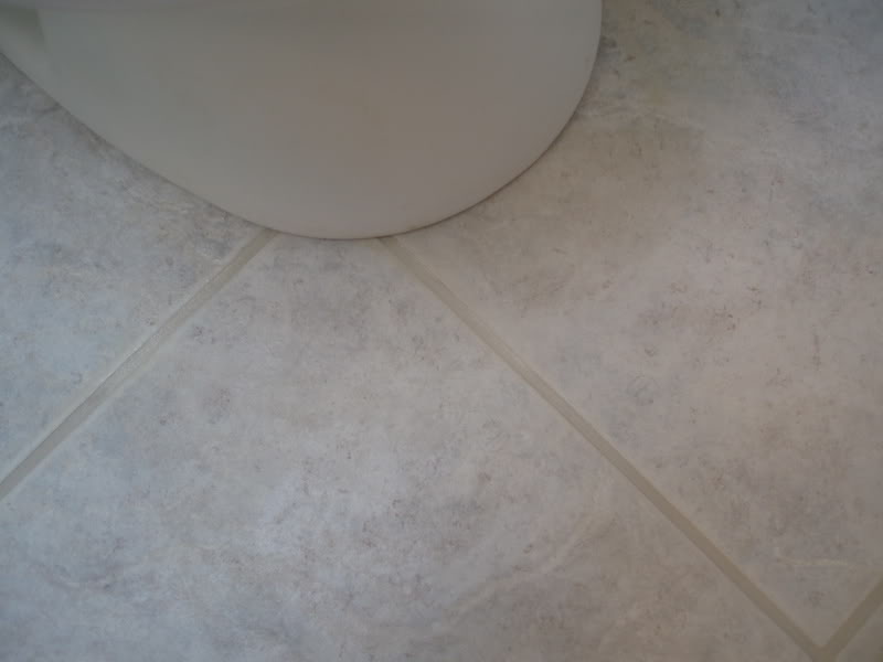

Here is a large job we just completed nearly 2000 sq feet I charged $5600 for two days work.
Before and After the darker line was cleaned it is red soil which will never come out color seal was the best option
