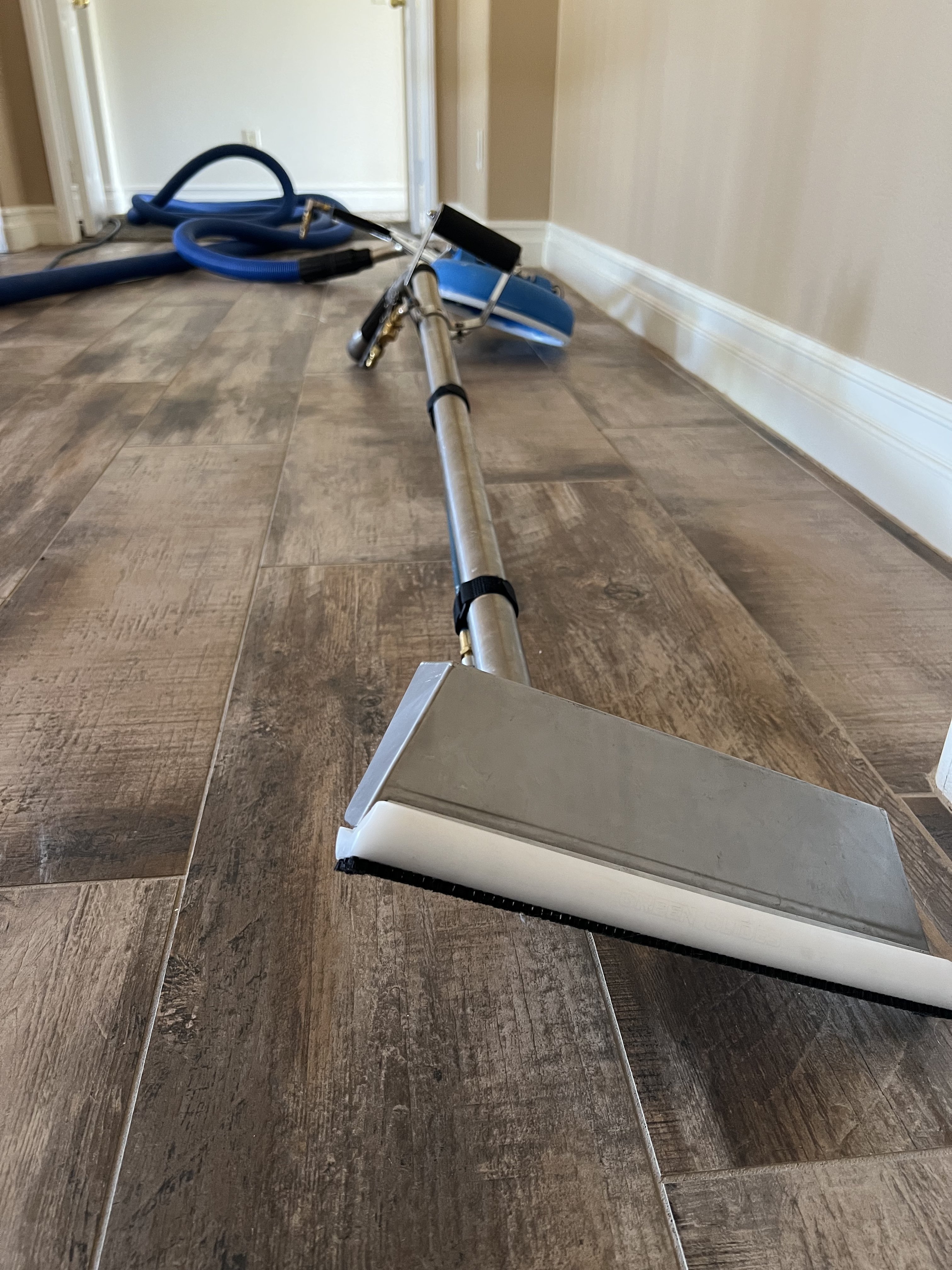

First day using so far let solution (saigers) sit for 10 and extracted at 400psi it worked! I just wonder if I need more psi or less
Any other tricks will be appreciated

you need what you NEED.
  • Some floors clean up great at 200 psi, some need 700, if you need more than that, use a spinner
  • Deep grout lines respond better when worked at an angle. (less splashing)
  • Some floors clean better when spraying on the forward pass
  • Some better on the back pass
  • Some are both
  • Lippage that fvcks with the spinner and traditional HS wand, fvcks with the GGBG less, if ran at an angle to the grout.
  • All tools need a dry pass, even this one.
  • Step on you wand head on both sides of the tube to be sure the Glide is firmly seated.
  • Take off the back lip to make install and removal easier.
    I clean more hard surface than anyone here and I haven't used a spinners in over two years.

I used it a lot today and I usually finish white a mop today I used 200psi and the wand it was fun
