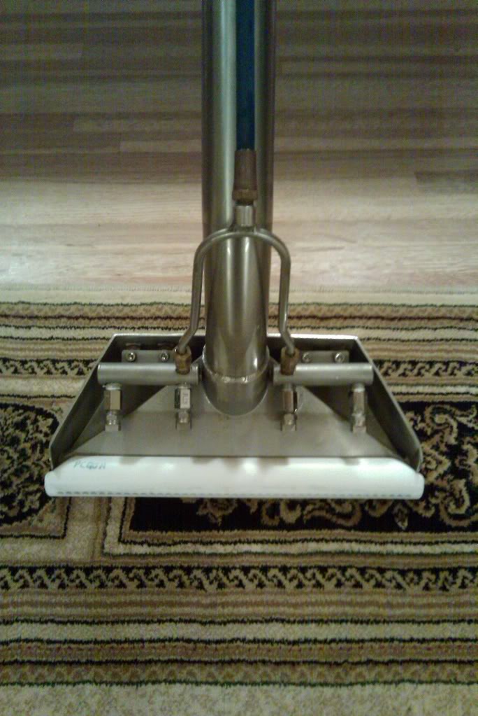

I was told to use short jet extenders and 110 jets on my glided 4 jet prochem wand. I tried several different setups from long jet extenders to short ones with different jet configurations and I got the best result with 80 degree jets on the outside with 95's on the inside with short check valve jet extenders. The spray is right to the edge with no overspray and has good even coverage all the way accross. I have 1.5 flow jets and I am going to bump the flow up to 02 jets.
