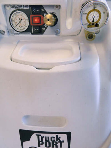

I agree with your recommendation of the 6.6 vac motors and 500 psi. Sounds like you just described our Truckport.

We don't have a CFM rating. CFM is an accurate way to measure truckmounts because they have blowers. With portables, their vac motor measurement is most commonly rated in inches of "water lift". As you can see from the photo below, the Truckport comes in at 200" of water lift –which is impressive!
116,391
When did you switch to the larger motors?
Imo you should promote this machine more..
14,253
15" of lift is impressive. I think with that kind of lift, it should be able to run 50' of vacuum hose no problem.
Maybe you could upsell some 75' heavy gauge extension cords to plug in to the 20amp outlets. Because sometimes those are hard to find
And is it hard to find 20amp outlets in big commercial office complexes and other commercial buildings?

It is common to have 20 amp circuits in large commercial buildings.
Adding a couple of these will get you some distance...

I'm not saying this isn't a good machine, but the drawbacks as I see them. Lift is good, but you've got to have air movement.In 40 years of running portables, higher cfm removes more debris and water. This will give you an idea on measuring airflow https://www.wikihow.com/Measure-Air-Flow.
20 amps is not always available' Can it be run on 2 fifteen amp circuits? Is it plumbed with 1.5 inch plumbing or 2 inch ?
