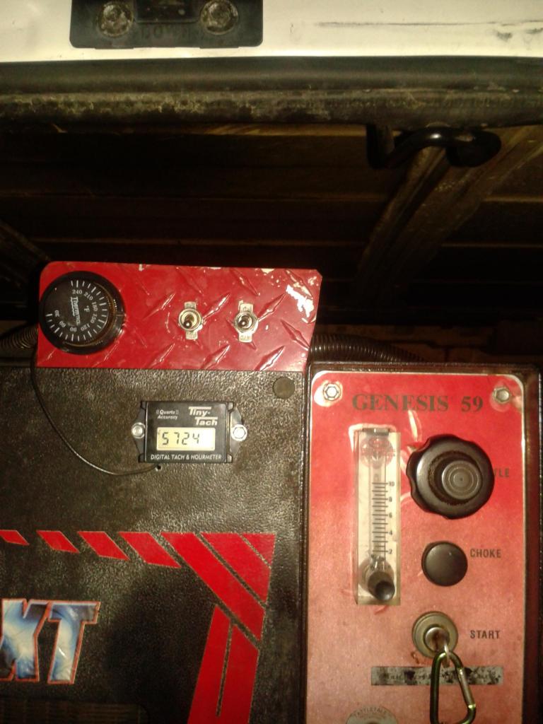

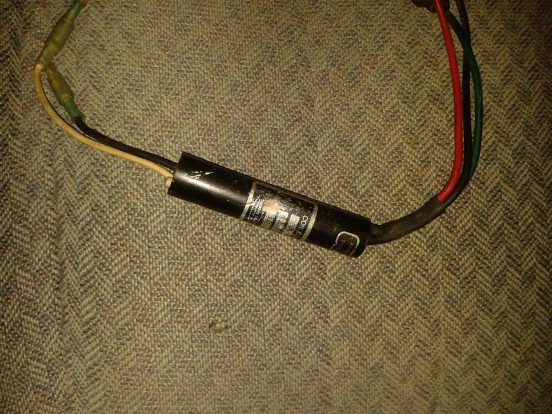

I agree with Shane.....if the diverter flap "broke", there would be very little heat diverted to the HX'ers. I've replaced a few flaps over the years (I have an 03 Genesis, electric diverter). I find that the electrical connections would corode an cause delay/no heat. I moved the themostat dial up to a new panel on top of the machine. I've also installed a relay into the diverter system to increase response time to the diverter, and I've changed the "coil commander", which boosts the voltage to the diverter when activated.

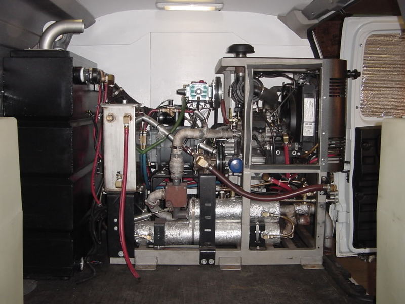

This is my Victory 47. The exhaust header that comes off the engine is has header wrap on it and goes down to the diverter. You can see depending on position of the flapper inside the diverter the hot exhaust wil either go straight down thru the diverter to the heat exchangers or out the back of the diverter and through the muffler. TM004.jpg Here is a closer look at the actuator connected to the diverter. This is not original equipment so it will look slightly different than the one that came from PowerClean. DSC00925.jpg The outside of the blower heat exchanger will get hot after you have run the machine a while with the vacuum hose and wand hooked up. It will stay hot as long as you continue to have the hose and wand hooked up.
