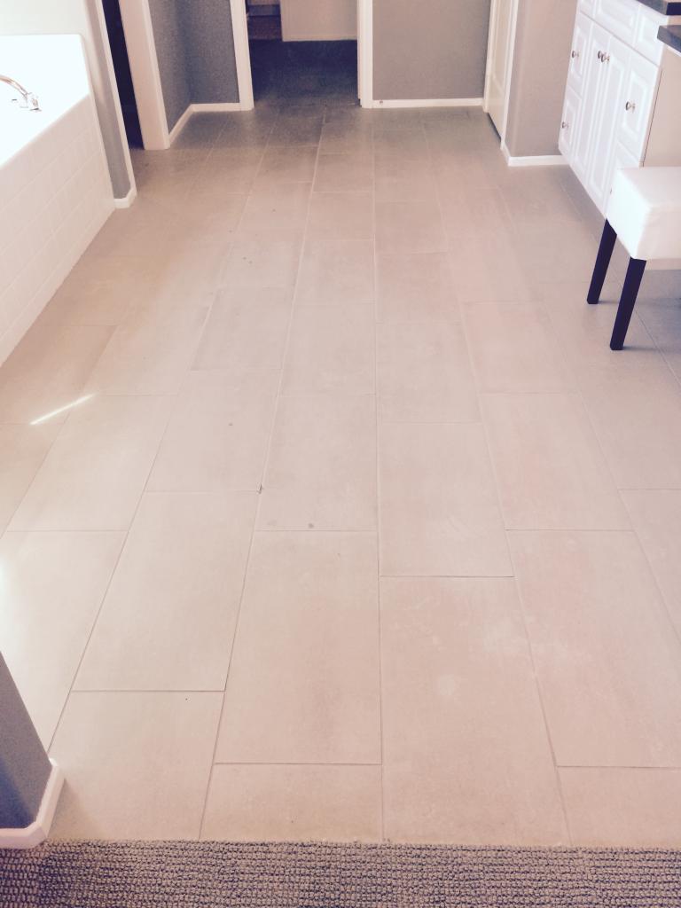

So I am looking for a little help to identify this stone and find a solution to removing the etched footprints. I know its a natural stone and the finish is course and flat. Thanks for the help and education:

I'm 99% sure that's porcelain. I can't be certain from the photos, but there are a few things that are red flags for me that say it isn't stone.
If it is porcelain, and it's actually etched, you're in deep poo poo.
Ammonium biflouride will etch porcelain and ceramic, and is sold as "Amazing" carpet cleaner/rust remover, and I'm sure goes by many other names. The tiles will have to be replaced, as this is a printed finish porcelain and not a through body.

Luckily I did not make this problem. What are the indicators that make you think its porcelain? When I looked at it the edges are very square cut with no rounding or color change. No pattern in the room that I could pick up on. The entire surface "looked" as if it were concrete that had been sandblasted lightly with a dull finish across the entire floor. Customer used Goof Off and Vinegar to try to remove the foot prints. The footprints are now a whiter brighter area of the floor.

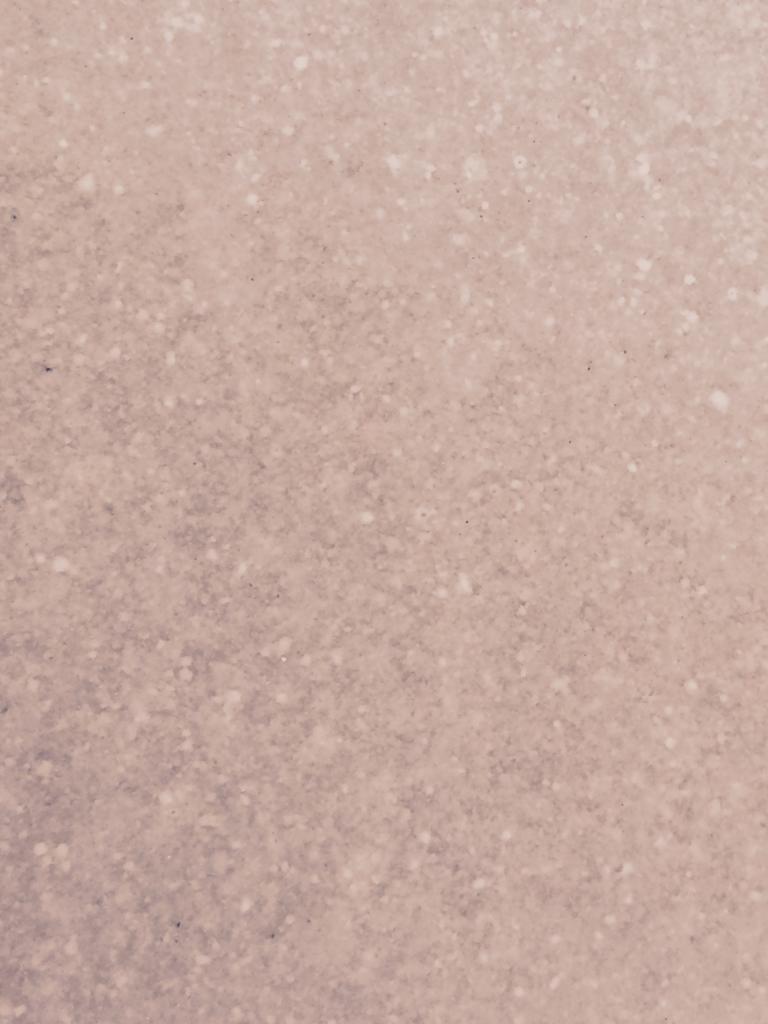

Here is another view.

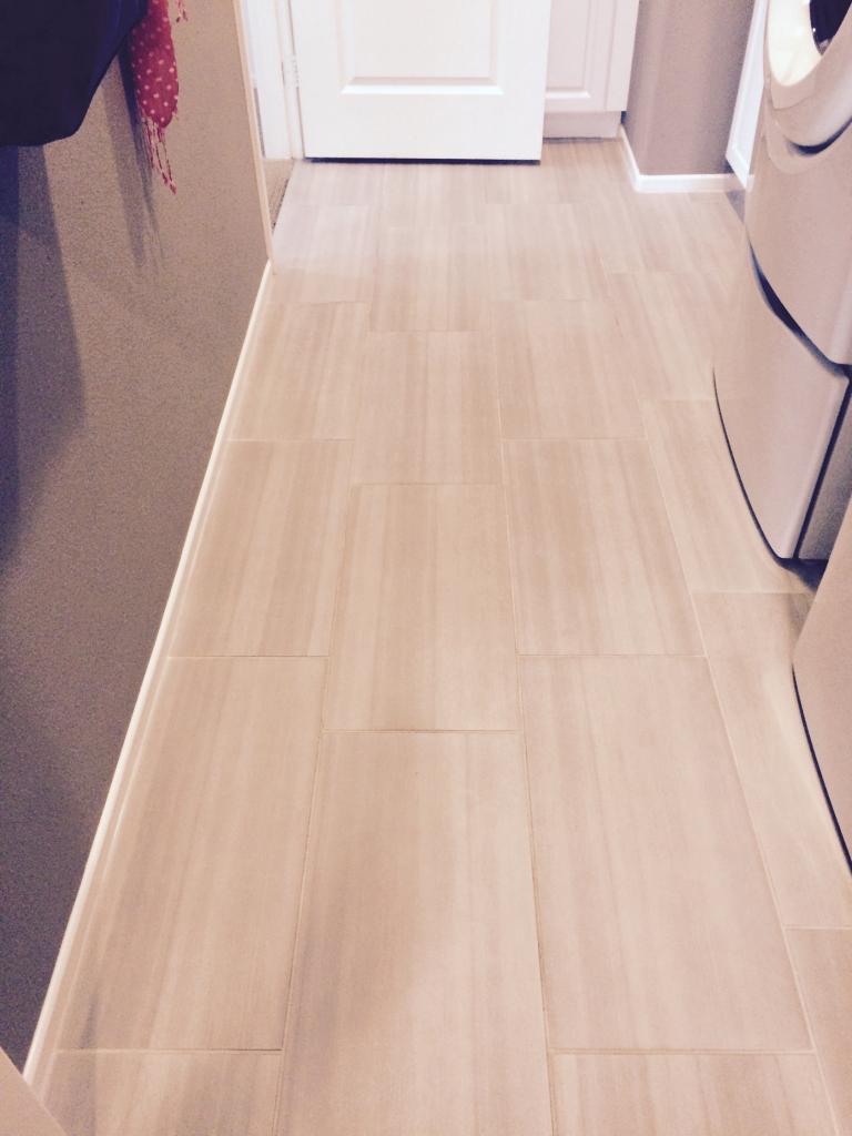

and this is an ajacent room which I'm 100% positive is porcelin.

Yea, you can see the boot pattern in the top picture. I will see if I can get some better pictures tomorrow.

We have some commercial jobs that look exactly like that and its porcelain .

I'm with Mikey. I am looking at it on a bigger screen this morning. That floor looks filthy. They've been mopping it, you can see the dirt caked up on the edges of the tile, down in the grout joints. Also, the second pic you posted (of the original floor) is a dead giveaway that it's porcelain.

So I just spoke with my customer and they are trying to locate any extra pieces but they are also saying its stone. I'm gonna see what they come up with in their search. I am not the greatest at identifying all sorts of different flooring and I really respect the thoughts and opinions coming from Cameron and Mikey. I also hope Mikey is correct but my pictures are not doing must just on the material, damn iphone.

1. Take a utility knife and try to scratch it in the corner of the room. If the knife scratches it, it's stone. If it doesn't and just leaves a metal mark, or no mark, it's porcelain
2. Take some cleaner. Any alkaline or tile cleaner and clean a section. Use a rag or soft brush.

No luck on the sample piece. I'm going to peel the carpet at a thresh and look at the tile edge and go from there and plan B is alkaline cleaner.

It was porcelain. I broke out the crb and started scrubbing. After a few minutes I looked back and I was creating the same white etched looking footprints. Hit them with crb again and NOTHING happened. After turbo it was fine.
