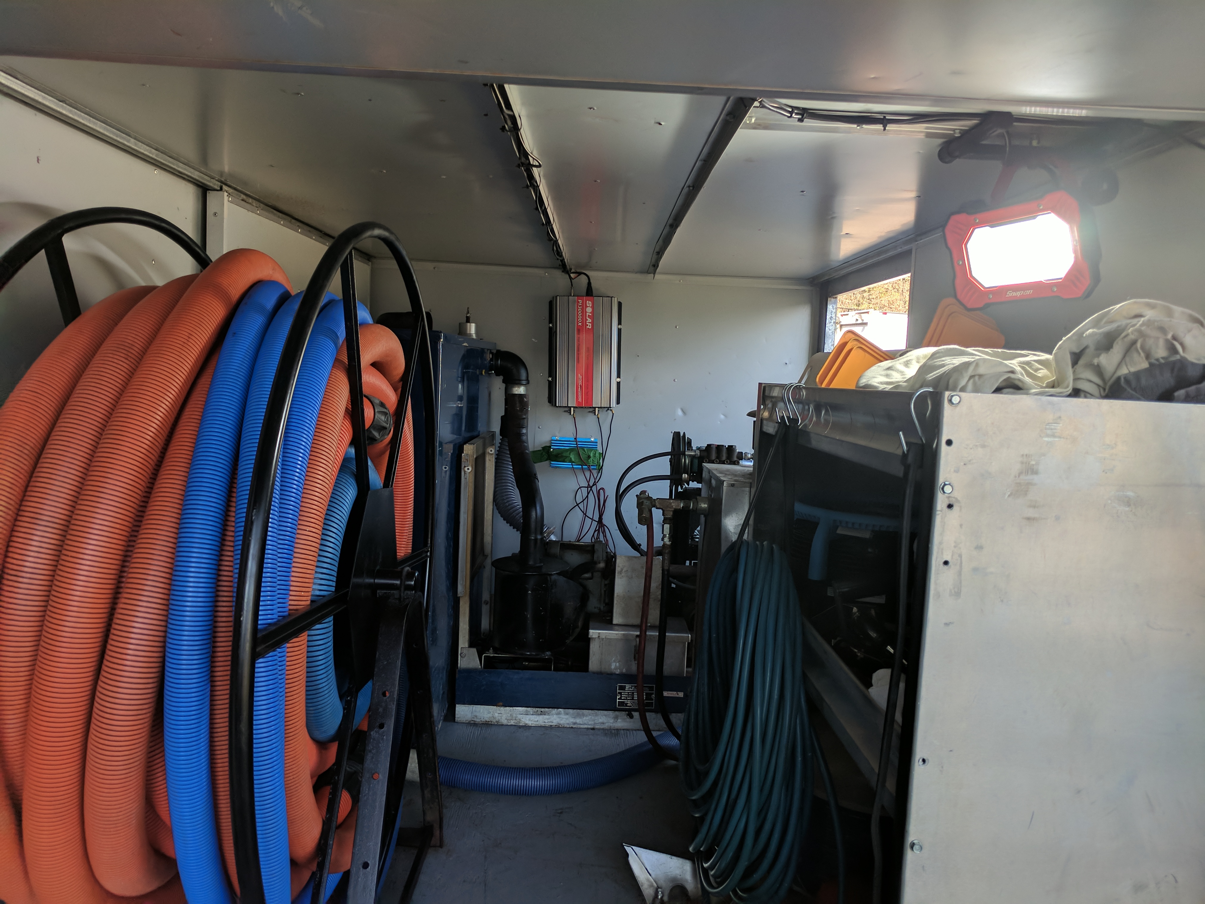

Fixed my chemical feed on my rebuilt Mastermatic. Hooked up my 3000 watt inverter. My LED light works great. Next, I will install my air compressor so I can use my compressed air tank for Deo or protector.

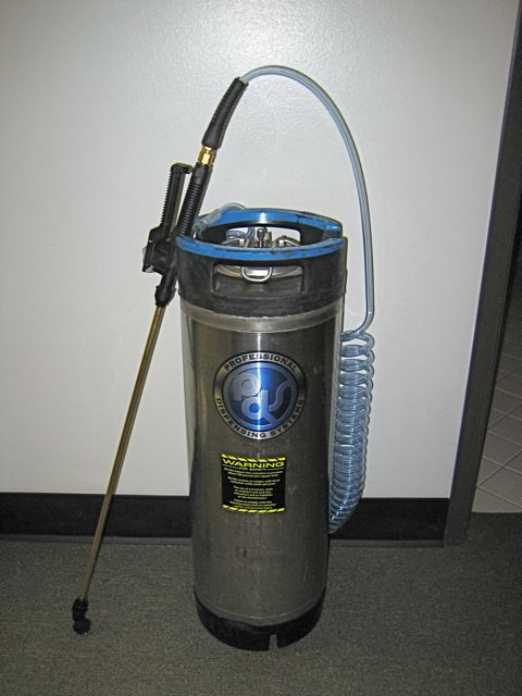

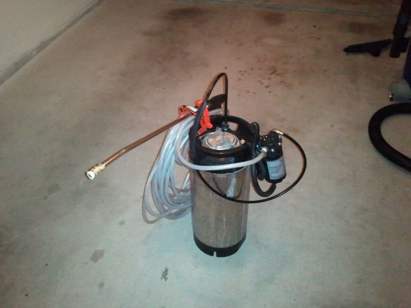

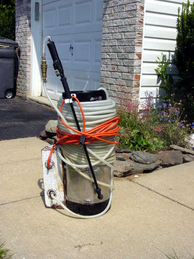

What air tank do you use for the deo?
28,265
Ya have a picture somewhere here?

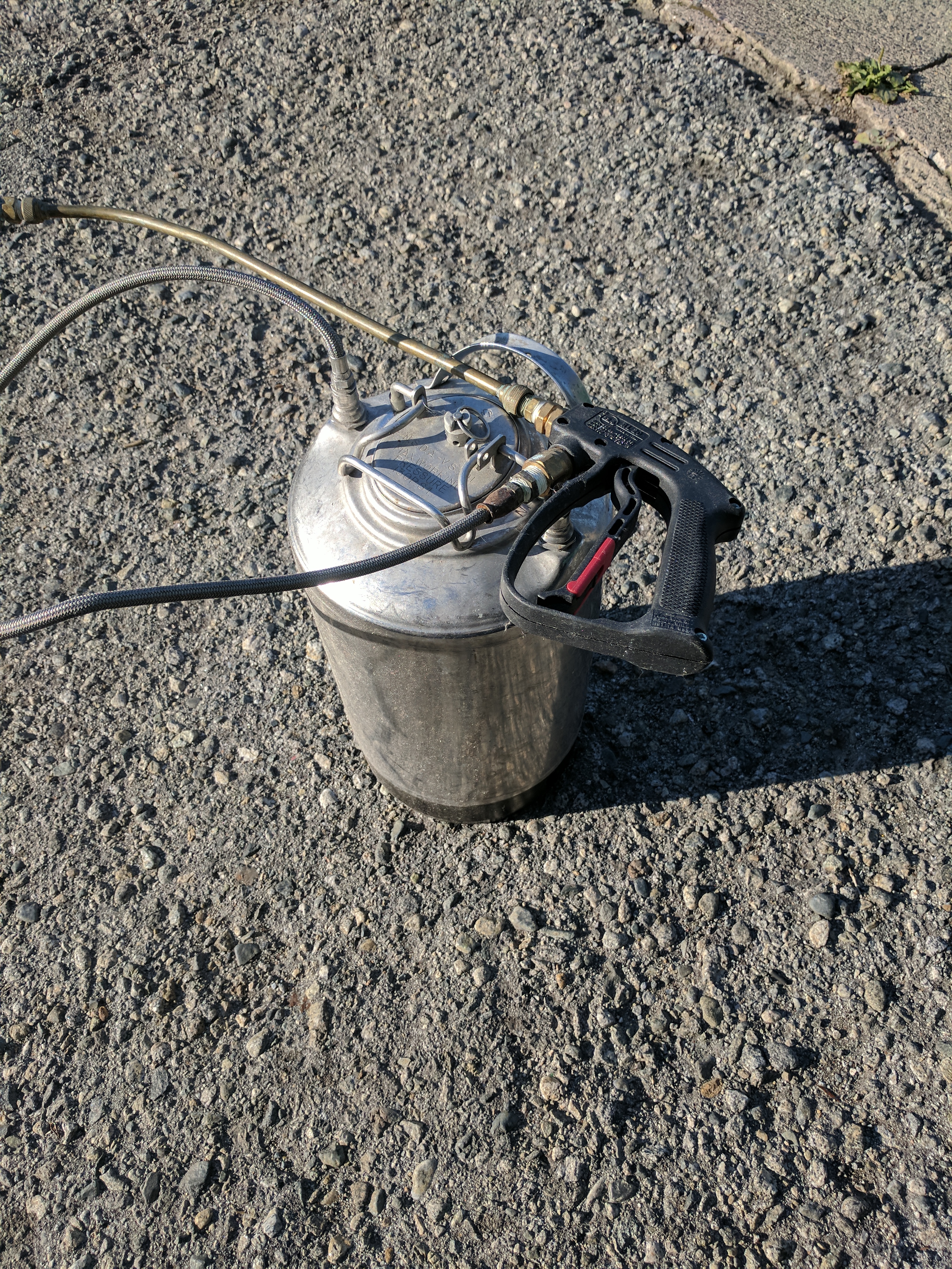

Similar to the ones Fred posted. I'll post a pic tomorrow. I used to have a couple of 5 gallon ones but sold them as I wasn't using them.
pepsi sprayers
an '06 board de jour phenomenon
wonder how many are in the dusty corner of shop/garages across the country now
next to other de jour items like POS GreenhOle wands and bOss sprayers

I used to run a small 12 v compressor on the truck. Took about 3 minutes to fill with air. I now have a 3000 inverter on the truck. I can use a full size compressor that takes less than 30 seconds to fill with air. I use a hf for prespray so this is just for Deo or protector.

So you hook inverter to the truckmount battery?
28,265
Yes. I also have an isolator switch that can hook up to the truck battery as well. I haven't bothered with it. The truck mount has a belt driven alternator and a full size battery. It will power lights, air compressor, power tools, etc.
