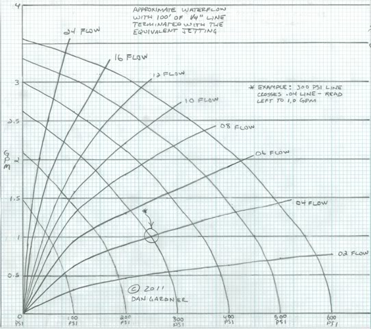

Fred a long time ago we discussed how Vee and Tee jets are "flow rated"..
You would think a 6 flow jet or combination of jets would produce 6 gallons per minute at a set/base PSI...
but no.
Most wands create about a gallon and a half at 6/500
Navasearch me bro
The flow chart (w/ losses) that Gardner plotted?
28,268

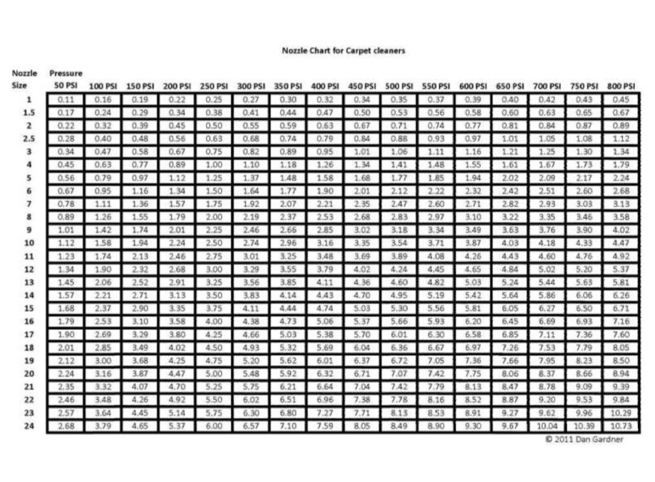

The nozzles are rated for from at 40 psi. An 02 nozzle will give you .2 gpm. An 06 will give you .6 gpm. Pumptec has a nozzle chart that shows what nozzles will do at various gpm. I believe an 04 will give you 1.5 gpm at 500 psi.
can't remember where this came from, or why I screenshot it?
don't know if it's accurate, but It's truly fascinating
3rd post in that thread has some cool observations of the graph
