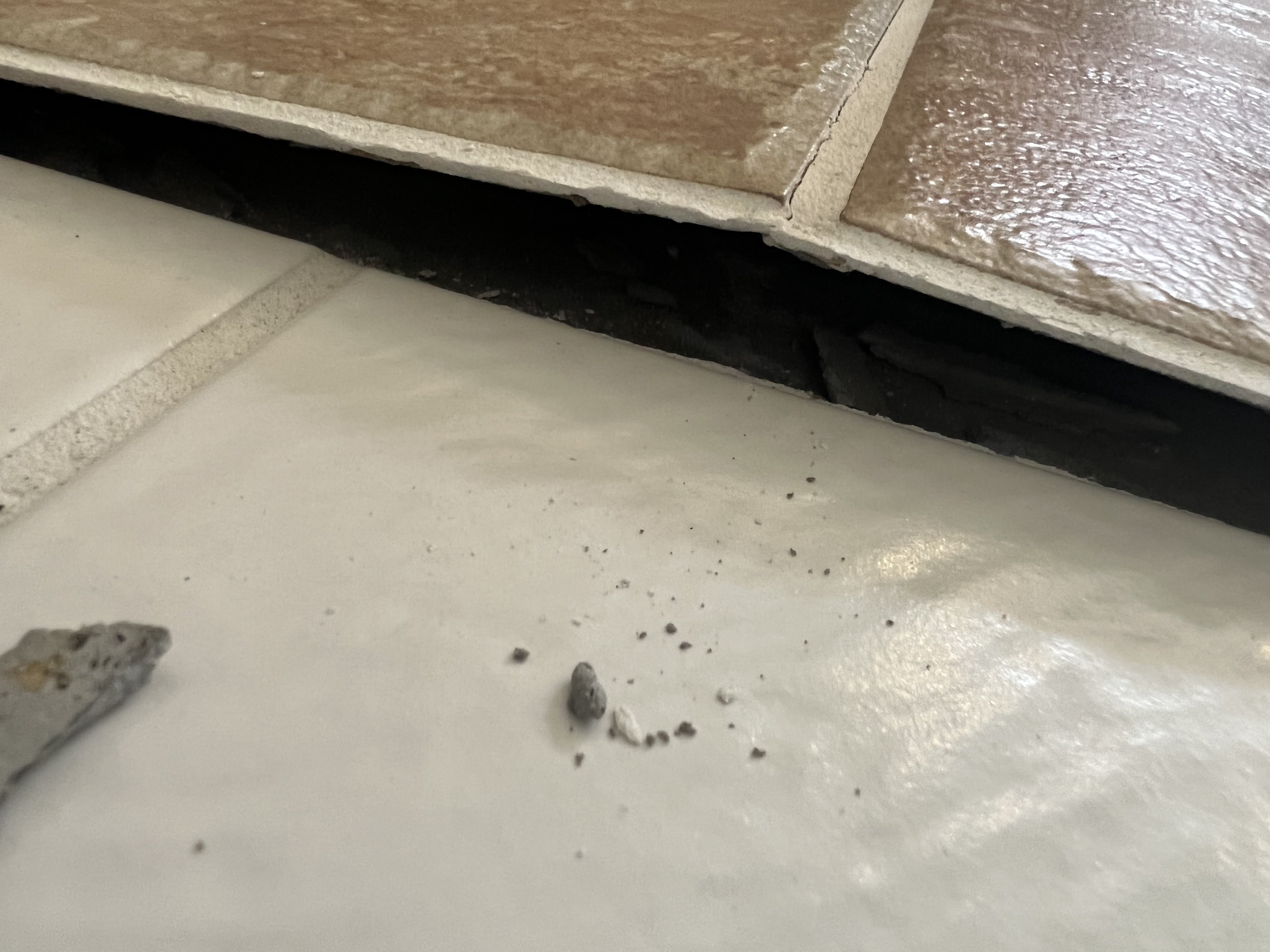

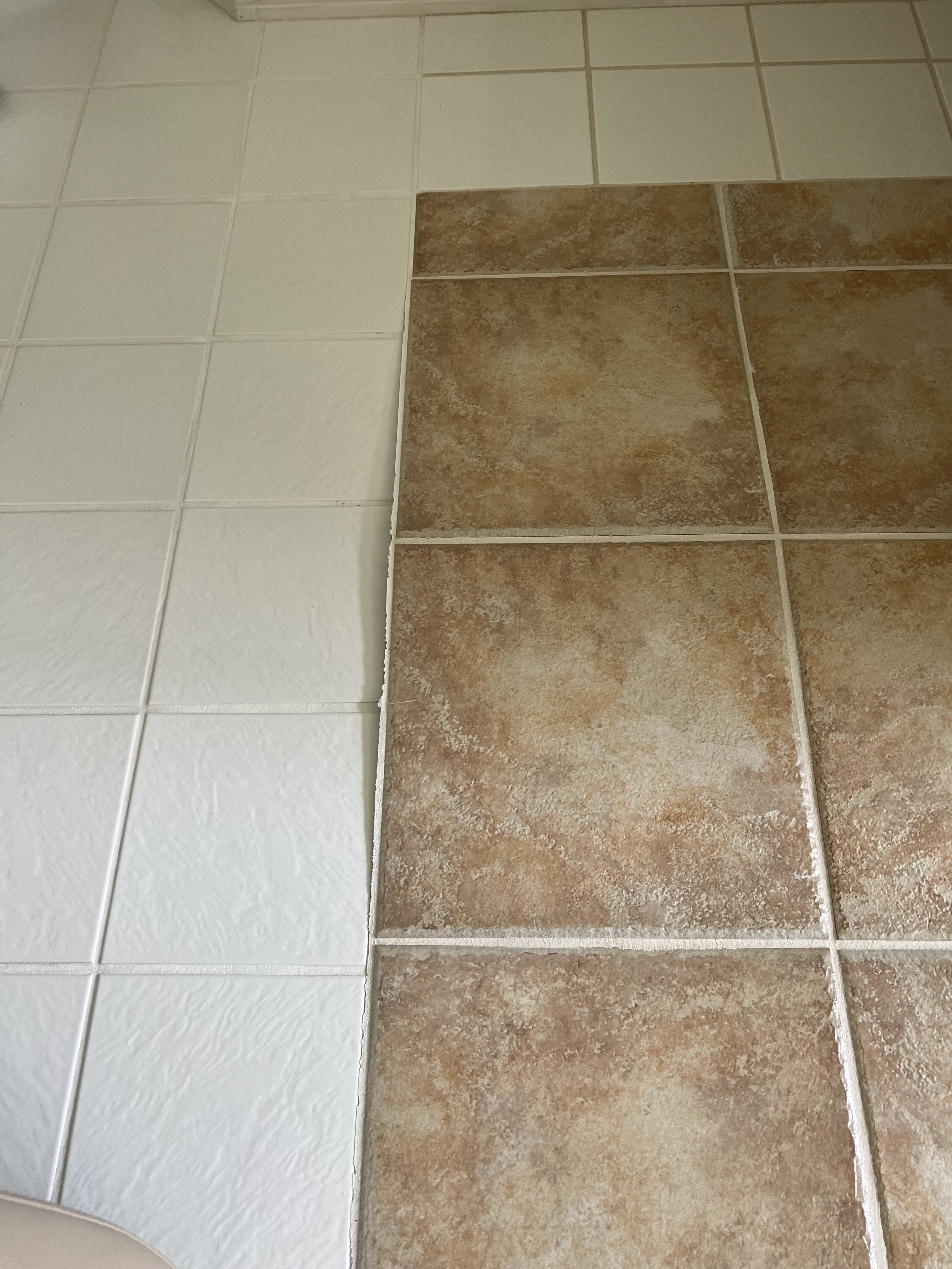

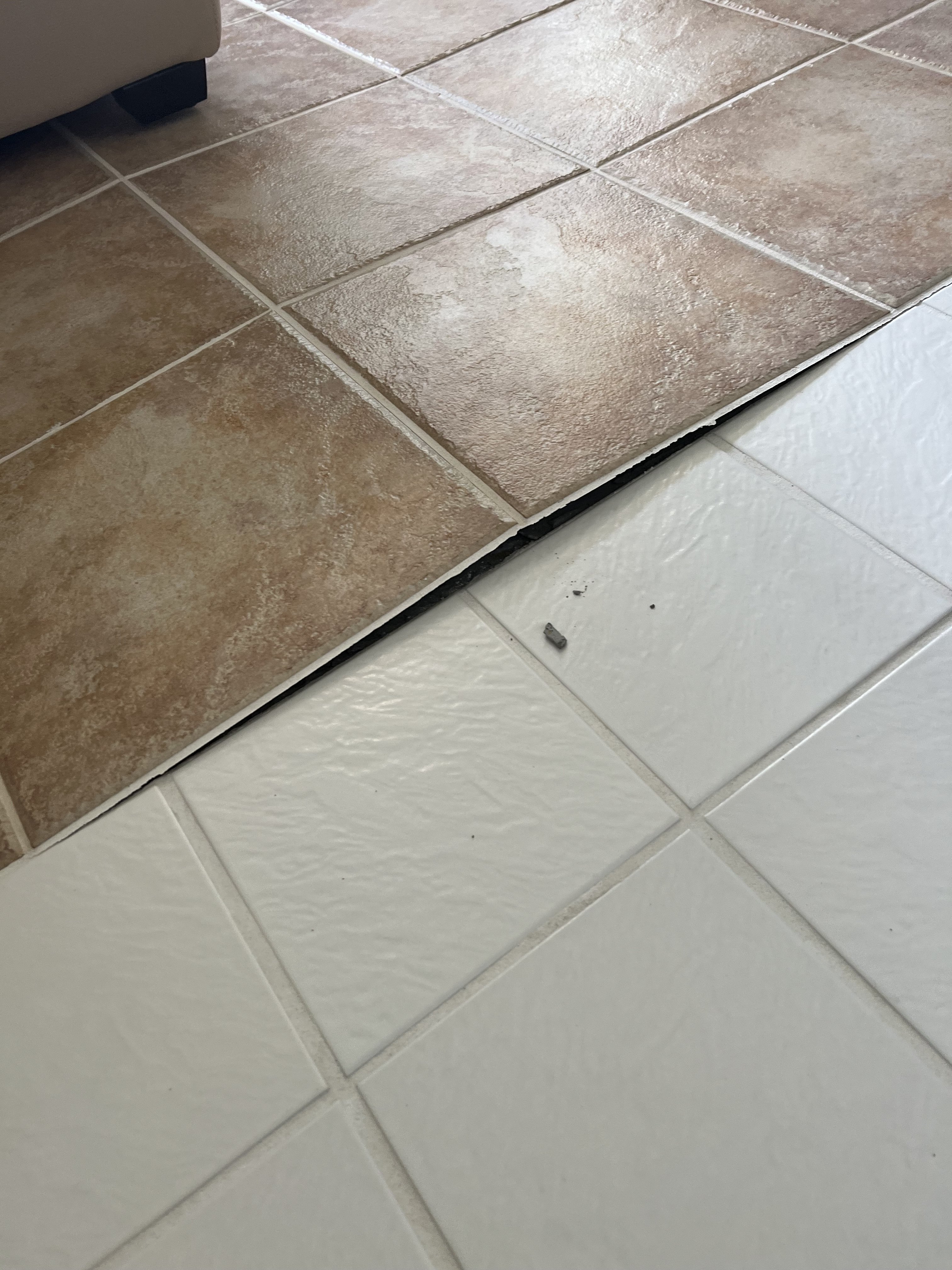

Fascinating photo of a tile floor gone bad after cleaning..
116,391
Tiles popped loose an hour ofter getting "spinner'd"
Florida.
Concrete subfloor..
Look at the clues

Always an installation failure. Nothing to do with the cleaner
Yeah I mentioned probably not enough thin set, but I hear hallow points in tile all the time and it's doesn't pop up, I just see breaks before I touch it.
But I'm proper install of thin set ant tile is a real deal.

One of my many fears with tile cleaning.. Golf ball test or even the seam tractor going over it to hear if it's hallow.. A lot of WDR guys have had problems with "tenting/popped" tiles after drying out..
I'm sure your BHGG are the answer to this problem.. Lower pressure and heat used to clean it..
116,391
Tenting is due to incorrect installation but as in the case of this particular photo it was aggravated and definitely the straw that broke the camel's back but had the concrete subfloor not been wet. Most likely there would have been no tenting

Golf ball test? Drop it a few inches and listen?
seam tracker? please explain.
you can never become cocky with uph cleaning nor tile cleaning. Prequalify / inspect and have them sign off for pre-existing potential problems. Oh and take pics of everything with your phone as back up. Especially upholstery. One time ago it cost me $$$ for a chair with down in it. Got a call two days later that it became brown. Got it back to 95% better but the hag was still not happy. I Should have followed my gut and foam cleaned them instead of wet clean. Learned a $958 lesson (total amount of the job).

Golf ball testing is if it sounds hallow by bouncing the ball.. Seam tractor with spikes attached to a broom handle and you roll it over the tiles, it'll sound hallow as well.. A well installed floor won't have the hallow sound..
My pops has been a certified inspector, so I've seen some sh!t jobs.. Imho you couldn't pay me enough to deal with people's BS when it comes to finger pointing..

I mentioned that in the Facebook thread, not a enough thin set used, but someone mentioned it was improper application and installation of thin set and tile.
Also I've cleaned 100s of tile floors with echo or hollow spots and haven't had this happen.
It only happened once when I clean a carpet bordering tile that popped
Not a lot of moisture at all.
