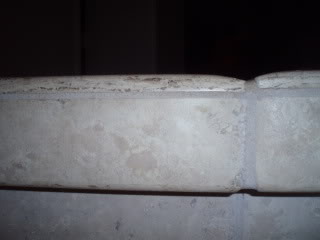

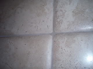

Dec 8, 2008 #1 Mike Pailliotet Administrator Joined Oct 6, 2006 Messages 117,272 Limestone. Some etching. Started out flat/honed but has developed a nice shine from use. I'll have to Monkey out a few etch marks. I can only hope the Turbo picks up well.

Dec 9, 2008 #2 A alazo1 Guest Try putting a regular floor pad under the monkey, may get in the lower parts better. For regular polishing powder I've heard of guys using a tampico brush. Albert
