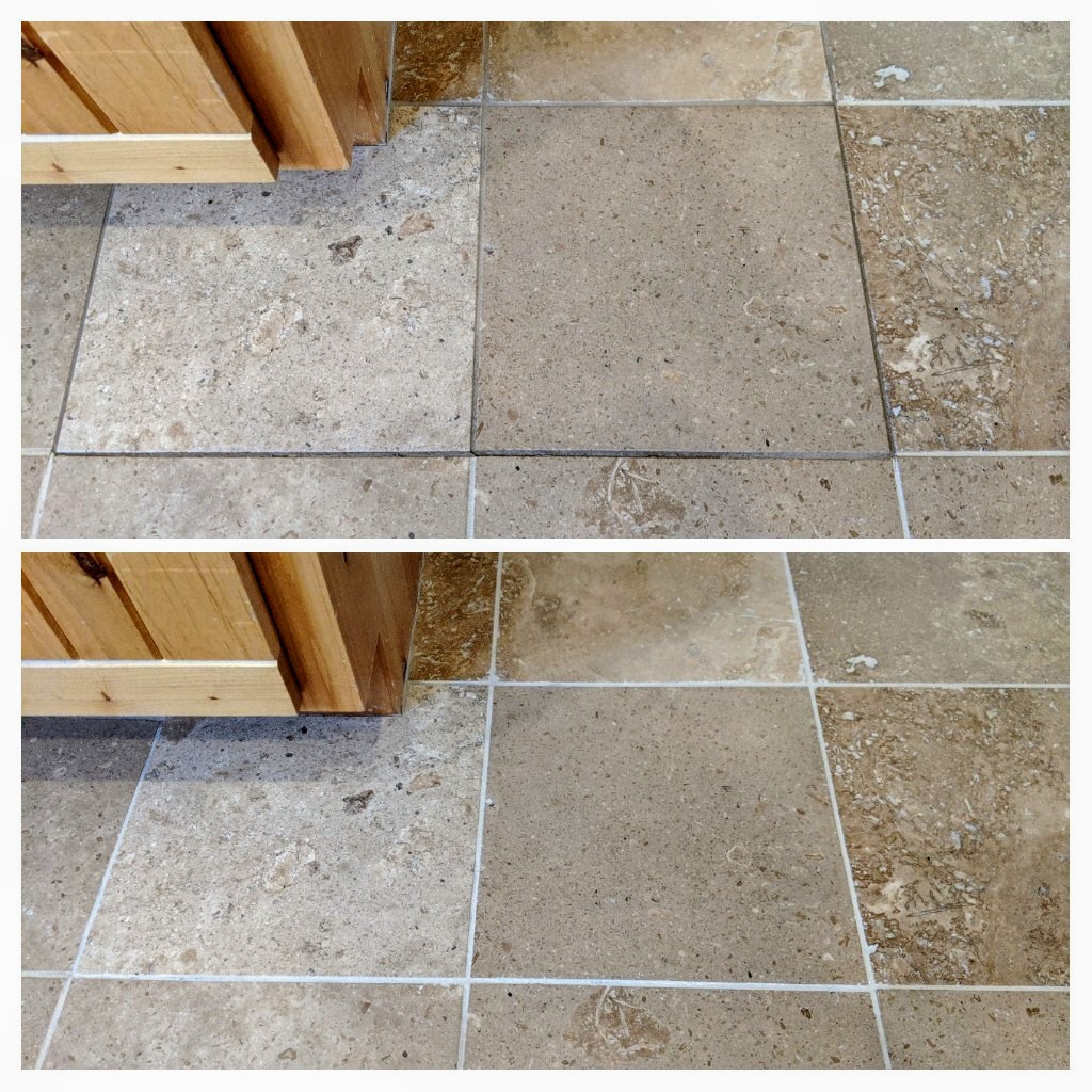

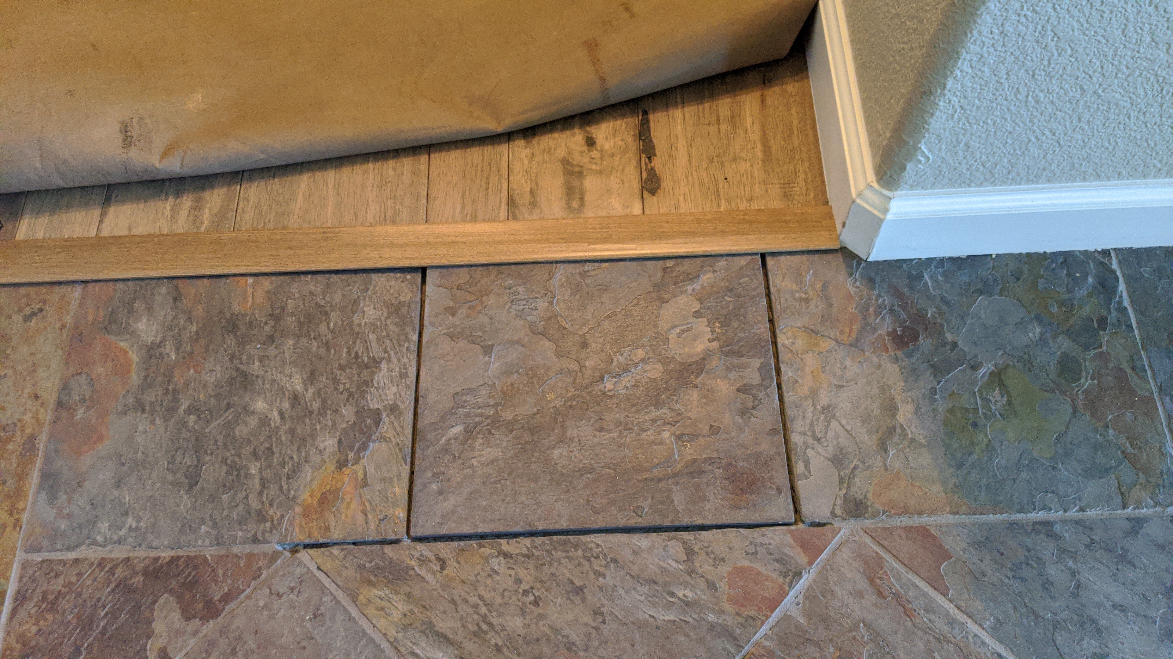

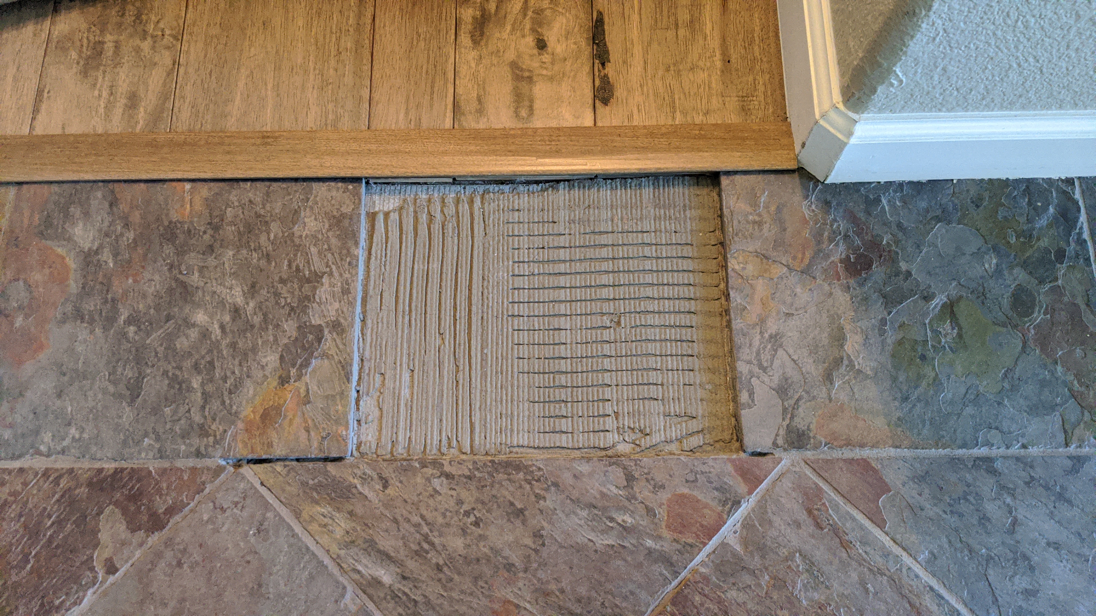

handyman replace these two tiles and match the new grout that dirty old grout well guess what happened after I clean the floor...
SGA to the rescue again

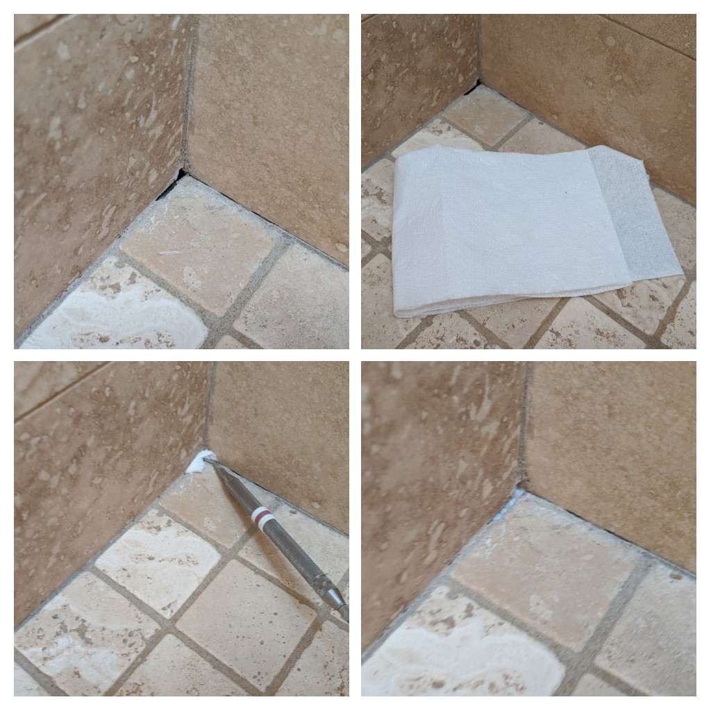

so paper towel as a backer rod?
IMHO over complicated the missing grout repair. just use prism grout- done
My question is why do you it's necessary to use SGA for that situation? Does it break frequently?
116,397
more complicated?
customer has grout in garage.
I have SGA in van.
done.
TP to plug holes so all the SGA doesnt fall into the Bermuda triangle
Prism is a matsa cracker compared to SGA
