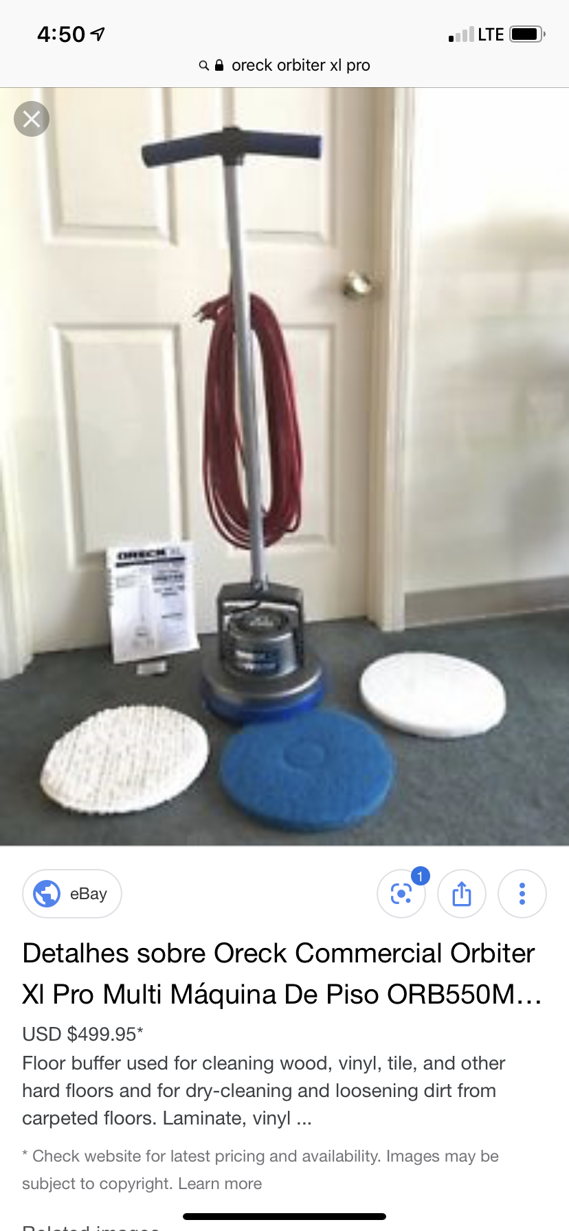

Been looking at the fm-me mini edger from Pacific floors. Anyone tried it?
Yes, I have an old one. Brush on it, but can put a pad driver on mine for an 8” pad. Not sure if it’s the same one, but mine is good. 150 stairs won’t be easy no matter. Honestly, the micro wouldn’t be bad. I have one of those too.
28,277
It sounds lighter and more maneuverable than an oreck. I like the idea of switching between a brush and pad. The price is about the same.

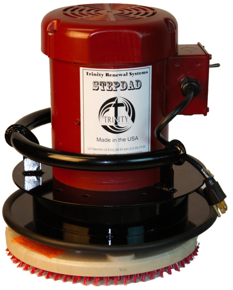

Jimmy L
15,253
Jimmy L
Just be prepared to get a lot of religious pamphlets in the box if you order from................that guy

Thanks but I think my back would go out before I was a third done. That's why I am looking for something with a longer handle.
you do have to kneel down on a towell so you dont get pre spray on your pants but its the best tool I have found... gets edges, nose etc really well

I think it’s a good tool too. Not sure about 150 stairs, but it’s good on a dozen or more🤷🏼‍♂️ He could put a young ish helper on it, and who cares.

Get the oreck orbiter and if your going to use cotton or micro pads then take the t-hooks off the oreck's pad driver ( they will rip up your pads) and replace with velcro, you can get some at wal-mart in the craft section get the industral.
To clean the stairs with the oreck start at the top, you'll be standing up straight looking down the stairs with the machine in front of you, lower the oreck to the first step clean and let it roll over the nose of the step and clean the nose, step down to the next step and repeat. this way there is no bending over or getting on your knees.
