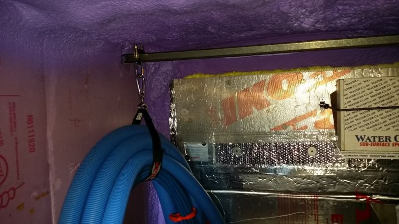

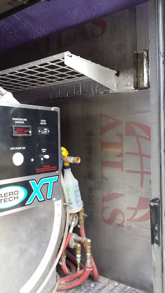

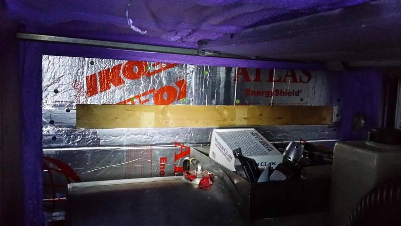

wanted a shelf above the water tank but made sure it left enough room so I could easily fit gallon chem jugs under it :)

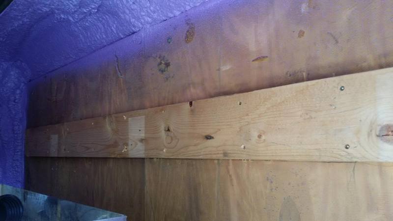

2x6 used construction adhesive and screwed it in place
Filled in the area around it with 2" r12.1 Reflective insulation
Installed 4'x15" heavy duty shelf, but first covered the 2x6 with reflective material ( looks better too)
Then installed metal sheeting over the insulation in the shelf area and beside the water tank as this insulation isn't that tough. Ill probably hang things like yardsticks, door wedges etc from the bottom of the rack

Dustin
temporary solution but instead of hanging extra hose off the recovery tank handles I wanted it in the corner. Hoses rest mainly on the floor so not much weight on it.
Muffler clamp with electrical tape :)
works great. Where are you guys hanging extra line?

I like your homemade hose hanger. What's that strapping material?

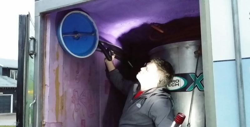

Dustin
Before I put up extra insulation thoughts on this spinner location? Can't mount it there vertical due to the equipment I sometimes carry.
sent via tapatalk.
sent via tapatalk.
Good location, that's pretty much wasted space. What are you mounting it to?

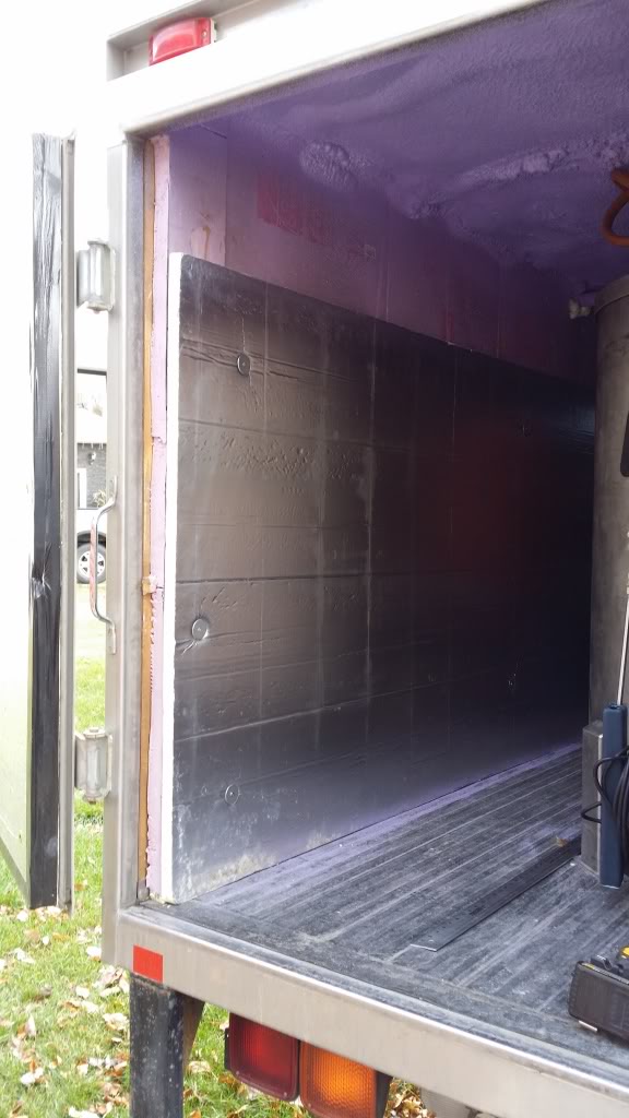

Dustin
Think I'll wait for that mounting spot till next year. I'll try something else first.
Side done today. Went from R6 to r13 on drivers side. Either putting more of that metal stuff up for protection or the carpet that was previously there.

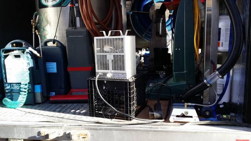

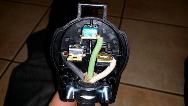

Dustin
no messing around this year .....
impossible to find a commercial grade 110, so went straight to 4800 watt 240 volt 30 amp power!
This heater kept my garage warm for my old TM in a 24x20 garage with 2x4 walls. This box has more insulation then the garage does so.... :)

Dustin
heater will stay there for now but I think ill fabricate a more permanent location out of the way for it....
I don't use AT's filters so I am thinking about taking those off and using the mount location and fabricate a metal shelf. Then just wrap the 2.5" hose coming off the tank in header heat material. Thoughts?

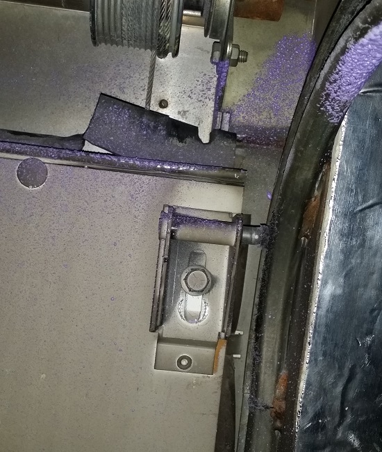

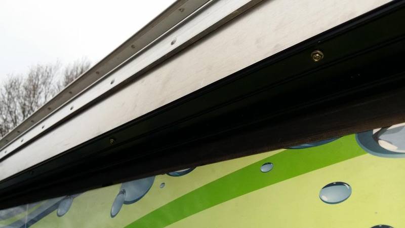

Yes the plan is to just buy a shop/rug plant? Ill do it this way for a little while
So was inside the truck with all the doors closed to check how the roll up door was ..... not the greatest
it was letting a ton of light and of course cold air in!
checked the door and sure enough it wasn't adjusted right from the factory - Half inch out at the top.
noticeable in the pic
adjusted the top bracket so the door was pushed tight up to the cable
still a tiny bit of light showing so went the extra step and added exterior weather stripping
zero light coming in now :)

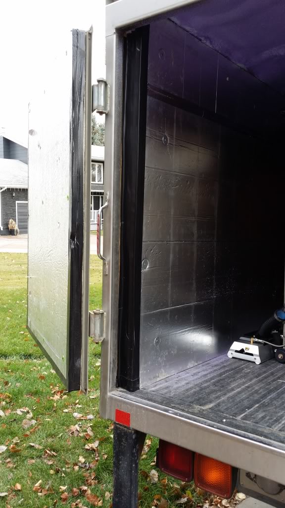

Well -40 last night and the truck is still a toasty 16c(61f) inside :D
Insulation is great except the roll up door, which I bet is lightly insulated at best.
So, having a insulated canvas or denim type cover being made soon to snap in place and cover the entire area. Which will be handy too when out working, just unsnap a corner then pull the hoses out. Should greatly help all the cold air rushing into the truck too!'
