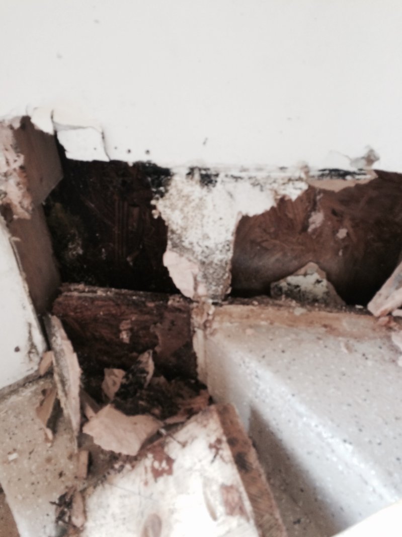

There was previous mold issue and we found mold in wall along the slab just outside of the door where it extended out under an awning. It wasn't part of the mold remediation I'm guessing because they were only checking interior. I felt like if was enough to justify decon. I always go by better safe than sorry.
so- you setup containment over the area- setup a NAM. Used a hepavac? That would justify decon on ONE airscrubber.
If you didn't setup contaiment - then you just eliminated your ability to use fans - otherwise you spread the mold spores through the entire area once you kicked it on.
Not busting your balls but you can have HUGE liability when you bring up the subject of mold. on a water loss.

Greg has a good point - even if it's 5 years down the road and they discover mold in another area, you could be on the line for it. The whole whoever the last contractor to touch it is liable. It happens more than we think, especially dealing with higher end homes who have the money to hire an attorney that actually knows restoration. The same type of lawyer that could defend you could be your worst nightmare in court if all your i's aren't dotted and t's crossed.
