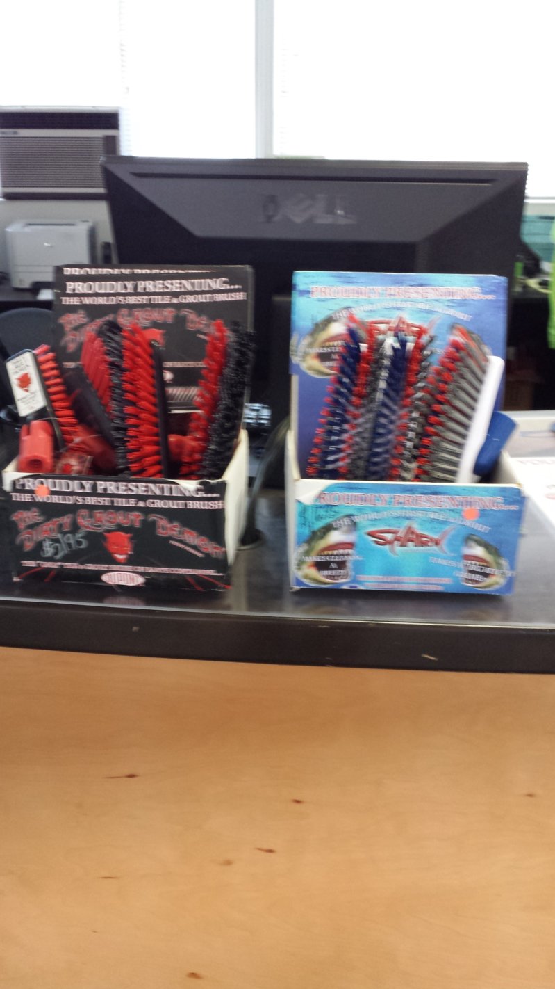

Some snake oil whore on FB claimed his pre spray was so good that scrubbing was never needed (yet for some reason he also sells shark brushes)..

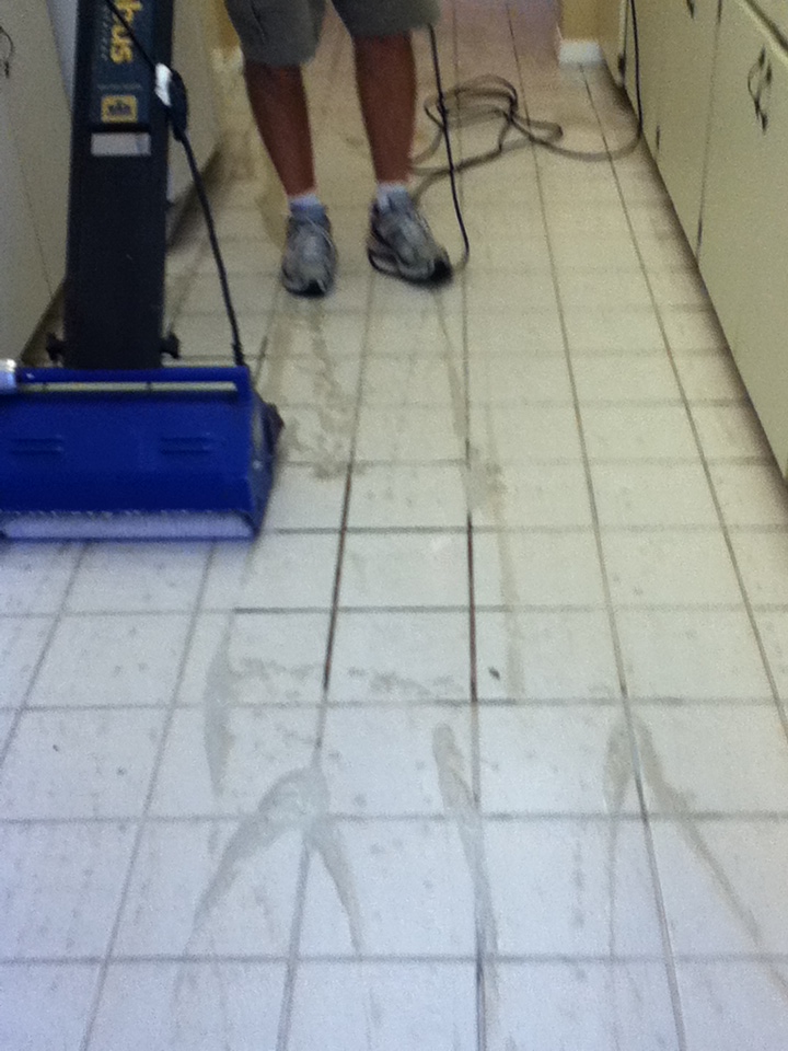

gene miller
We scrub with a crb. Never did before I got it. we would just hand scrub the areas that didn't come out. . Scrubbing with the crb is faster.
Gene

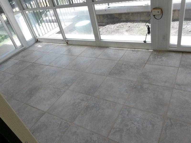

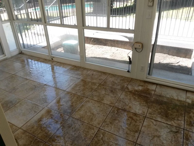

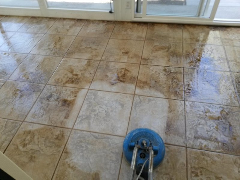

I'll let the chemical and techniques speak for itself. Here is a very porous ceramic that required very light agitation with a thin vinyl groutbrush, a sunroom where 2 large dogs spent most of their time
so just to clarify this statement, ceramic is not porous at all. It has a textured surface. It is this textured surface that provides slip resistance. So there is always a compromise between slip resistance and ease of cleaning(for homeowner) or how long a particular tile will stay clean given same "family use"
These highly textured surfaces are the ones that often provide the best before and after pictures. This is because the tiles are NOT porous and the soil load in within the texture, whereas a homeowner can not effectively clean
I has a customer that actually sued his builder because he had an unglazed, matt finish porcelain. it had a smooth appearance, however a very fine texture. It would become soiled at a very fast rate.
He lost, as the tile was classified as impervious in court.
