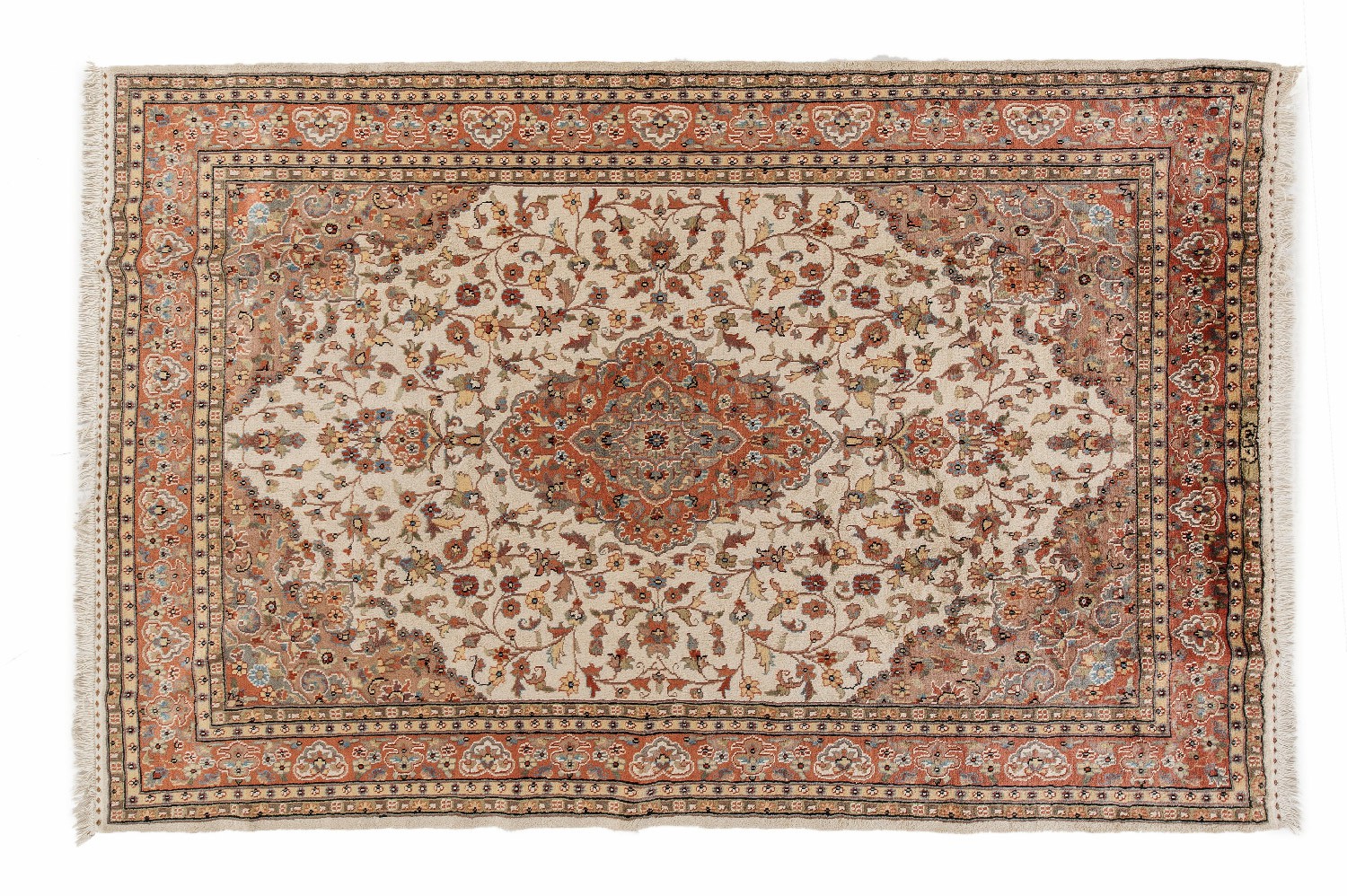

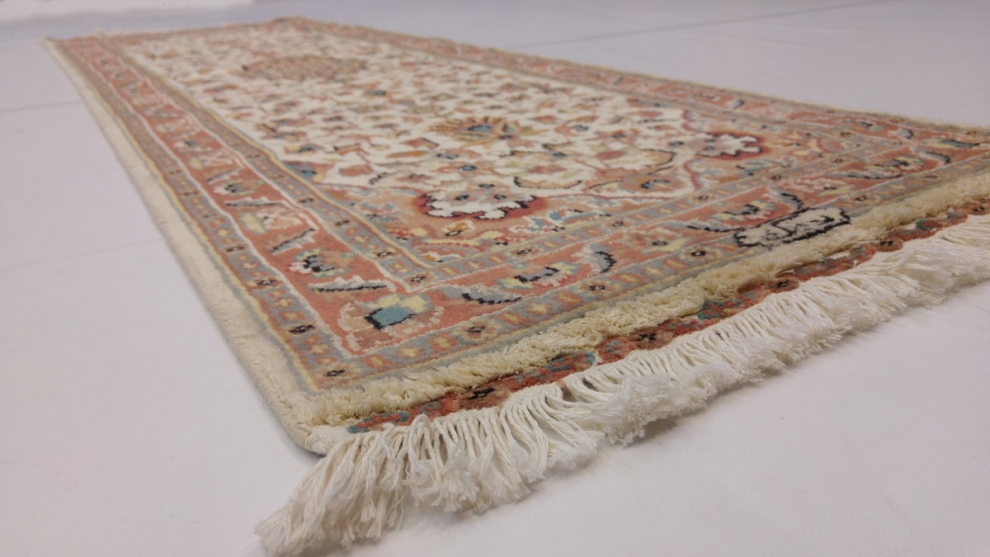

An oriental rug like this one
This one
They are 2 examples of Islamabad from Pakistan. This type of ierntal rug is very common in my country.
The Pakistani sellers say this rug is made of wool and silk, where silk is the light part of the carpet. In my opinion it is a fraud! In my opinion the light part of the rug is cotton.
I have difficulty washing these rugs. After washing, the light part is not soft and and the aesthetic result is not the best.
I usually wash these rugs with a woolsafe prespray (Prochem Prespray Gold) and rinse with an acid rinse.
Where is the error?

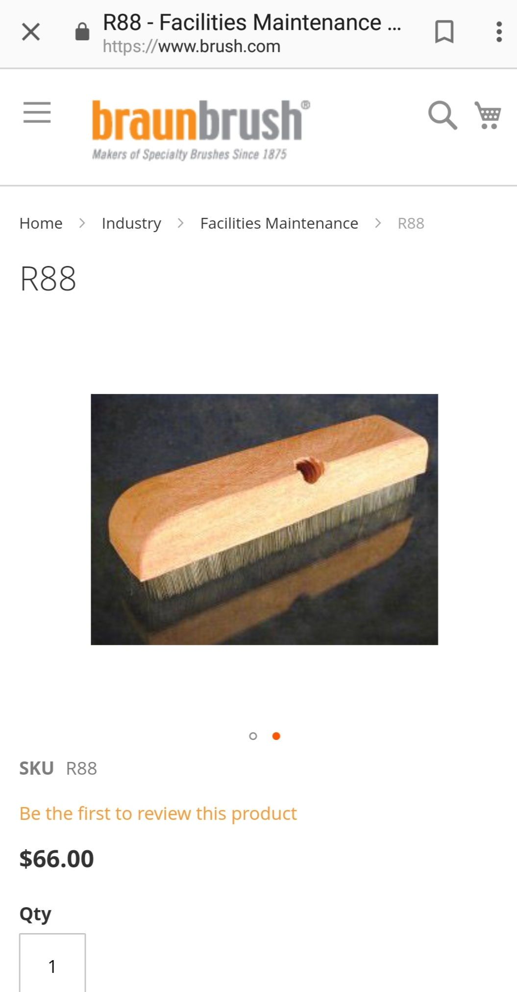

If it has cotton or rayon instead of silk, those fibers may absorb more cleaning solution and clump together resulting in a matter look. Use cold cleaning solutions only. You may be able to groom the rug with a steel velvet brush.
I have always used cold cleaning solution. What is a steel velvet brush? Can you post a link?
Tom Forsythe
Dec 19, 2006
486
Use the velvet brush above gently. If one thing is cheap like cotton instead of silk then expect other features of the rug to be cheap. The wool density on these rugs does not look that good. I would also expect that the quality of the wool to not be good either.

There usually is not a great deal of silk in these rugs you show,just highlights, but it is hard to tell from the pictures.

the silk is in the shiny highlight parts, the bulk of the face fiber is wool and the foundation yarns are cotton.
needs to soaked, and flushed many times to remove the soap residue to make soft.
