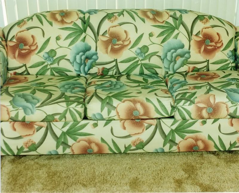

I like to boost my cleaning solutions, pre-sprays and shampoo solutions, particularly with upholstery and area rugs. It seems to help bring out the hidden colors.
Here is an example of a cotton print sofa that I was asked to clean for a management company and they just wanted to get 'one more year' out of it. It wasn't really 'heavily soiled' but just more dull and lifeless.

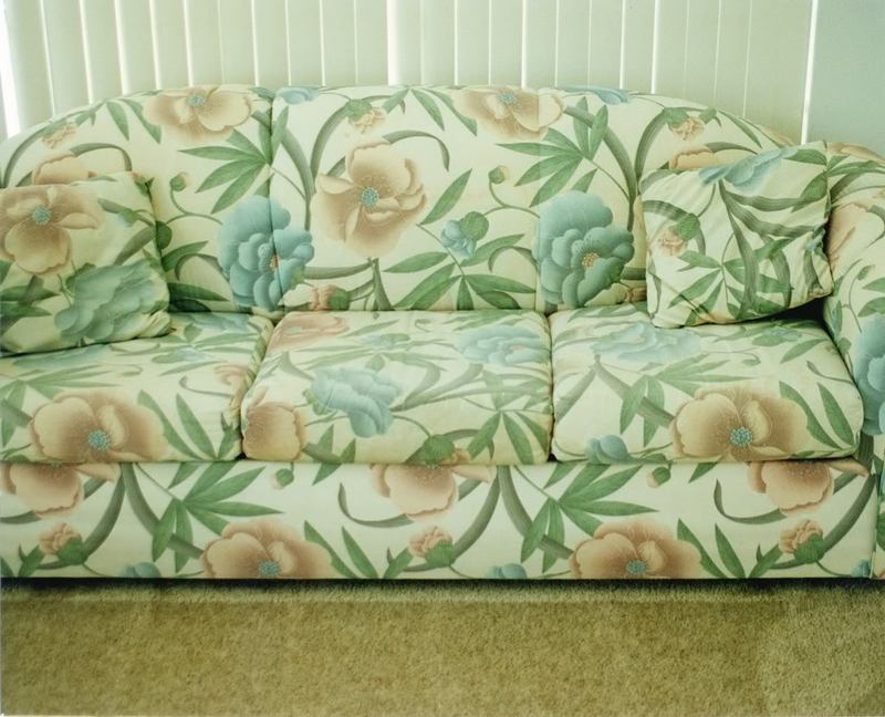

Here it is after cleaning with a booster and lots of agitation and so on.......
The results got me a lot of work from this management company.
What I like is the way colors seem to come out much better. Many times it seems as if something that is dull now has the old oxidized oils and soils removed and the light reflection brings out the colors that were simply hidden.
Just my opinion.

Thanks for the comments. It takes about as long as a normal cleaning for me. I always hand clean along with whatever I will flush it out with.
Good question Fred, I should have stated that already, Yes, it was dry, That photo was the next day. It can be amazing how much difference there is when the solutions have time to work and dry.

But....you stole the throw pillows and spotted up the carpet! :shock:
Take care,
Lisa
S
Stevea
Lisa,
The pillows fit so well in my den area with the sofa I had then.
I then sold them on carpet cleaning since it now needed it.
SA

on trashed carpet i will boost my extreme clean with energy, for urine i will use upt first and then prespray after. i've been using judsons 02 with the hot sauce this week and it seems to be working really well. i dont mess with H2O2 or NH3 in any of mt presprays.
btw steve that piece was beautiful , can i asked what you used on it. i can never get my faded stuff to look so good

Stevea
Hi Matt,
I use BP BoostAll and Buff All mixed with Fabric Shampoo. It is all neutral but very aggressive when mixed this way. I use this mixture to shampoo with.
I will also mix Boost All and Buff All in my Fabric Pre-Spray to boost it as well.
I like to have it as hot as possible so I will heat my water with a bucket heater. Then if I need to have more heat, I will use a vapor steamer after I extract. I will apply the solution again and work the vapor steamer over it, it will really accelerate the solution. This is great for fringe of rugs as well.
Here is a photo of a vapor steamer on a piece of upholstery.
First I apply the solution added to the pre-spray by hand shampooing
Then I will go over it again with the vapor steamer
This is how I get results that I like and most of my customers seem to like it also.
Yes Lisa, I know this is a different piece of upholstery but it is only for purposes to demonstrate how to apply and accelerate the solution.
Hope this makes sense Matt.
