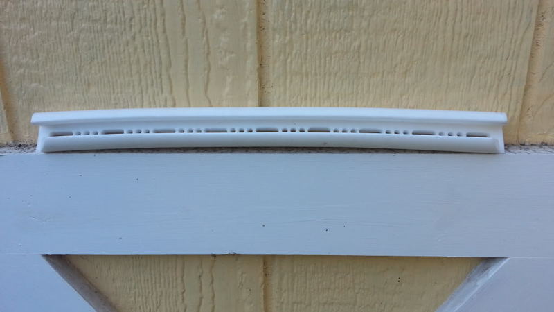

Do real american made Green Glides do this?

The bowing in the glide in the picture is because the Teflon was not properly annealed when it was manufactured. It looks fine until you try to machine it, then it bows like crazy. Most likely it was either recycled Teflon or manufactured at a plant that is not strict with proper annealing. There is only one Teflon manufacturer I will use just because of this problem.
Take care,
Lisa

Hate to tell you this.....but my holed glide came from Green glides and it has done exactly the same thing....it has warped so bad that the center does not want to touch the carpet..........aside from one banana glide I bought years ago and a set of RX glides..........everything else has came from Green Glides....and knowing Lisa...I am sure she has the records to show it....with that being said...it is not a big deal for me to worry about....because that particular wand and glide I only use on the thicker pile carpet..if I was using it on Berbers..or CGD...then it would be another story............

Annealing is heating the freshly extruded rod and then cooling it slowly to relieve the internal stress. If not done properly, when you machine the rod, it bows. This is not a factor for many Teflon products like washers and bearings and seals, but for our application it is huge. Teflon sourced from factories other than one (that I'm aware of) are not consistent with their annealing and you may get a good stick, you may get a bad one. You never know because you can't tell by looking. With virgin Teflon rod as expensive as it is, it's a risk we learned early on not to take.
Jim, give me a yell and I will be glad to warranty it. They can warp from being removed and re-installed, especially the Prochems because they are so freaking hard to remove.
Call me tomorrow when you have a chance and we'll get you a new one.
